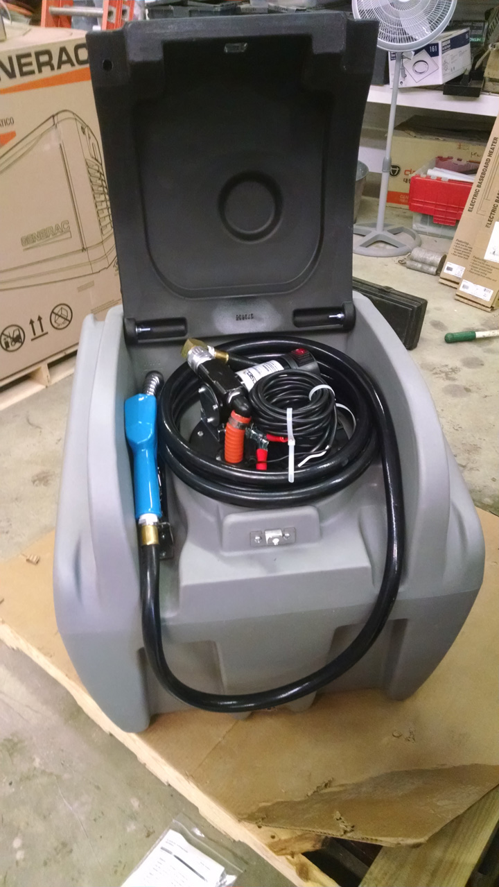

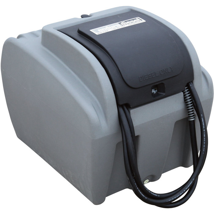

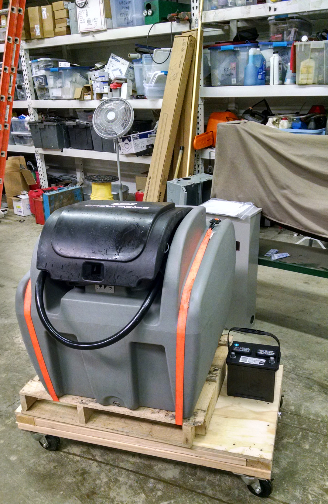

get one of these...not only will it make your life easier, you cant possible use wrong fuel. fule 2.jpg fuel 1.jpg 38118_700x700.jpg
