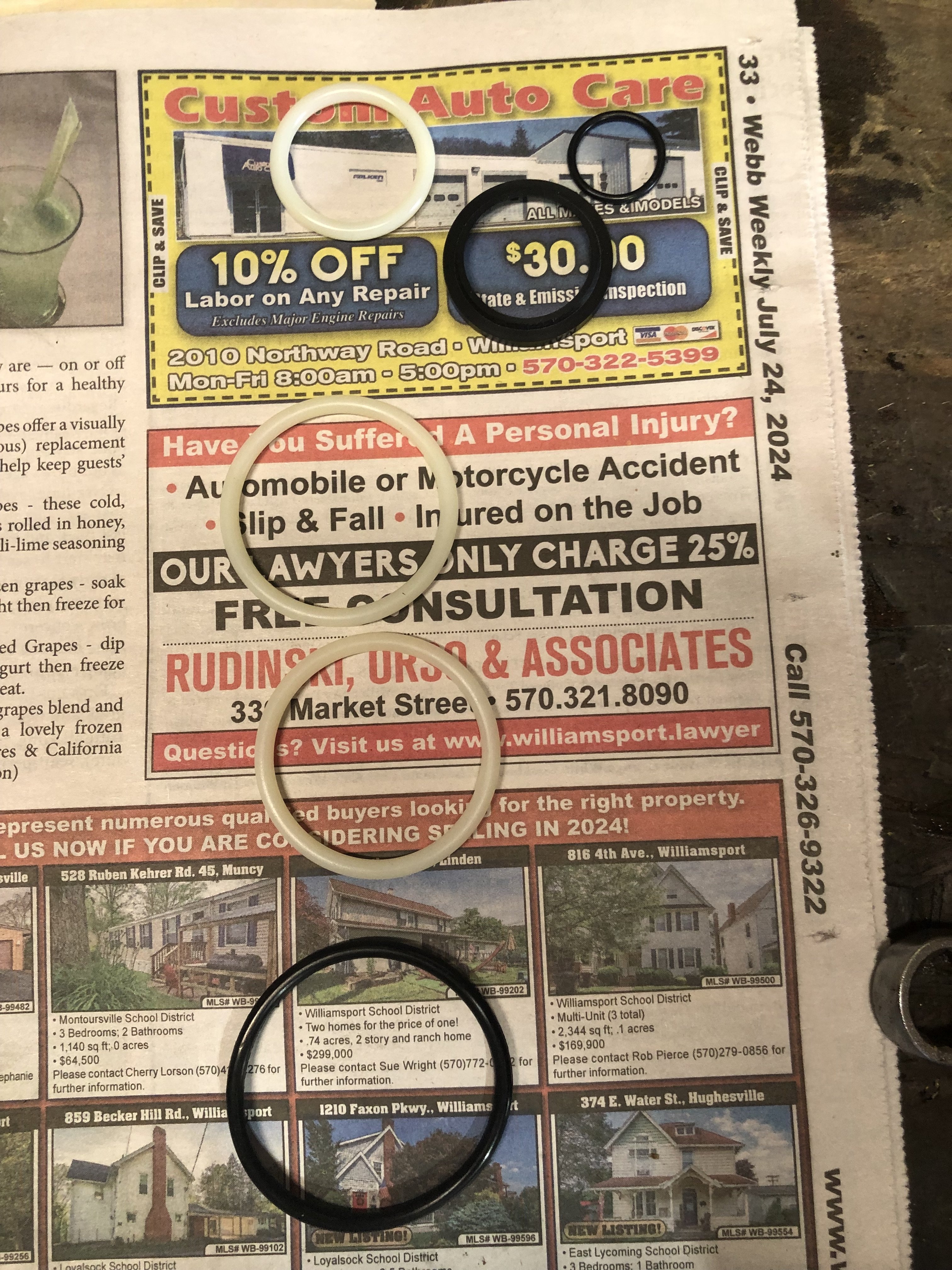

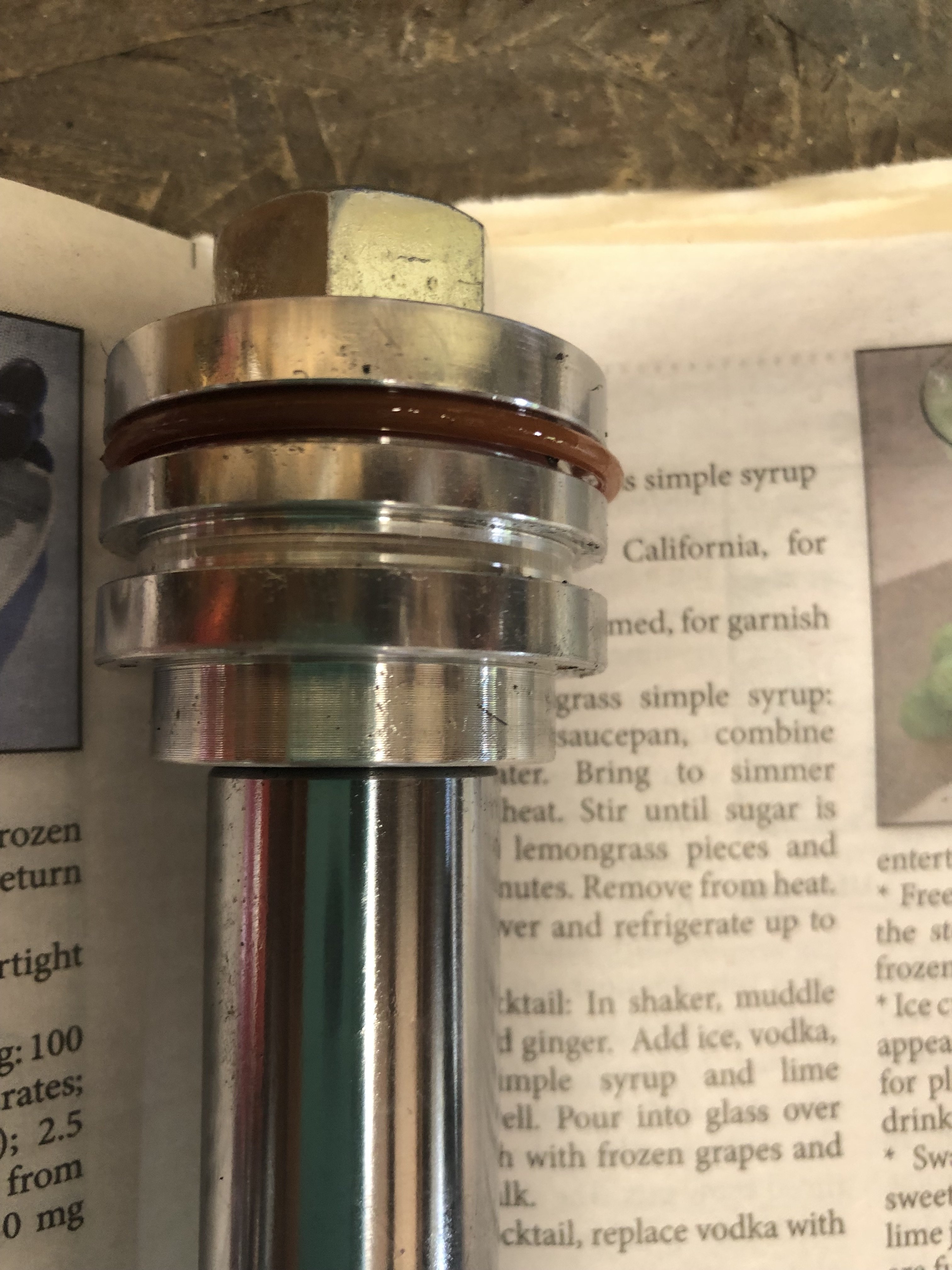

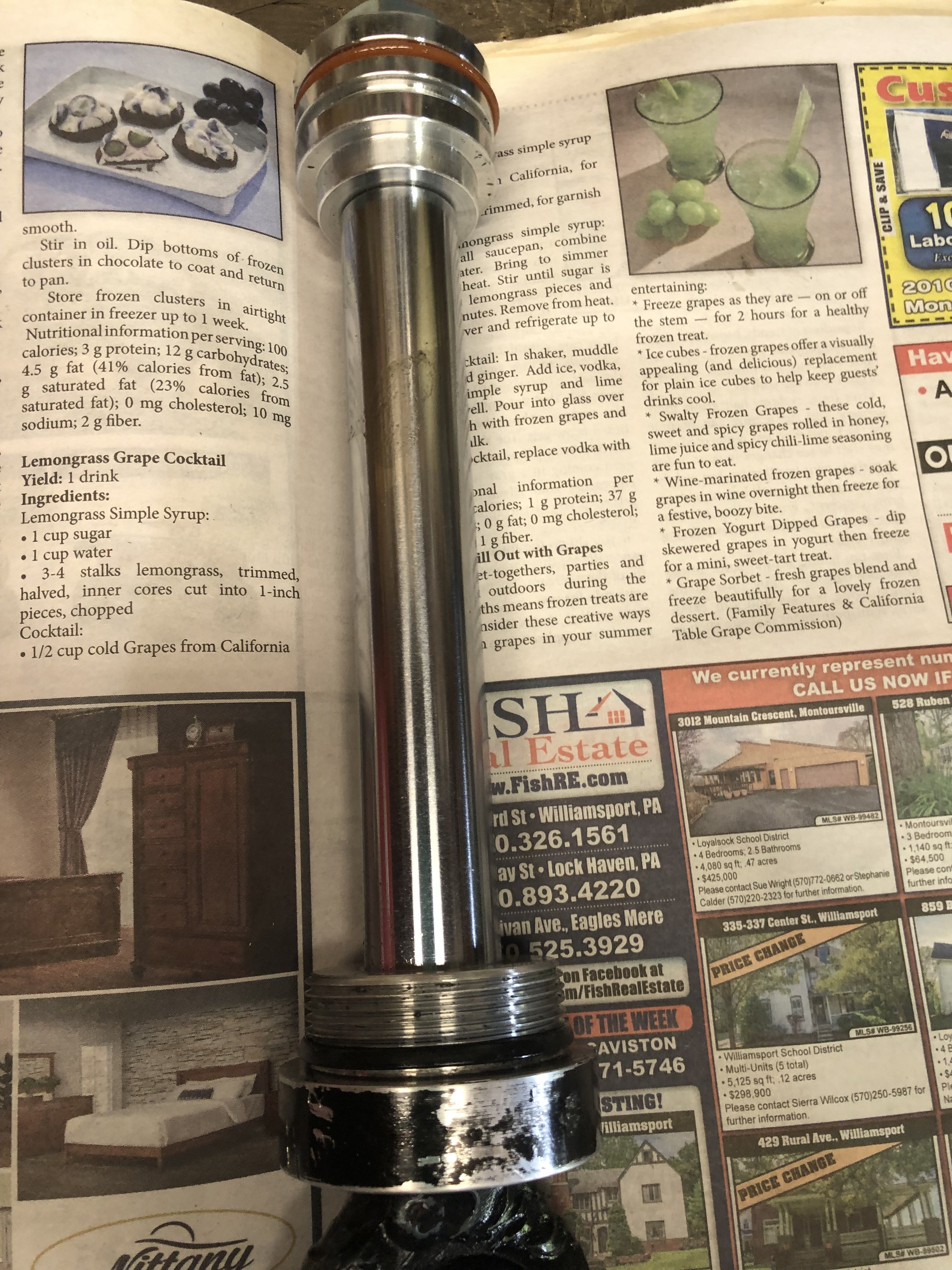

So, I got the seal kit. Got the cylinder out of the tractor(that was a bit tricky in itself), unscrewed the one end and thought I had drained the cylinder. Was not prepared for the gush of oil when I removed the bottom connection. Anyways, attached are some pics. Except for the black seal, none of the others match color. As you can see there is one orange seal up toward the nut(this does not need to be taken off, right?) and it appears another one is also supposed to be under it? The seal kit looks to have some extras
, assuming they don't get installed?
I'm guessing I should refill the cylinder with oil before screwing the end on? Also, will it be necessary to bleed the hydraulics when done? The cylinder base looks to be a bit cruddy at the bottom, just use kerosene to rinse it out?

I would call PT and get the correct locations for each O ring. And since you had internal leakage in the cylinder, the one under the nut, if it leaked, would cause... a leak?

Yep, will be calling in the morning. Looks like there were 2 O rings under the nut and one was completely disintegrated, it's a wonder it worked at all.
/ Increasingly slow steering response on my 422 #10
It either got disintegrated when it was assembled or pressure blew through it, and that could cause a steering issue

Well, after a couple of "please help!" calls to Terry at PT...steering is back to normal. Turns out the 3 "extra" O rings would have been needed if I had leaks, which I did not. Glad for that because I'm not sure I could have removed that nut on the ram. Only needed the 2 O rings that are below that nut and after some frustration I got both in. I made a helluva a mess in this project but now doing my happy dance.
