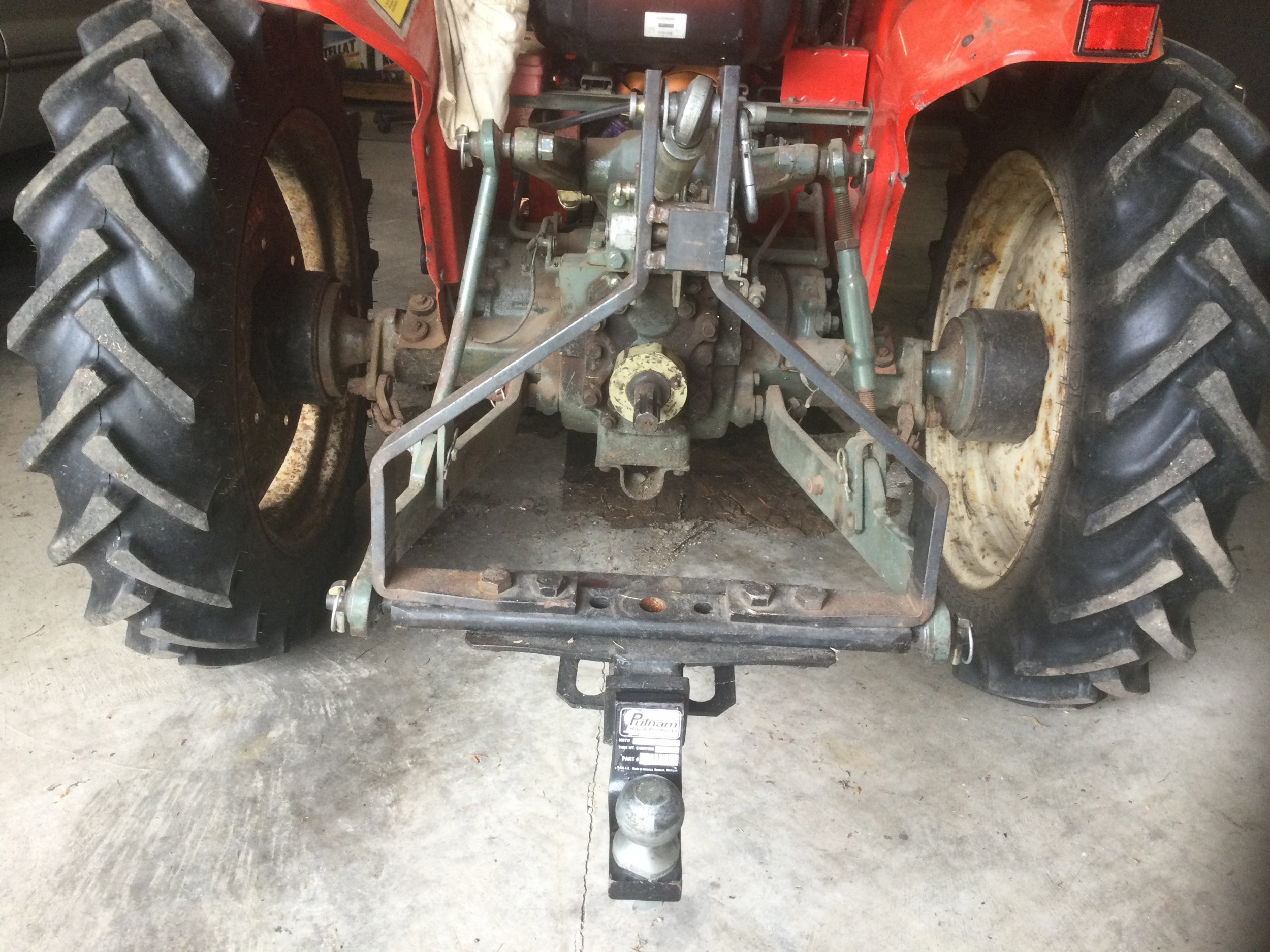

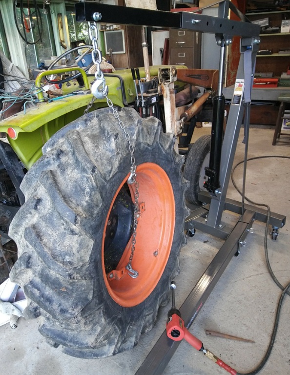

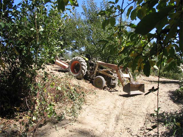

Reversible wheels on some of the smaller Yanmars, was one of the minor differences between gray (Japan-market) Yanmars and their versions built for the US market.
A prior owner put oversize Kubota rear rims/tires on my YM240 (YM2000). The original Yanmar dished centers match to the Kubota rims.
(Just a note, I don't think Kubota centers have the same bolt spacing as Yanmar axle hubs).
This extra width improves safety on the slopes in my orchard. I also bought the ROPS as soon as Hoye offered them.

Yeah my slopes are a ***** here too, been trying to flail all the perimeter brush for fire safety and it can be a bit unnerving on that terrain. Like the use of the hoist for the wheel removal so I'll break mine out.
