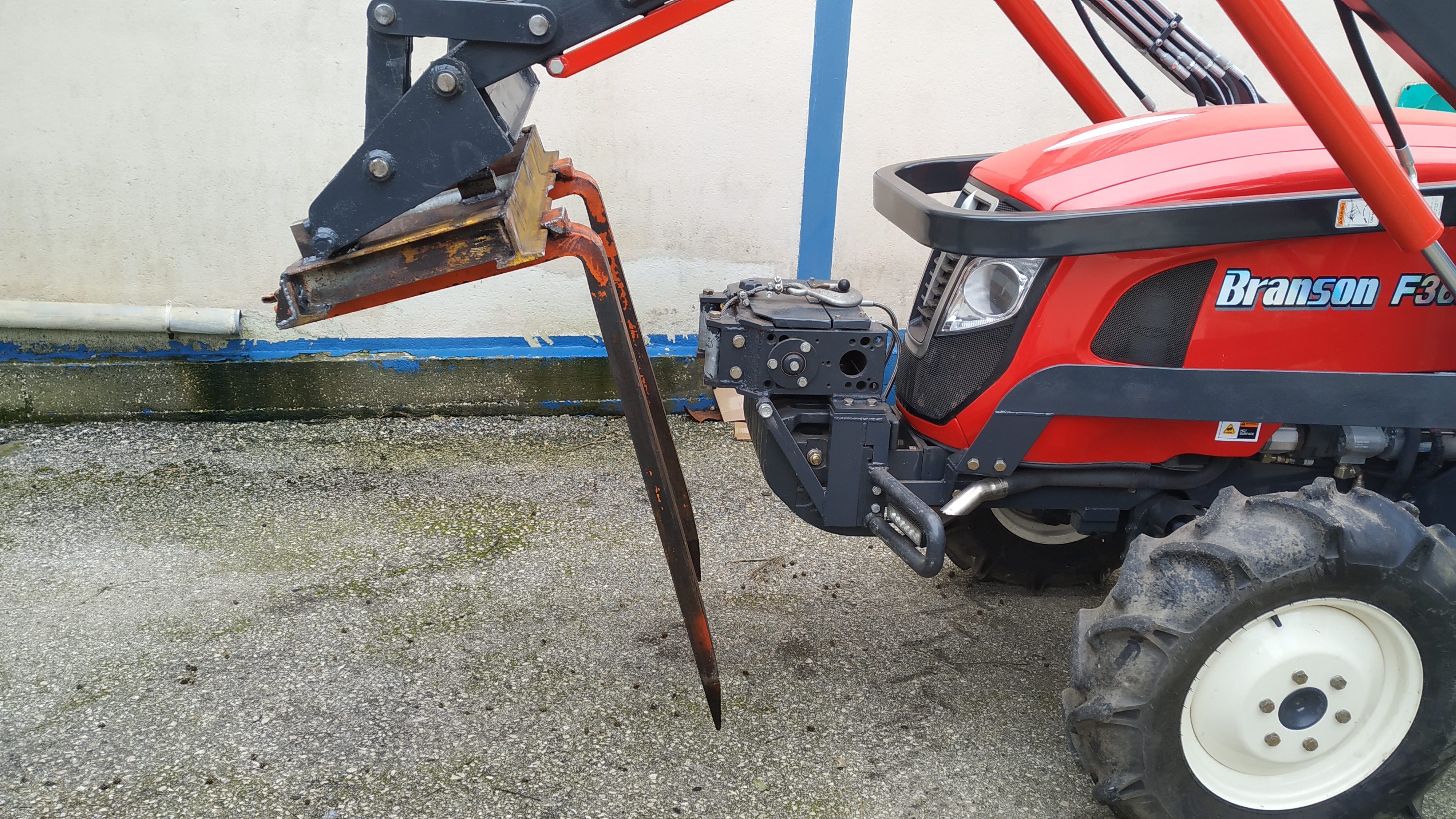

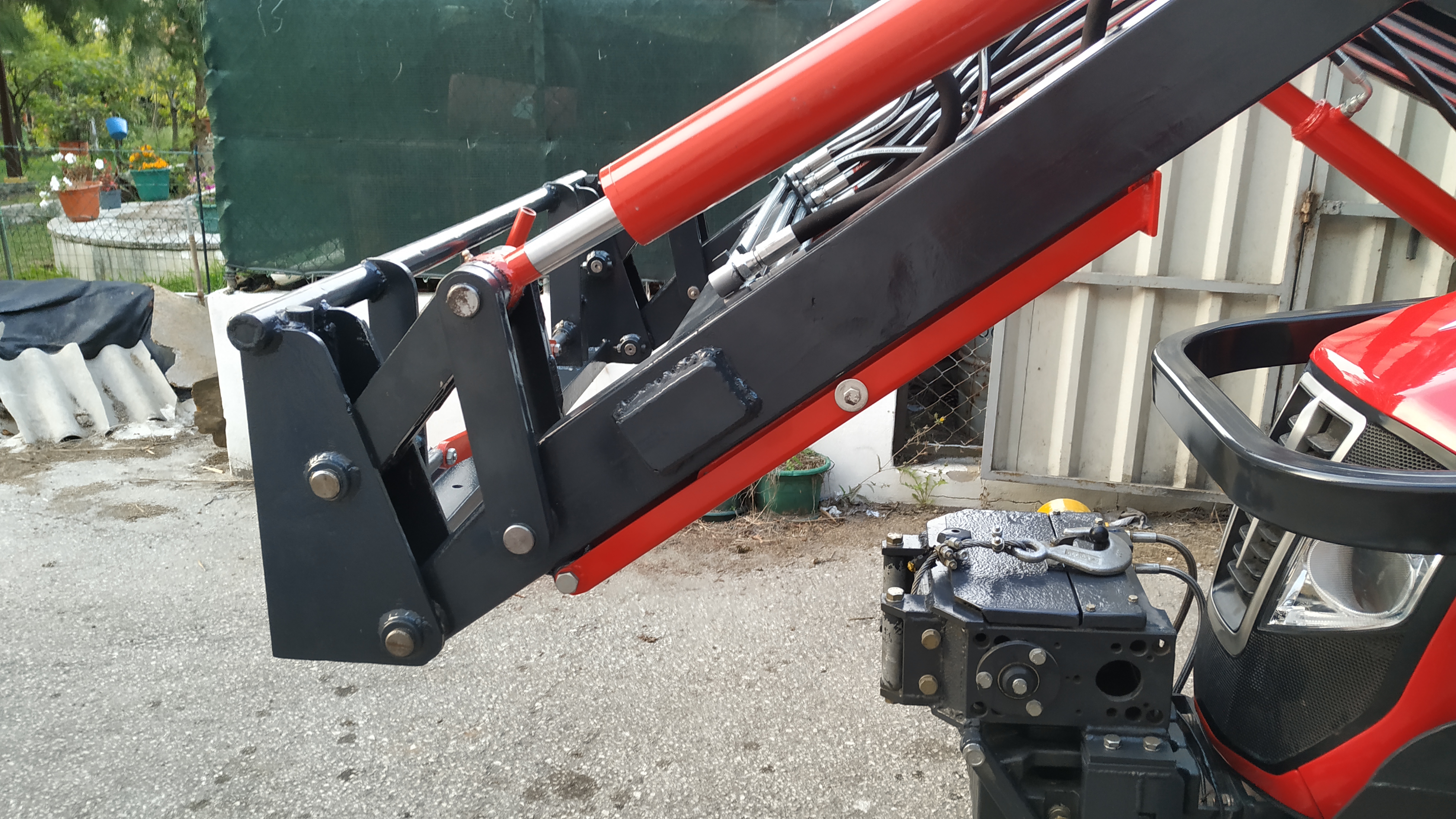

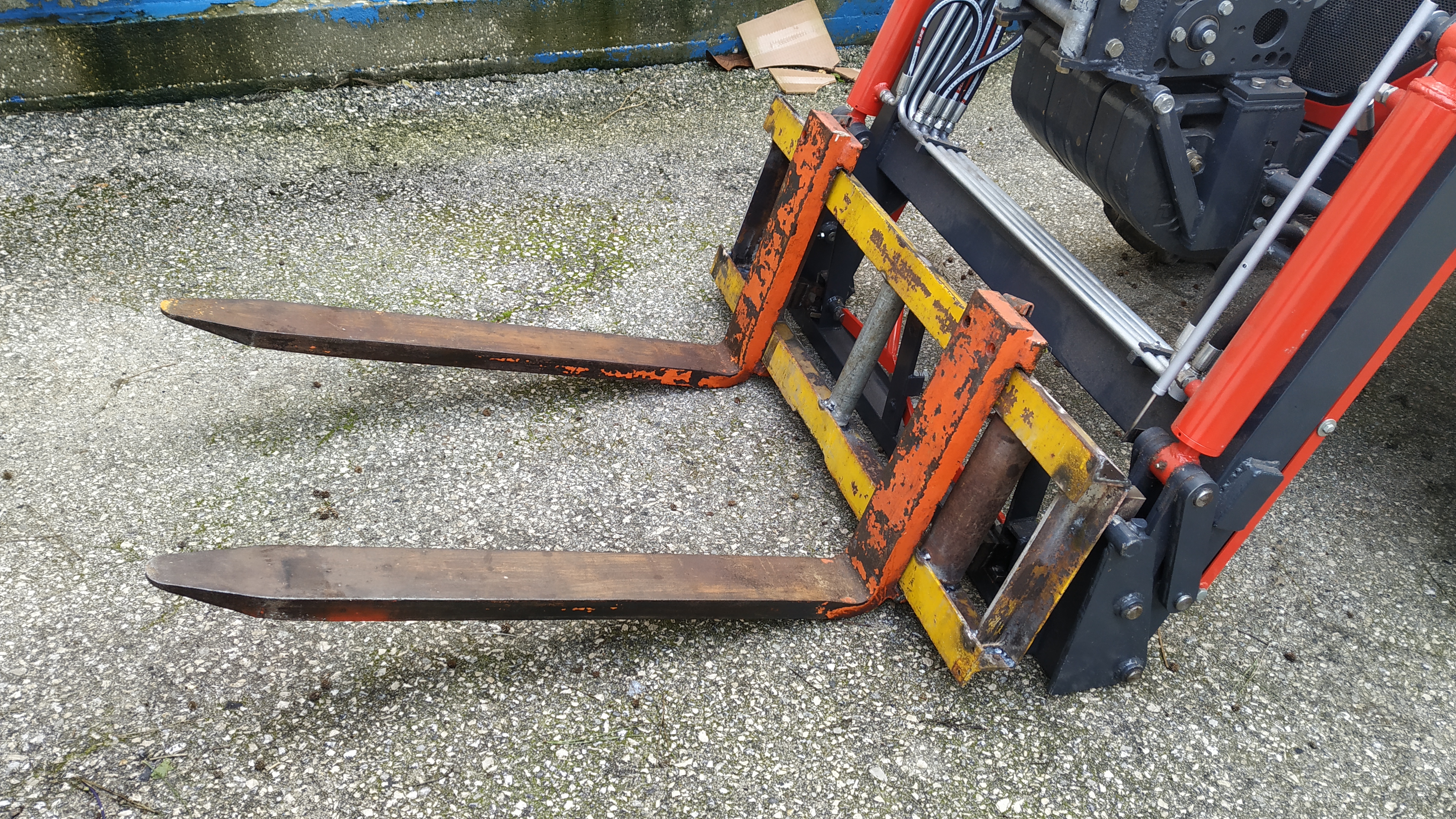

If you really want to, you could also modify the loader. The way they mounted the curl cylinders, makes it actually easier to modify the position. It could probably help with other attachments as well but it's a bit more complex to do.
This is what I did on my homemade loader and it's used in most loaders. This linkage allows for more curl back and dump angles without compromising the force of the cylinders. To get this the way I wanted, I played with CAD programs a lot and made lots of changes till I was happy. This can also be done with a simple cardboard or MDF or something like that.
Playing with this linkage exactly right, you can retain the same cylinders without modifications.

Maybe make a Vee from male/female quick hitch plates at the right angle. Might even make it hinged. A rigid Vee would limit articulation in the opposite direction.
Or, make triangular extensions for your existing quick hitch mount to give you a second cylinder rod end position.

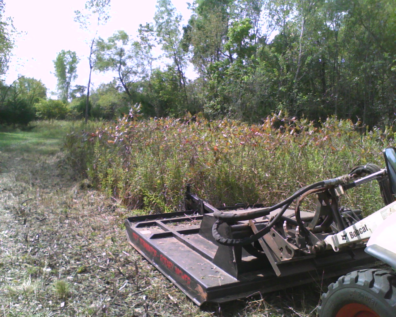

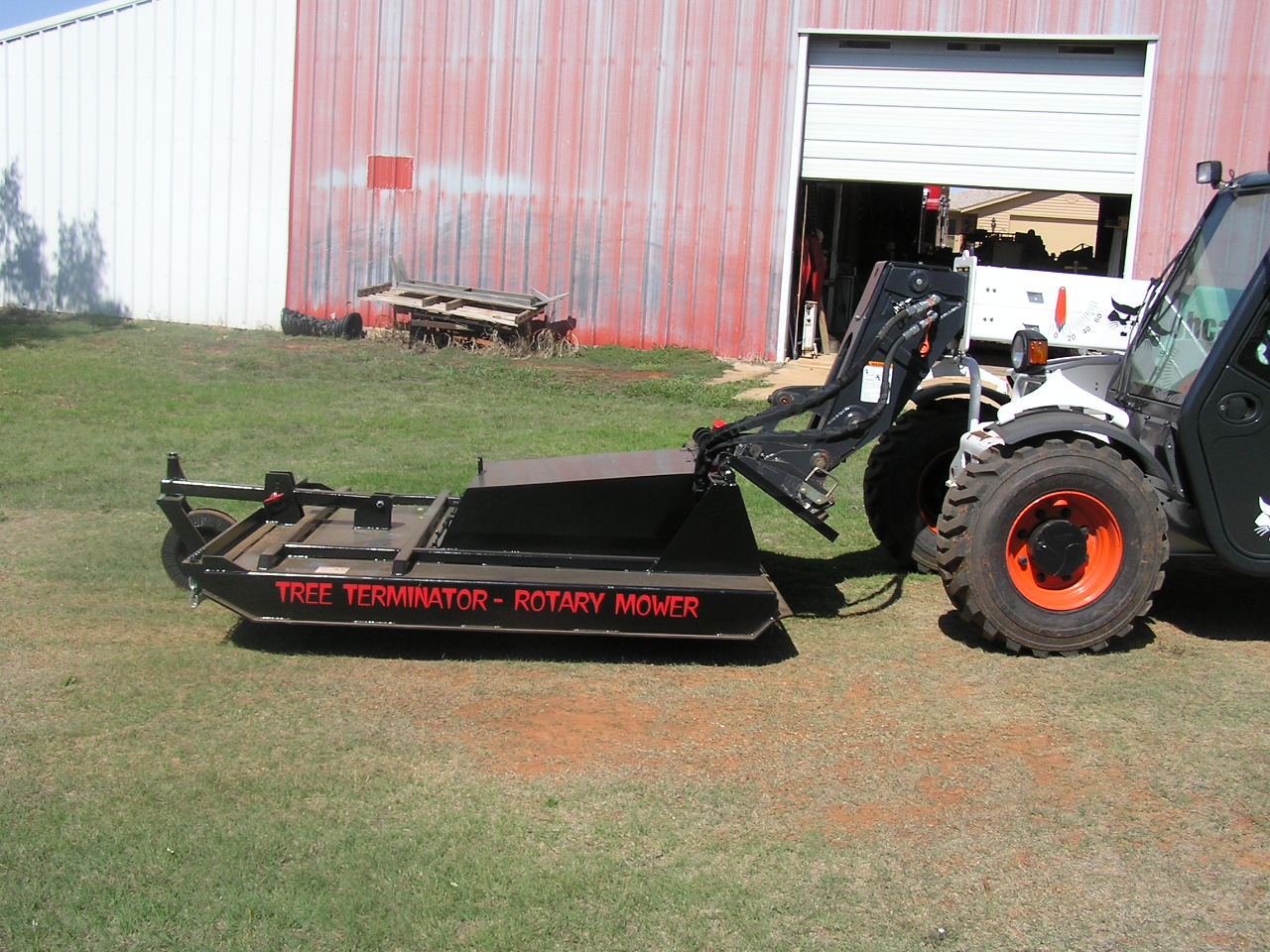

Sure. The implement you see in the picture is a Trailblazer TB-1 mower. Here's a link: TB-ONE Cutter
This mower can cut in many different positions. To change the configuration, you need to roll your dump forward until the mower is hanging straight down to take any binding off the unit so it will swing easily. There are videos on the site linked above that show the reconfiguration. Anyway, since my FEL won't dump to horizontal, I can't take the bind out, so I have to use a gantry crane to lift the unit to put it in different configs. This does take some effort and time. I'm trying to eliminate this.
Does this make sense?
Hmmm, I know I live a sheltered life but I have never seen that before. I get it now.

Check and see how much room is between the cyls. and the boom when the cyls are all the way in. If you have some room just drop the top pin holes down. BUT make sure the cyls. don't hit the boom, if they do you well bend the rod.

Could you hang a counter weight on the mower while you change the config. Make the counter weight so that the mower hangs at what ever angle works. Just an off the wall idea :confused3:
