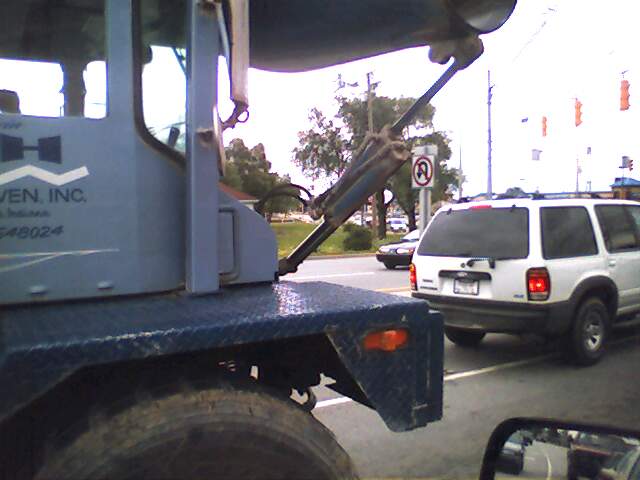

I had no idea where to post this so here it is. It's one of those things I've undoubtedly seen hundreds of times but never looked at until recently.
I've seen a lot of posts here about the need or desire to have a greater 'throw' on a hydraulic cylinder than is possible (like 12" retracted and 32" extended). Well, here's a way to accomplish that kind of feat.

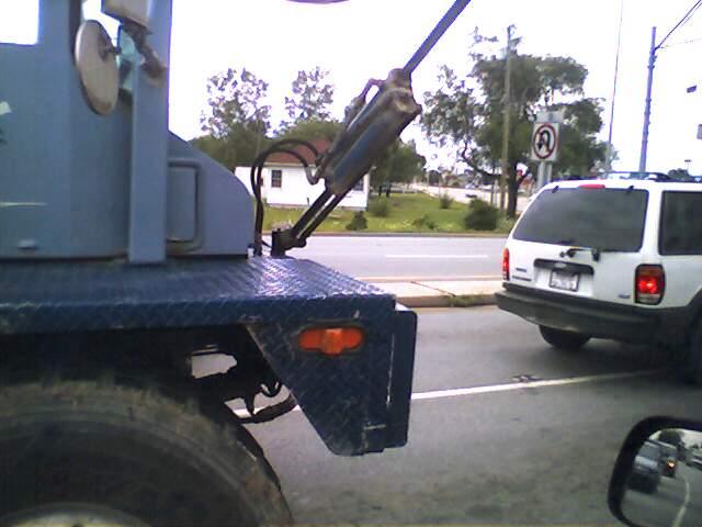

It appears to be a real simple solution. It's just two hydraulic cylinders pointing in opposite directions plumbed to open together and close together.

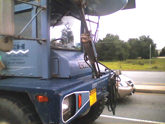

Here is one last picture taken in traffic. For all I know this is old news to everyone but me. Nonetheless, I thought it was a neat idea. /forums/images/graemlins/smile.gif

interesting concept, raymond forklifts use single acting cylinders setup the same way, welded beside each other to get the lift range, but i havent seen double acting cylinders setup that way before, i will have to keep that in mind next time i am making somethin hydraulic, thanks gary

what you are refering to is known as a telescoping cylinder, they are generaly only single acting, the setup garry is showing is neat cause it can be made double acting
