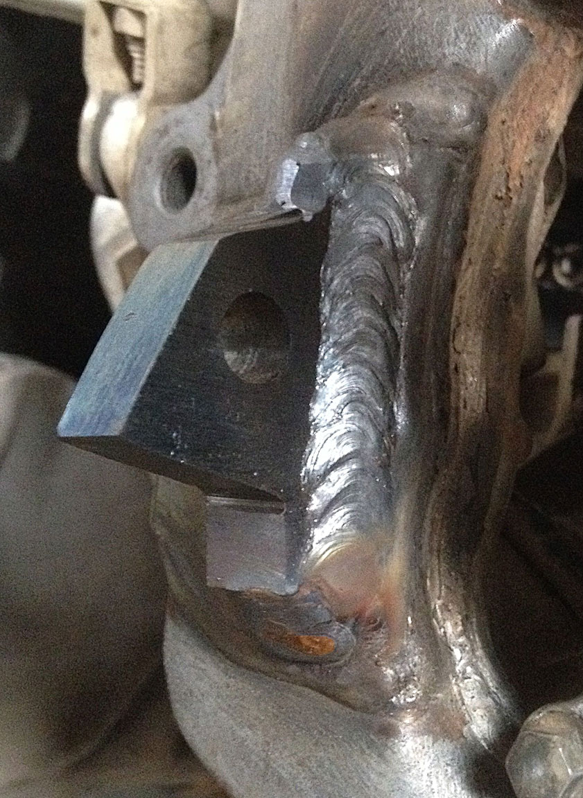

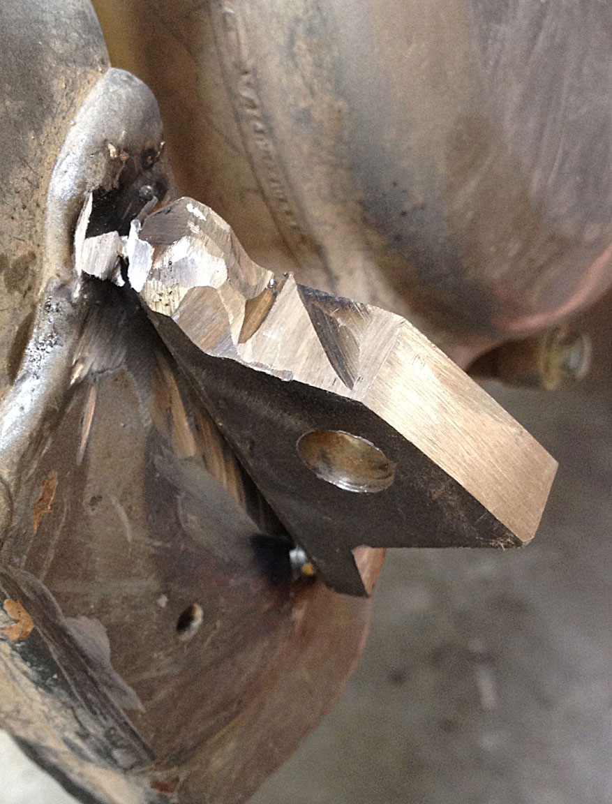

This footpeg bracket (from earlier post) is 1/2" steel, welded with 120v. It worked OK because the bracket doesnt have a lot of mass. The owner was thrilled.
Sorry Mudd, your suggestion doesn't "fit" the program. :laughing: actually I was referring to welding techniques, not the philosophy part.
Actually its fits the program very well. To learn techniques, you look, listen and learn. As this thread has progressed, you have continued to refuse to listen to what other more knowledgeable people have had to say. You inject your thoughts and opinions as if they are fact without reguard to what other more seasoned professionals have had to say. I am only suggesting that if you really want to learn more, you first learn to listen to the pros on the subject. They have most likely already been thru the trail and error parts of leaning their craft and for the most part seem willing to pass along their experiences to those that are willing to listen. I think you want to pass along advice and experiences that you have learned over the years, but the problem is your advice is mostly bad, and inaccurate, and potentially dangerous. Not saying you have bad intentions, or trying to deliberately pass along bad advice, its just that you dont know any better. Advice such as the foot peg examples in your post. Did it work, was the customer happy, is there a reason why some countries are outlawing such repairs. The answer to all those questions is most likely yes. There is a reason some countries are outlawing such procedures, its unsafe. There is also a reason why the customer is happy, and its because they simply dont know any better or the risk they are taking. Did it work, yep, only until it fails.
