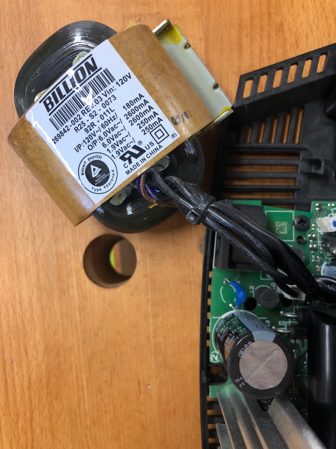

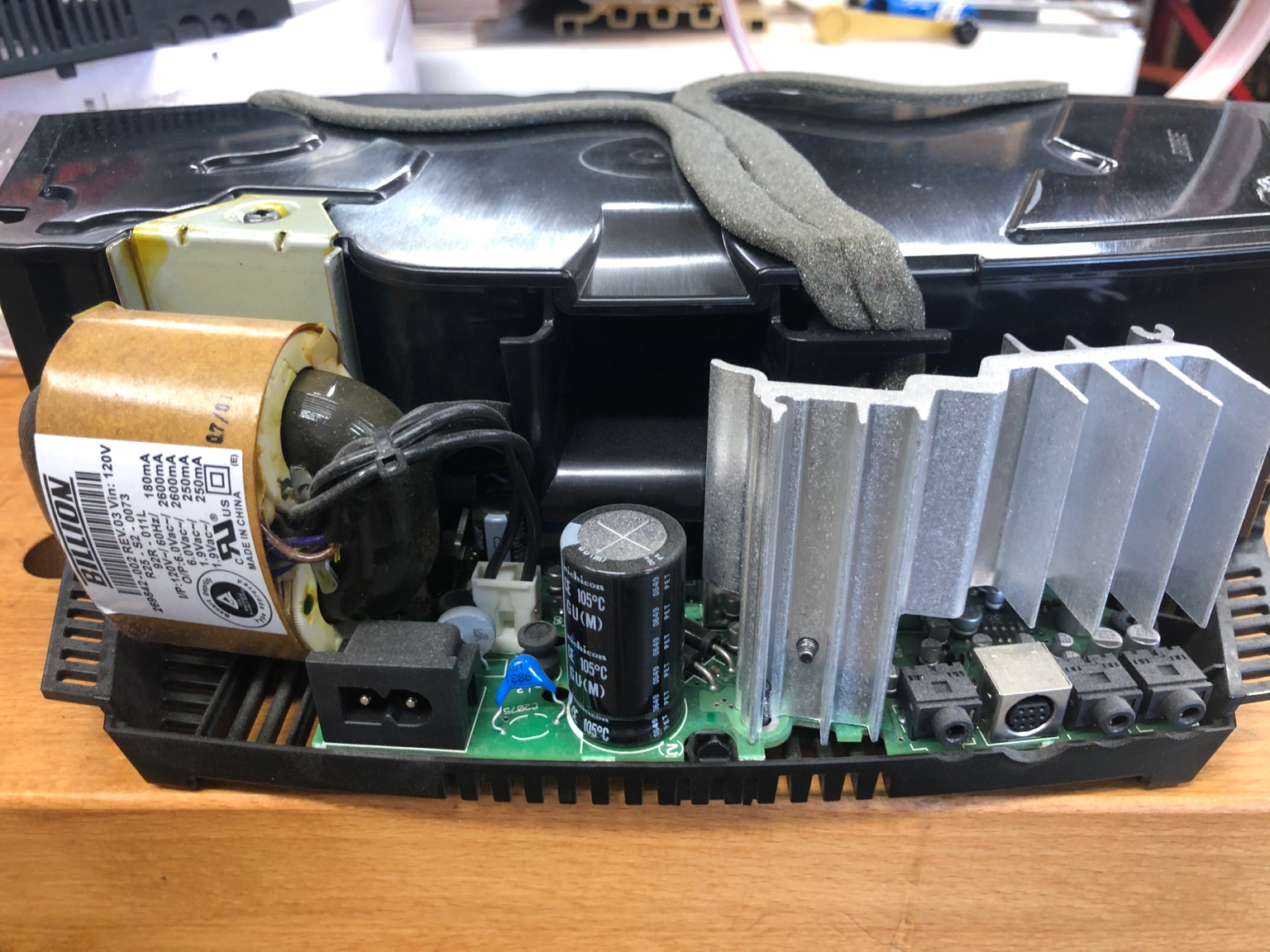

So is this the doohickey I'm supposed to wrap somehow?
/ Improving AM radio reception? #26
Unfortunately no. That is the power transformer for the power supply. i don't see the loop stick antenna, and it may not have one. I am seeing very little radio there in these photo's . Does the circuit board go under that big plastic housing ?
Yes, and I can't figure how to get to the rest of the board without damaging it.

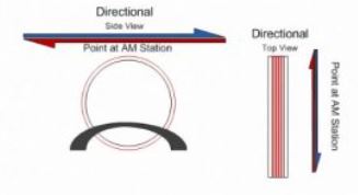

- I have had amazing success with tuned loop antennas. They're almost magical. If you look on Youtube, you'll see some demonstrations. Build your own or, for about $30, purchase one (which you already have). In your case, just set it near your radio (don't plug it in) and adjust it's position (relative to the radio and the world). Then tune the capacitor for best reception. You will notice a difference....unless it is broken that is.

You should see a huge increase in even static when you position the tuned loop near (~6" from) the radio. No need to connect with a wire. Tune the capacitor for maximum static. Then move the loop around (perhaps reposition the radio some too) for maximum signal. Might take a bit of back and forth, but I would be surprised if it didn't significantly increase the signal strength of the station you are trying to listen too. Of course, there has to be some signal to start with.
