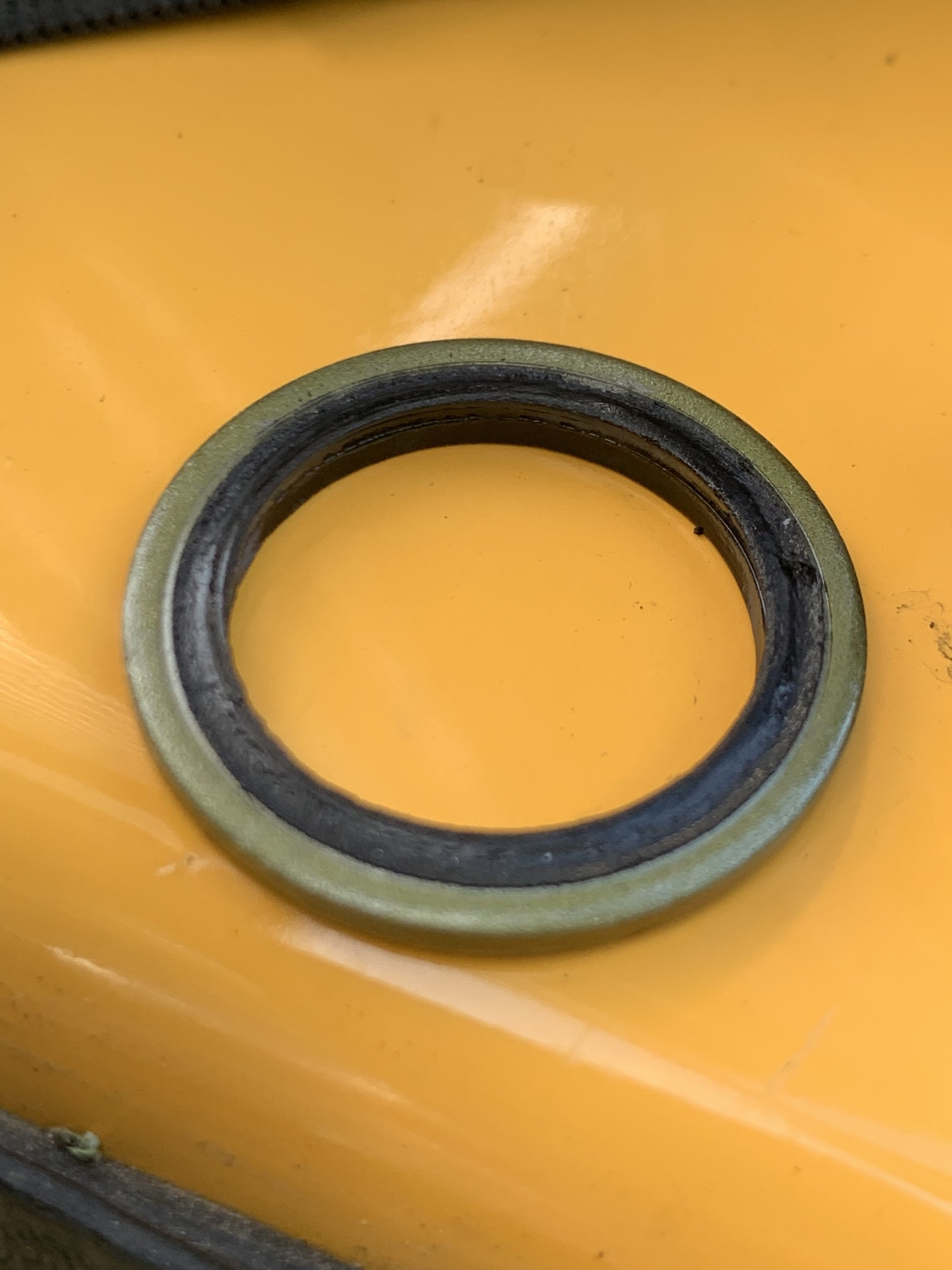

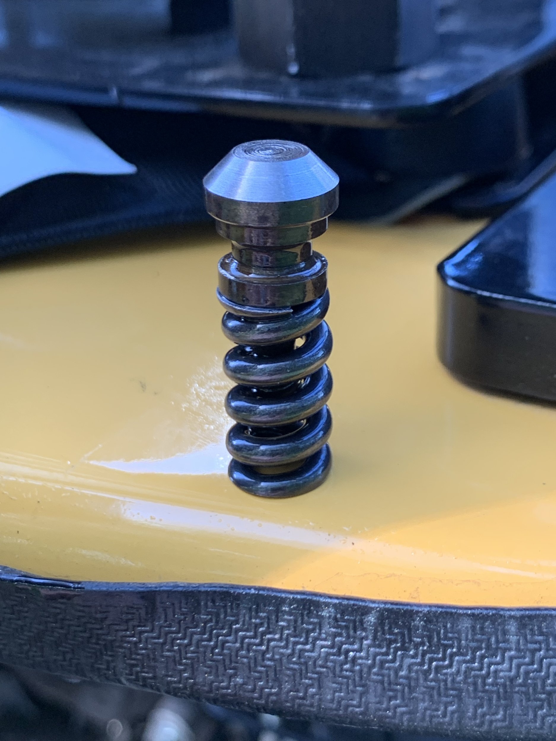

I suspect that you can turn that thing that looks like a plug, and it will adjust the pressure valve between the 2 sections.
I see the O-ring. Does it look OK?
Next thing to do is to remove the "plug". Before you do, you want to make sure that you can return the plug to the same spring pre-load setting. Do this by either measuring how far it sticks out from the pump body, or screwing it in all the way then counting how many turns that requires.
Be careful about removing it, since there may be an unrestrained spring behind the plug.
I measured and removed the plug which revealed the suspected spring. The o-ring looks fine to me.
Was the spring under a pre-load compression from the plug?
It may be that your leak is between the sections of the pump, as feared.
   / Importing and modifying a new mini excavator from China #596
Yes, the spring is under compression.

If you need to buy a new one, that's a called a dowty washer. Even slightly damaged, they usually still seal pretty well.
That's what's used to seal most BSPP and metric fittings to valve or cylinders connections.
   / Importing and modifying a new mini excavator from China #598
It's unlikely you will find torque specs for the bolts holding the sections together. When you split the sections, use a torque wrench when you loosen each bolt and choose the middle of the road break point as a guide when reassembly. I would be willing to bet that each bolt has a different break point.
If you need to ,keep increasing torque until you've reached the highest bolt torque.

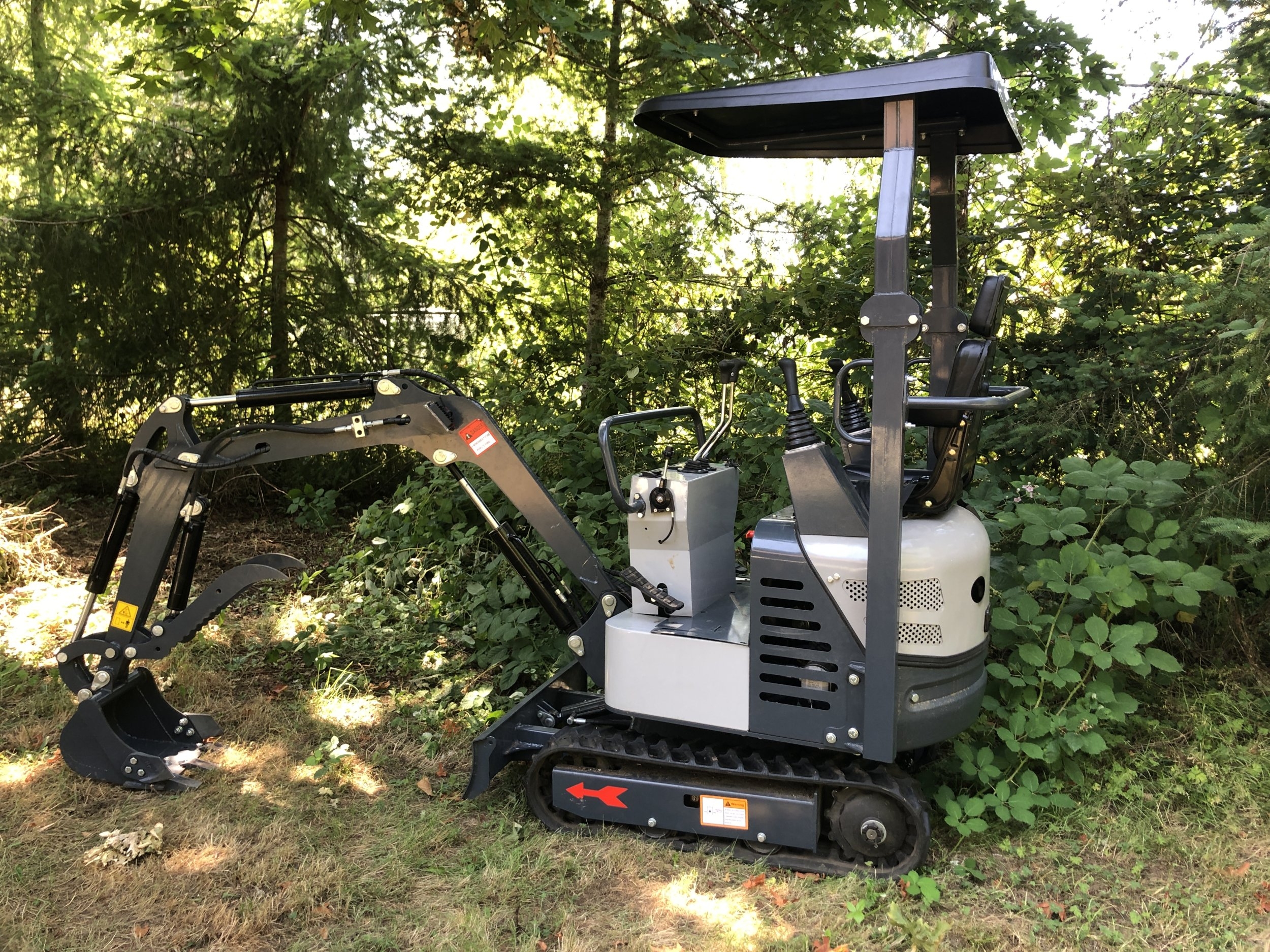

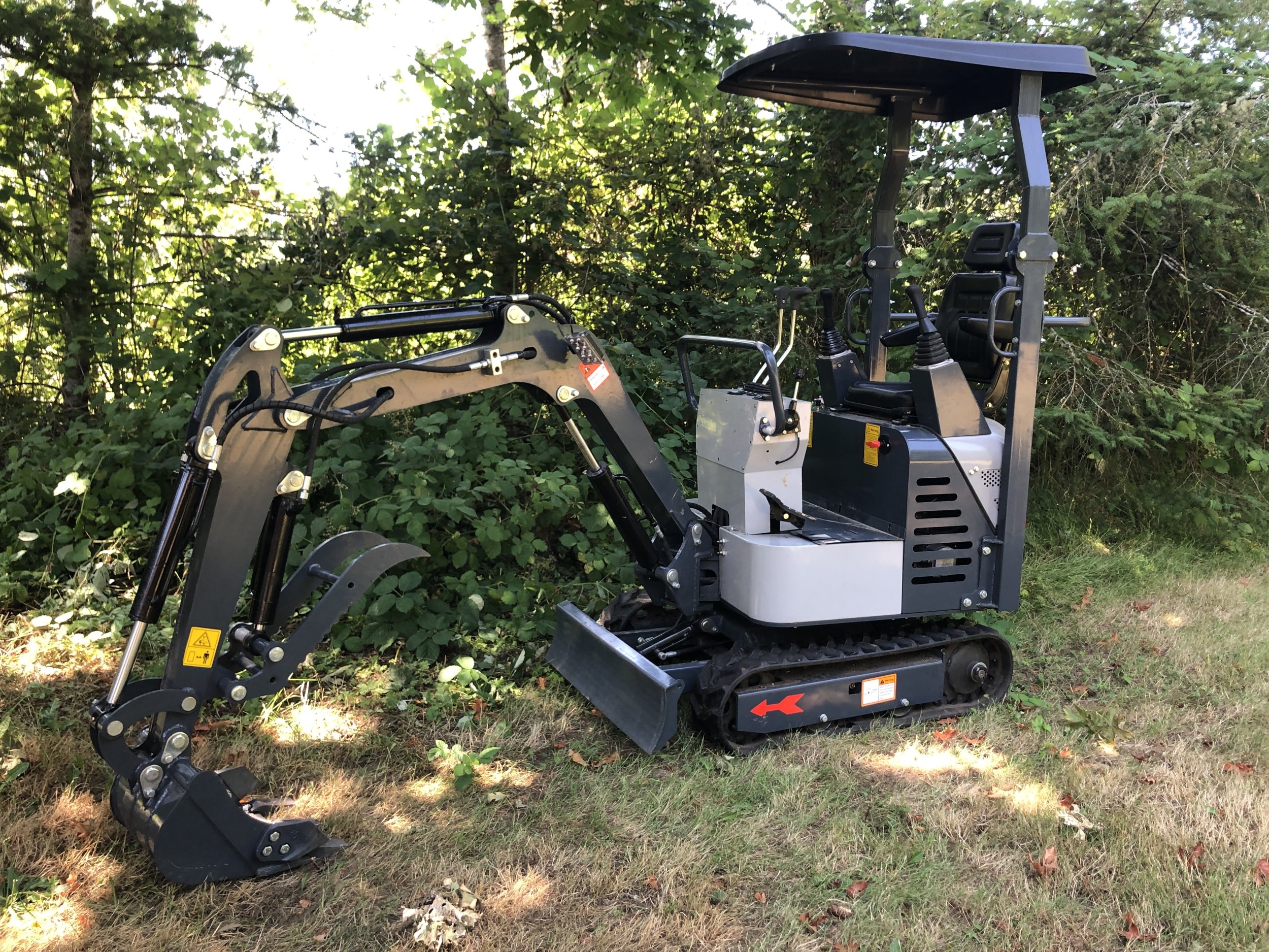

Hey all.
I found this thread while looking for a generic Imported Mini info, and I appreciate Dave for starting it.
I purchased my 1 Ton Excavator a couple weeks ago (July 2023) in Surrey BC. I spent a fair bit of time considering importing myself directly from China but, honestly, after calculating shipping, warehousing and import fees that I knew of, the price was getting awfully close to what was being offered by a couple of the importers/resellers. (YES! One can save money DIYing the import, but it is not how I wanted to spend my time right now).
I chose to purchase from Capital Automotive Equipment Ltd (CAEL) based on the machine availability and the brief conversations I had with staff there.
I went in thinking of a 800kg or 1000kg unit. 800kg machines were out of stock and not expected for a while but they have many 1000kg units in. Most models are plumbed for aux/thumb but come with a mechanical thumb or none at all. I planned to add the necessary (to me) Hydraulic thumb myself but when I got to the yard I up-sold myself to the unit in the pictures attached here.
The machine is 1000kg with Thumb and Side-Swing. It uses pilot (servo) control for main hydraulics, direct foot control for dozer and thumb, and hand lever control for travel. A joystick button (the horn button!) selects the side swing control over the main swing. There is a fan-cooled hydraulic cooler installed, but no filter yet. The engine is the expected 420cc B&S 250000.
I’ll link to the product page HERE. Note that the web page incorrectly lists the machine as having “John Deer Control” but that is because they believe that only JD has pilot controlled hydraulics! The machine controls are SAE. I tried to explain SAE vs ISO to the manager in Surrey but quickly gave up as it was not important to me.
I have spent a high percentage of my time with this machine so far fixing the deficiencies I found or already knew of. I do feel like I got the value I expected (I went in knowing full well what I was buying) but it is a close race ;)
I’ll post further details of what I have found and done so far and a full review of this machine if there is interest. I feel like there are quite a few of these being sold right now in both western Canada and back east.
Congrats on the new machine, Aaron. Thx for posting.
Hopefully CAEL in Ontario will step up and provide parts and technical help. Do they provide any docs, esp for the hyd system? Does it look like the hyd system on the Diggit EM15 I posted above (post #540)?
Did the company set the relief pressure correctly, as well as provide a spring-to-center AUX control?
The return filter mod is not too bad, and much more important than the cooler. Nice to have the cooler, too, and hopefully, an hour meter.
There are hundreds of similar machines in the US and Canada now. I just saw my first used one for sale locally ($7500) with the Kubota D722 engine, but direct controls.
