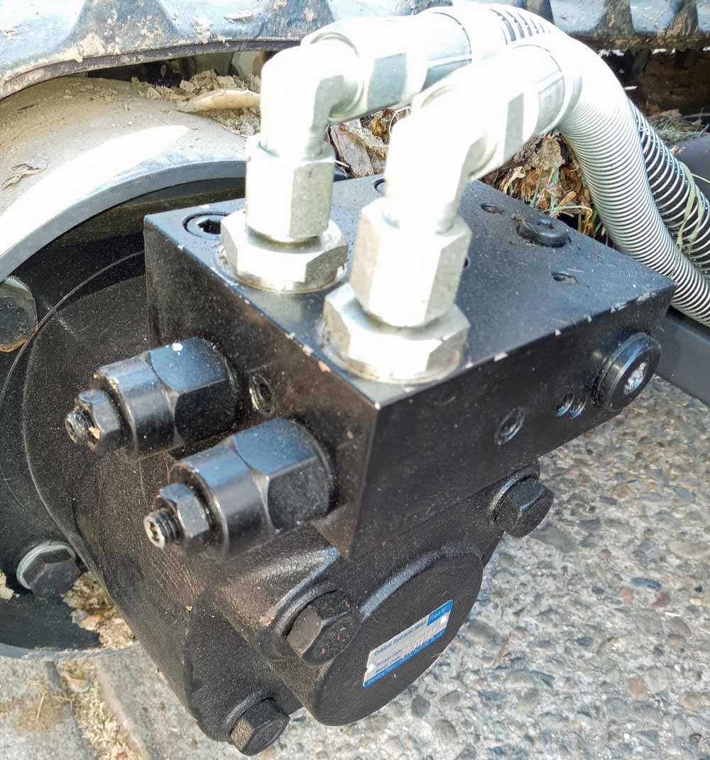

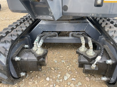

Ok a Question What is the 3rd line to 1 Drive Motor?
   / Importing and modifying a new mini excavator from China #574
If you look closely there is a 3rd line on both motors. It's probably a case relief line. If the output shaft seal starts leaking there is a way for the hydraulic oil to drain back to the resevoir instead of pressurizing the casting.
#575
Yeah, it is probably a "case drain", as PMS says.
I have not seen that connection used on any of these units. I have noted that there are more than one unused ports on many (most?) of the wheel motors. On the one I have seen with the wheel brakes (HeChuang), there is a separate external attachment and 2 RVs, but no case drain.
Did you trace the extra hoses to see if they connect right to the hyd tank?

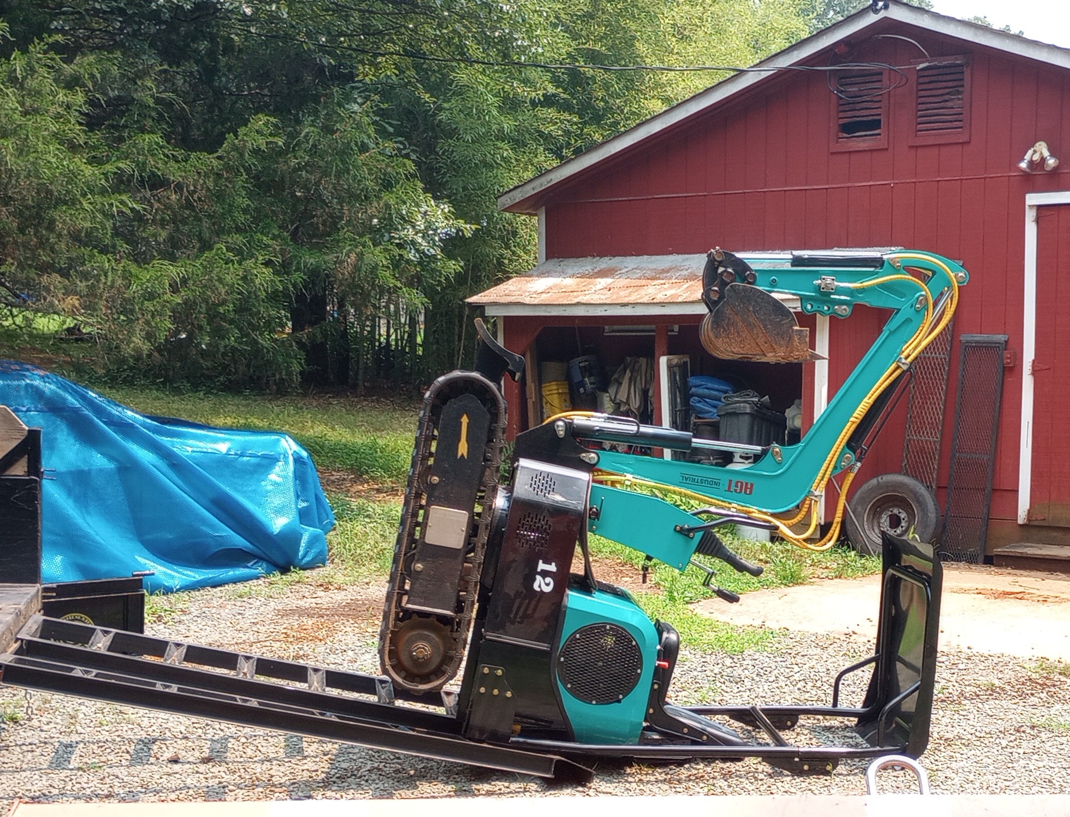

I have a word of caution for anyone thinking of adding weight to the a** end of their mini. It helped a lot when digging perpendicular to the tracks.
My trailers are low and the ramp angle is shallow. I've always loaded blade and boom forward even though larger ( 3 to 6 ton) minis load a** end first.
It seems my weight addition has thrown off the CG substantially. I've had no trouble loading until the other day..... Don't know what i did different but heres the result.
Nobody hurt , but wimpy looking ROPs worked. I'll straighten the rops and sleeve it . I will be loading Butt first from now on.

gee whiz, glad no one was hurt.
   / Importing and modifying a new mini excavator from China #579
Thanks ArlyA, It was ridiculously slow motion, such that I had time to jump off and watch it turtle itself. I laughed until i realized I would have to fix something.
Wow.
Your ramp does not look that steep. I have gone up/down slopes as steep as 40%, measured. And, the guy I posted about earlier who loads his minis into a PU truck bed, about as steep. Not for the faint-of-heart.
Thx for posting. These small minis can be dangerous.
