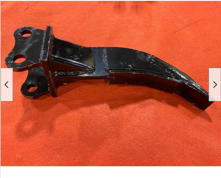

Yikes. So I have something to look forward to!! :cry: :cry: I am already backing down hills because I need an extension tube in my hyd tank so I dont cavitate. I emailed AGT a week ago. No reply other than they sent me a pic of a ripper I really like. What do you thinkView attachment 839061 of this agt ripper?
If I am not mistaken that ripper is for a much much larger excavator. AGT imports lots of things for farm and heavy equipment. The ripper that fits the pins for the 1-ton is this one. I see it is listed for $250 at FREE SHIPPING 2 Ton New Mini Excavator, EPA certified USA KUBOTA Diesel Engine | eBay

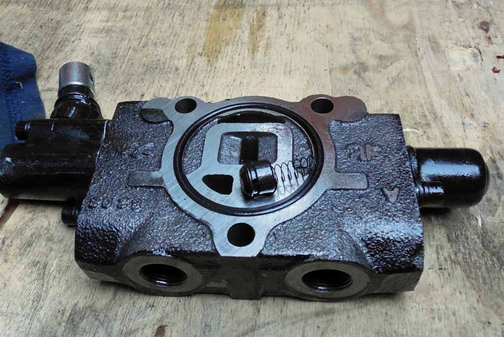

It may be possible to add another valve to the stack. I think there are 8 valves on the stack now. if you remove the 8
-12mm bolts on the access panel, you can see your stack and how much room is available.
Adding a section is doable, if you can buy one. All the sections on my valve and the spare I bought seem to be identical. I do not know of different makers of this 8-spool stack valve. The cost of my spare was $350, and I have not needed it. If adding a section, 3 new threaded rods will be needed for the additional thickness.
As for needing another spool, I would consider diverting flow from an unneeded function (bkt or blade?) first.

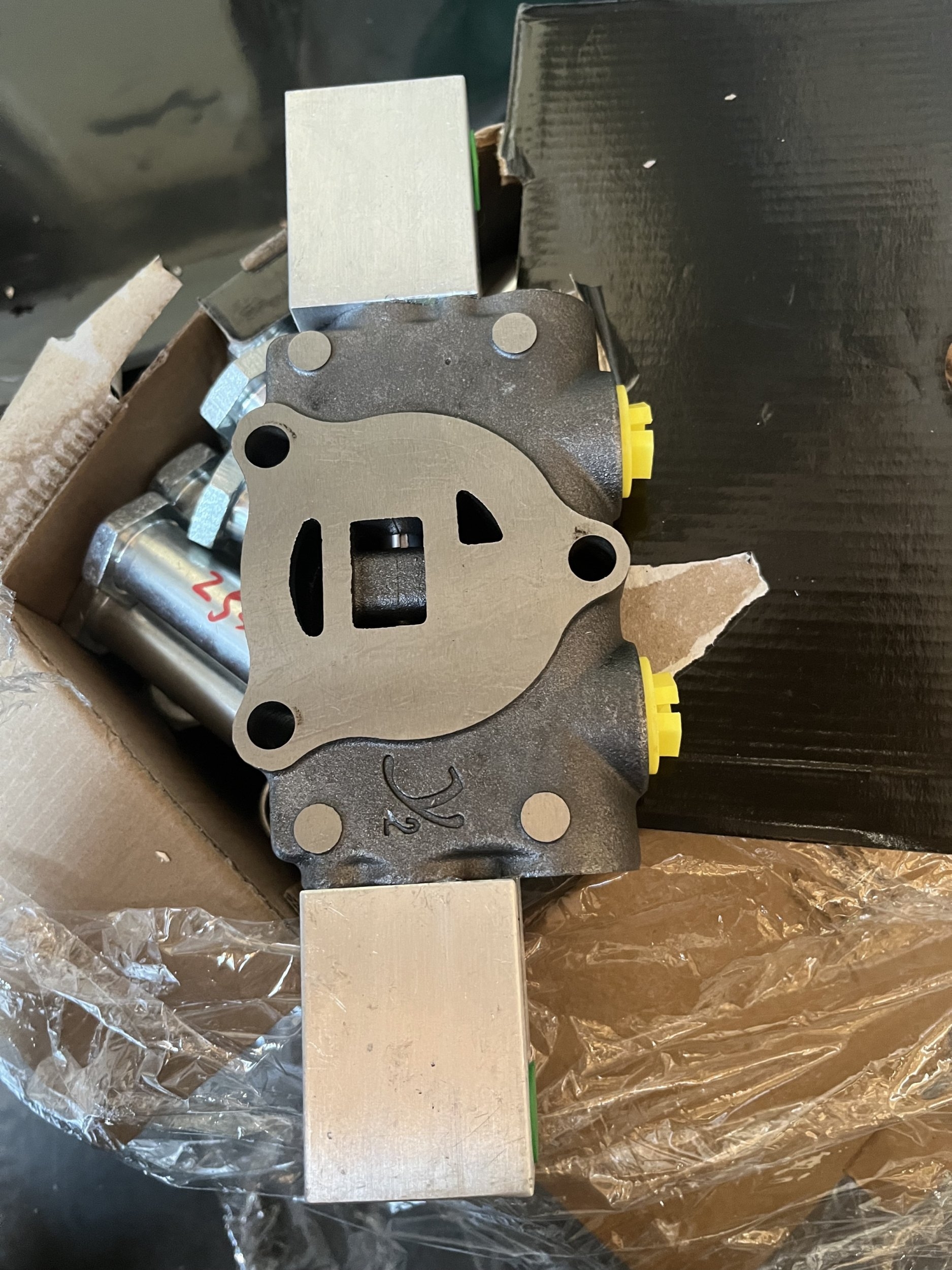

Here's the stack type leking uses for kv13. With pilot assembly/block screwed on top/ bottom. Fob $60/section.
