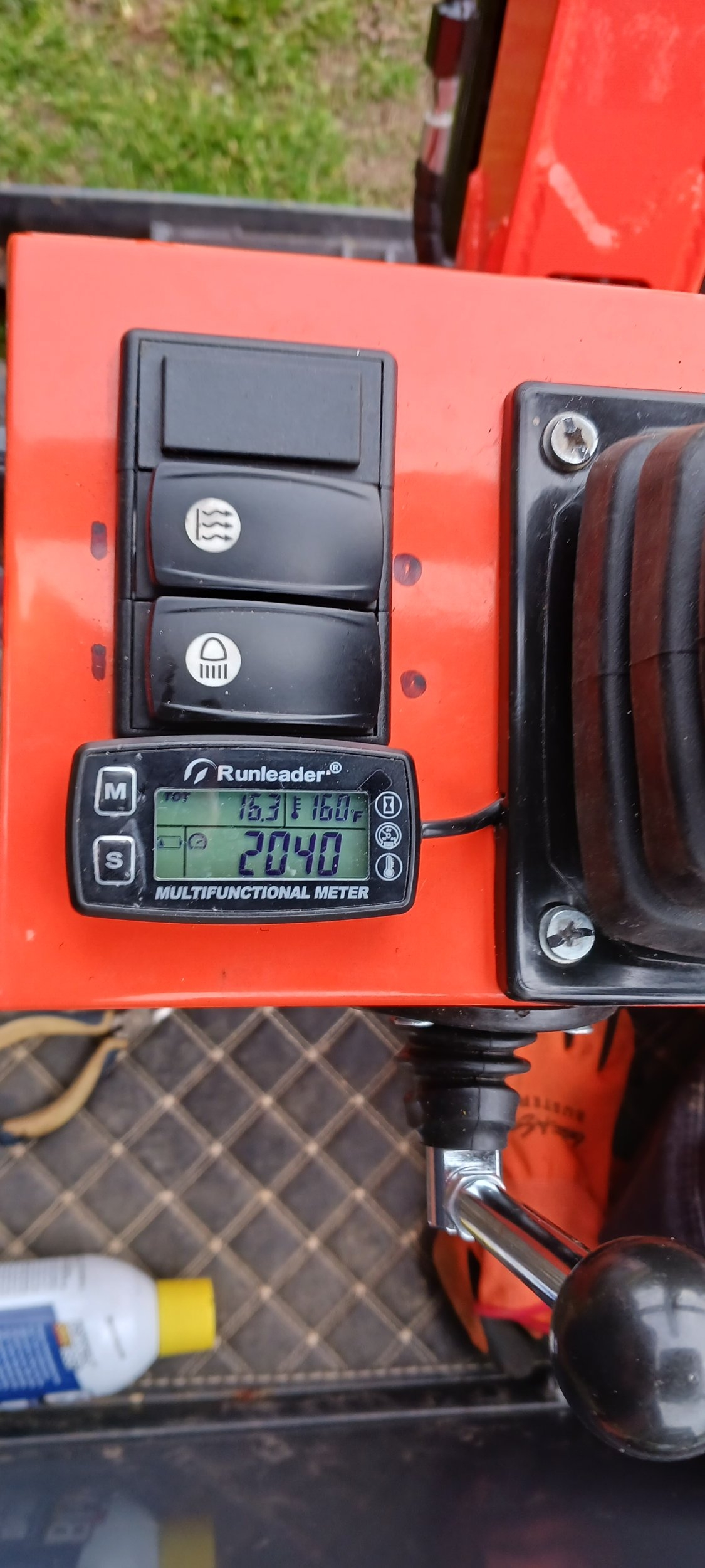

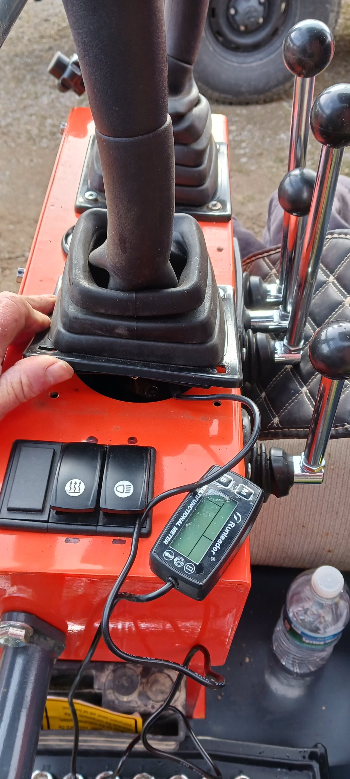

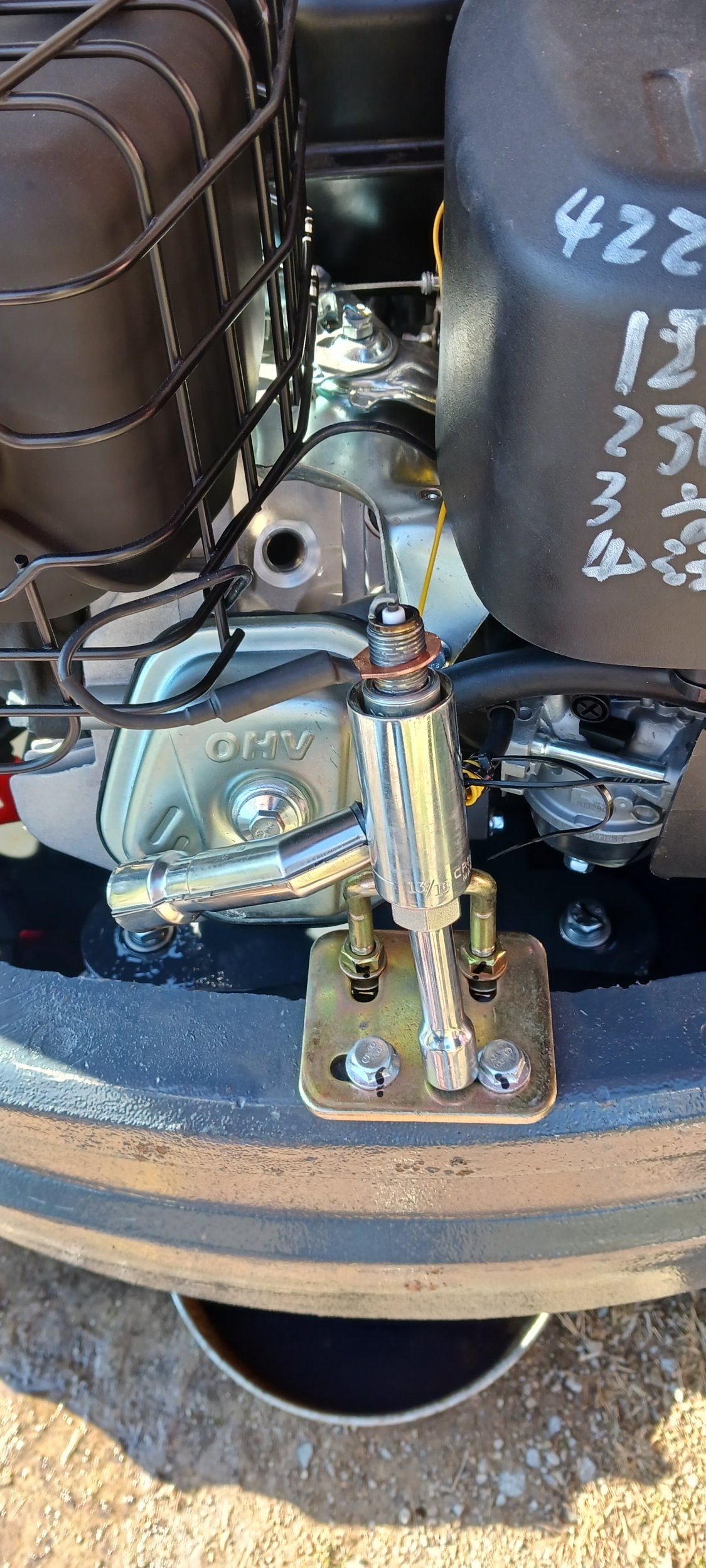

Does anyone know what the maximum allowable temp may be for the Briggs engine on our mini~X machines. My temp sensor attaches between the head and spark plug. I would guess that is the hottest part of the engine but I am guessing. On 50` days my temp gets up around 285. I would appreciate some help here. Can't find any thing in my old Briggs manual.
I don't have an answer for you.
5y ago, I was working with a few others who were following my efforts to put a new 420cc engine into a Chinese mini that was purchased without a motor. One guy,a building contractor in SoCal, really worked his machine hard on jobsites. Enough to change the color of the engine oil that day. So he changes the oil after every job. Last I heard, the machine is still running. I think he also removed the house cover in the back so the engine would not get so hot.
I think that if I monitored the engine temp, I would place the sensor in the oil sump.
