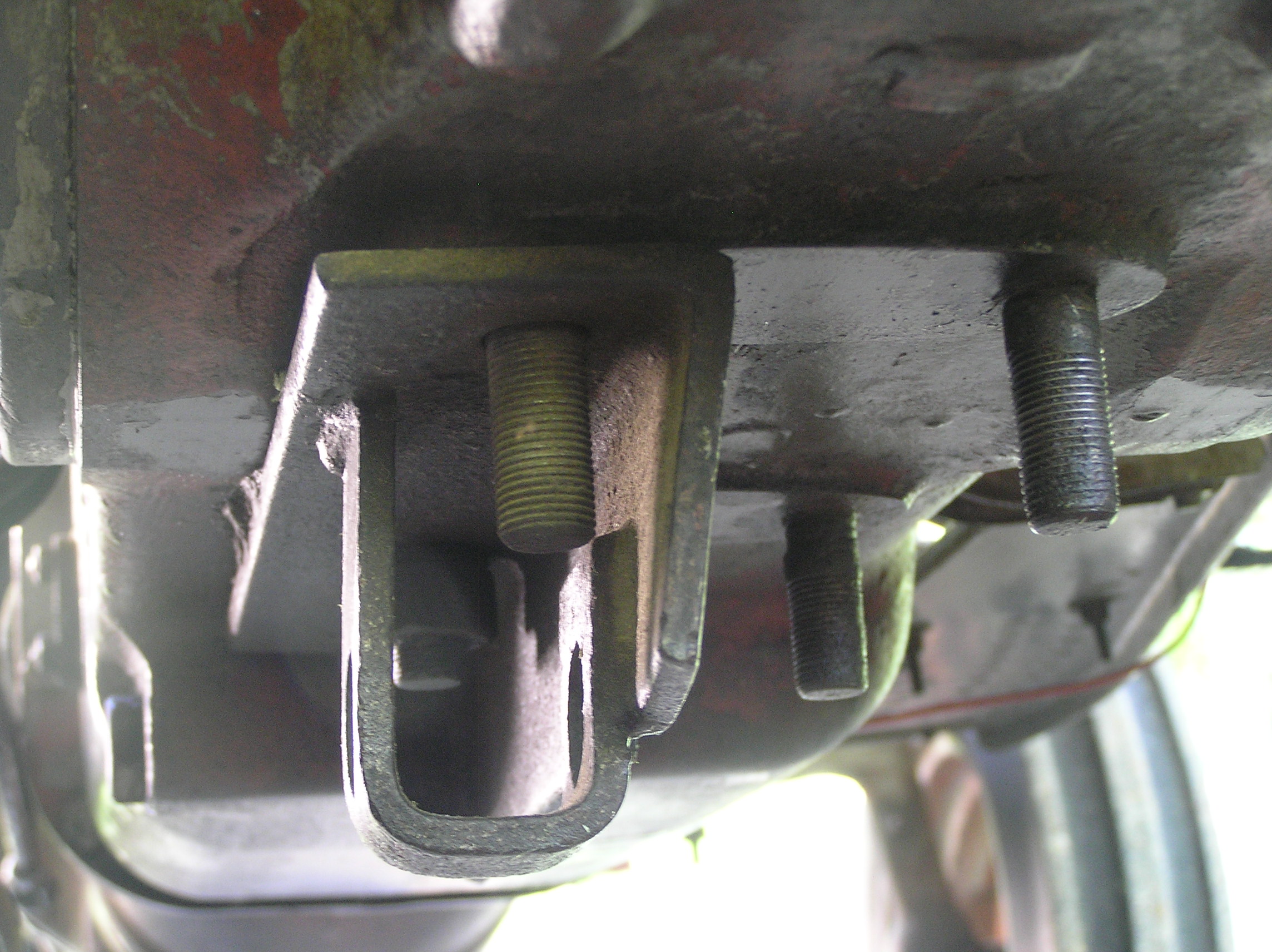

Beefy threaded studs. Underneath the diff, in line with the PTO but offset slightly to the right side. There's some other arrangement of stuff on centerline. I should have the camera back from MIL Tuesday and I'll post a photo. I tried going through the manuals I have here but no illustrations of what I've been trying to describe.

Finally... MIL did bust my camera. But she gave me her old one as a replacement. Turns out that there are four studs. A bracket is bolted to two of them and held on by one nut.
I suppose this is to mount a swinging drawbar? I'm guessing that a swinging drawbar is so I can drag stuff around?
Or what am I suppose to attach here?

I have no idea what that piece is but I am far from expert in this field. I'll wait untill someone else chimes in. I'd like to know.
BTW, can you zoom out a bit?

It looks to me like there are some nuts missing from that setup.
Could it possibly be for mounting a Mid Mower?
A pic showing where these are located in relation to the rear of the tractor would be helpful.
The drawbar you were asking about is used for pulling ome implements. The one that comes immediately to mind is a pull type bush hog. It's hitched to the cross drawbar to allow lifting the mower off obstructions, and probably gives a bit better turning radius.
