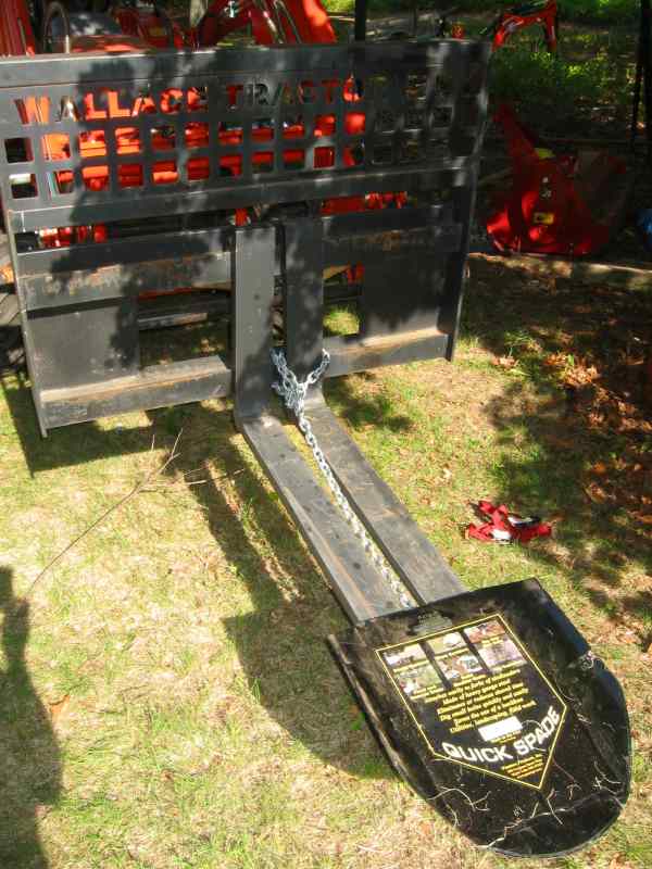

/ Implement to Prepare for Tree Planting #10

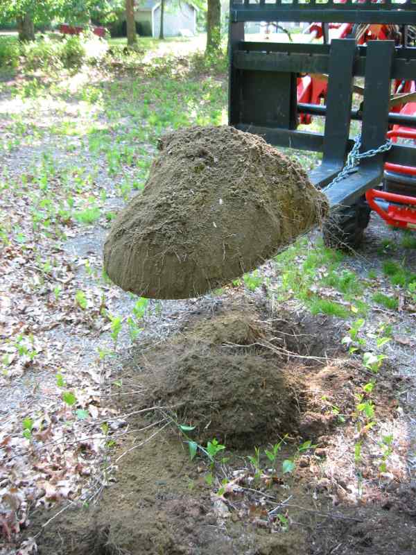

There is an attachment called a QuickSpade that might be of use with your FEL bucket if you don't need to dig more than about 18 inches deep. I have the version that fits on to adjustable forks and my version can dig about four feet deep but the bucket only version would still be very useful. It is essentially a very large shovel blade that mounts to either the bucket lip or to forks. I recall that Northern Tool carries them or you can order direct from the manufacturer. The nice thing about them is that you can use it both to dig the hole for the new tree/bush and also use it to uproot an existing plant and move it.

Thanks for the many suggestions, everyone. Although, as is often the case, there seems to be a few ways to go with this and so I am still not entirely sure what implement to buy first.
The moldboard plow sounds good...I'll see if I can find what they look like and where they are available. I actually have a gas-powered hand-held auger that I tried to use for a few trees. Helped, but was still hard work...I'm sure it would be much easier if the tractor was doing the holding of the thing!
The spade looks cool, too, but I am not lucky enough to have a bucket on my tractor :(
