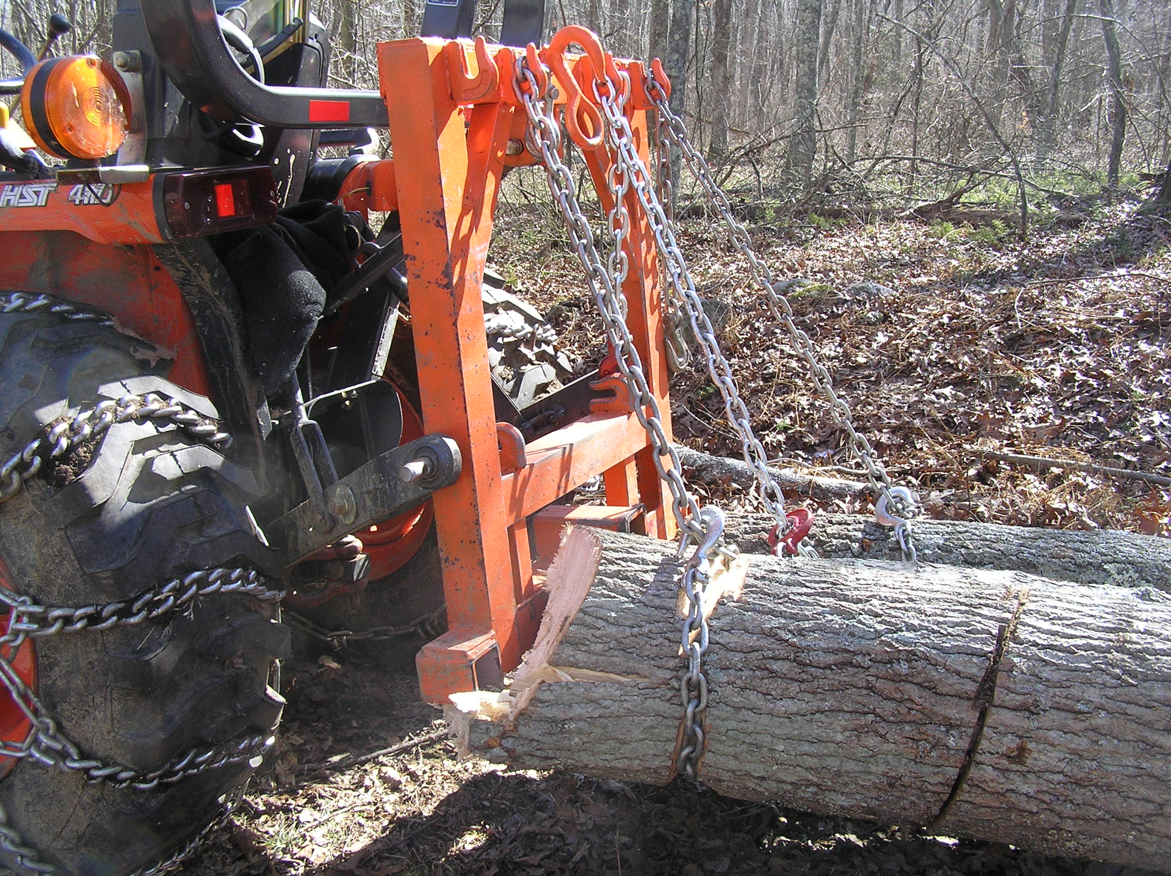

Regarding the log skidder. I don't like how the chain is up so high. If the log jammed on something while you were pulling it uphill you could flip your tractor over backwards. Unless you are specifically skidding out logs for commercial purposes (in which case get a proper log winch) then why not just push the downed trees out of the way and let them rot or wait until you get around to cutting them up and removing with grapple and/or trailer.

My first Implement.....Hvy Duty Bar between 3pt draft arms, with clevis to pass chain through. Cost = $44.95 I am now, most likely, the cheapest tractor newbie with an implement; but it got the job done. Just took 4 days.
I used this all last week to clear, drag, and position approx. 50 logs, which are now part of our firewood supply, neatly stacked for drying.
