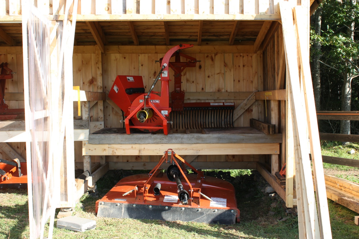

PA... somewhere on TBN some one did this shelf thing. The idea is to place the rake and back blade on the shelf with forks. The shelf will be 2x10" x10' joists/span with angle bracing on the sides with 2x4 as decking with 1" spacing between deck boards. Hopefully this will be strong enough to hold the rake and blade - they will be in separate bays not together on one shelf. They will be high enough to allow the bush hog to be backed in underneath. The snow blower will sit in front in the other bay.

Been busy with lots of little projects before winter sets in.
Managed to get the roof and battens on. I will trim tar paper and flash facia with aluminum.
Still need to lay landscape fabric and gravel before putting implements in.
Doors are "quick and dirty" and roughly in place - need to build another set plus one more shelf on right side. Each shelf will have a thin sheet of ply added... because I have some laying around. Also the front of the 2x4s on shelf will have a facia board added to tie them together.
One of the little projects was a carry-all for the back of tractor. Another "quick and dirty"
job - the base is a decent hardwood pallet.

Started to load implements in. Still need to build other doors and lay gravel but everything will JUST fit.
