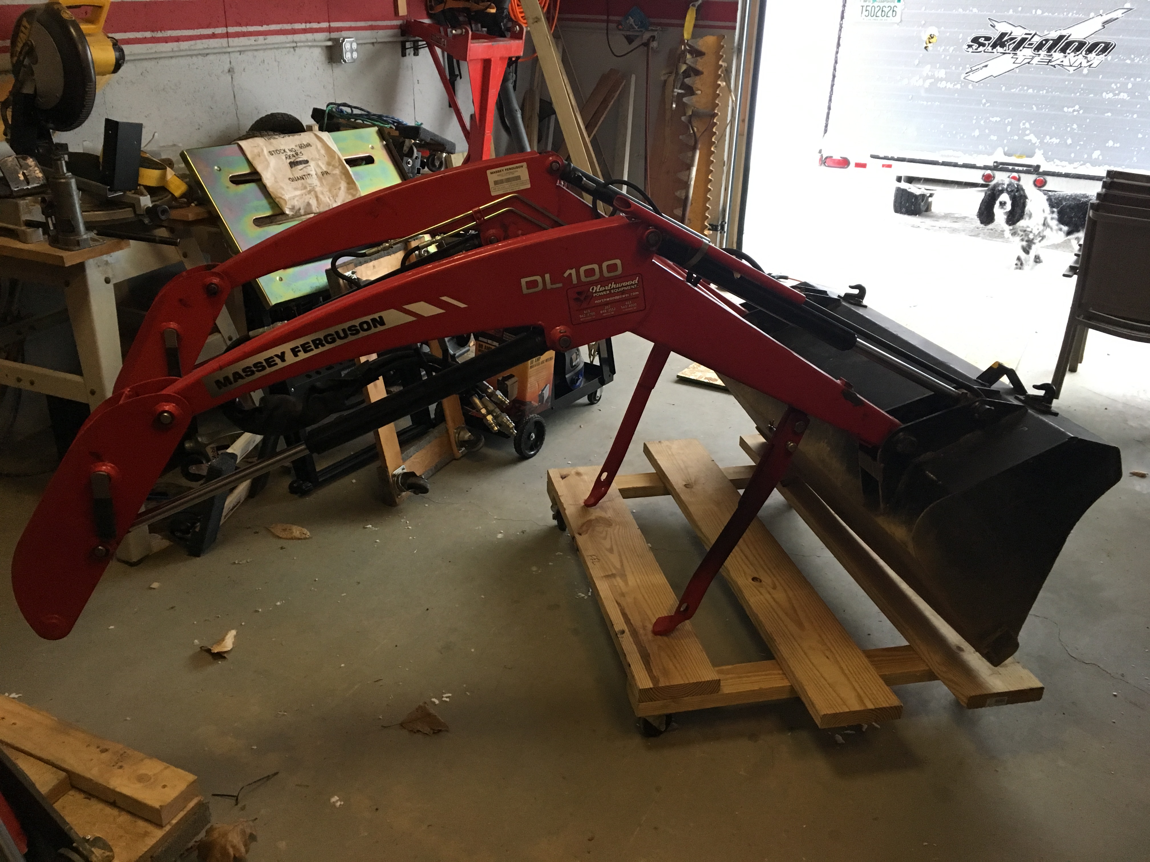

Scrap lumber and a few casters made a useful FEL dolly. It is great now being able to move it around inside the garage.
I also have a HF dolly under my 350lb ballast box.
