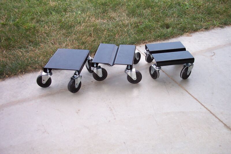

No, not that kind of 'Dolly'
I bought these from Northern Equipment. They are expensive ($59 for a set of three) but can hold 500lbs each and glide on my smooth concrete floor like 'Butter'.

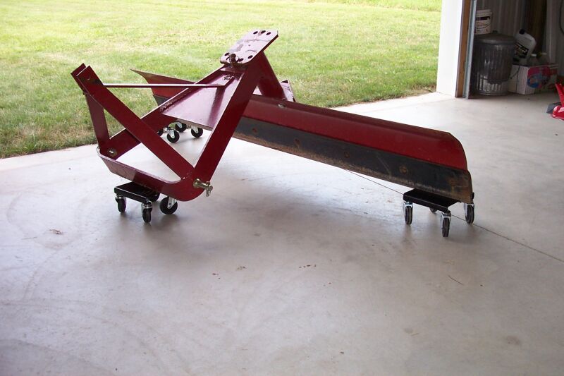

Makes for easy implement hook-up and storage. /w3tcompact/icons/grin.gif

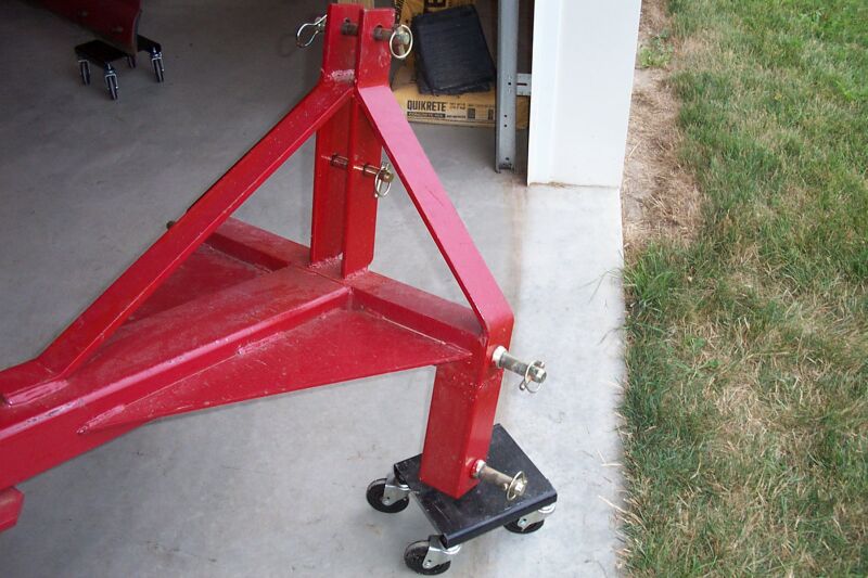

Oh Yes !, Another one !

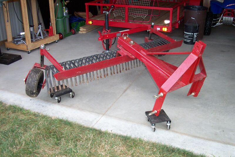

/w3tcompact/icons/eyes.gif
Go ahead........, ask me why there is two sets of lowers pins and two sets of upper pins.

Ok why are there two sets of pins? Let me go one better, why are the implements Farmall red instead of New Holland Blue?

They're red because I bought them at the Massey Dealer. /w3tcompact/icons/blush.gif
The two sets of pins allow me to attach the rake at a lower point and get a higher range of motion. With the stock location I can only lift the rake about two inches off the ground. The top link angle that is required for gauge wheel operation creates this range of motion problem. So, I welded on some additional mounting locations. Of course, I can't turn the rake 180 degrees now, but never did anyway. /w3tcompact/icons/smile.gif

One set for the high road and another for the low road. Seems there used to be a song about those two roads. You are prepared for them both.

Last year I bought the exact same set-up except the two with the "Grooves" had rubber on them. They were sold as snowmobile dollies and the grooves are for the runners on the skiis! Seems to me they cost right around $50 for the set... they sure make snowmobile storage a whole lot easier I can imagine they do the same thing for tractor implements.

Yes Jim, the first set I bought were for my snowmobile. Then I realized how useful they could be to move other heavy stuff. I now have two sets and no longer have a snowmobile.
