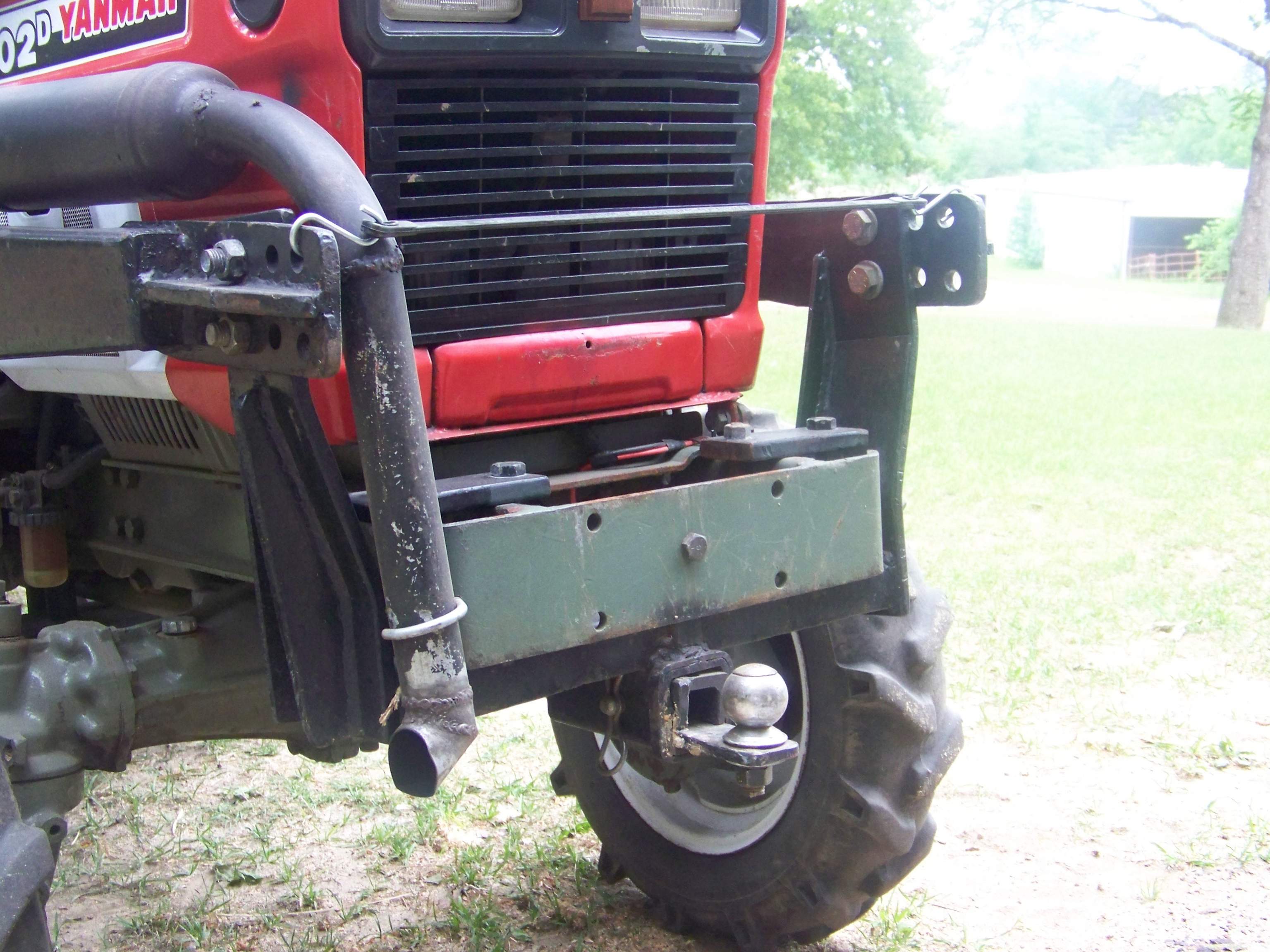

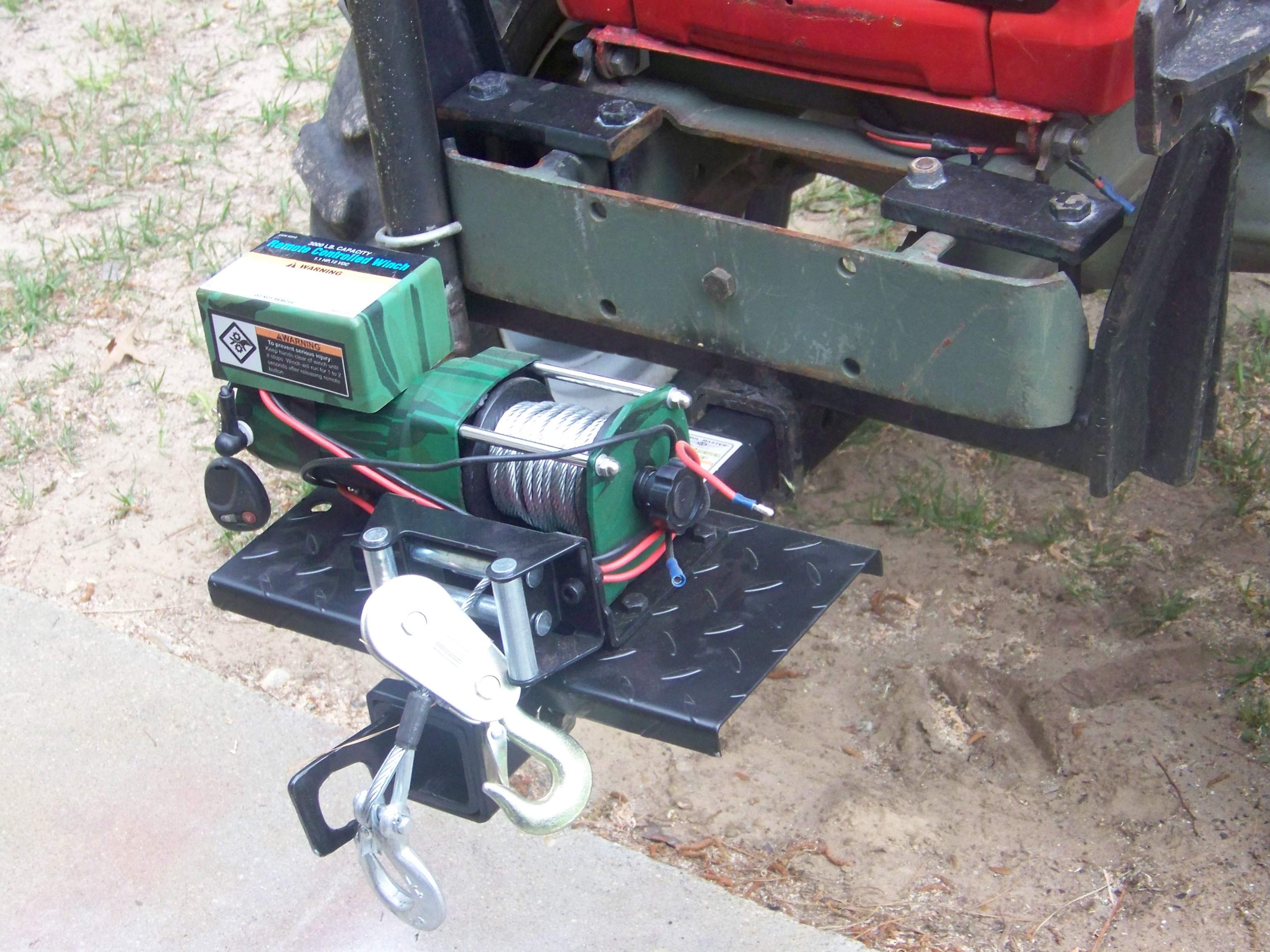

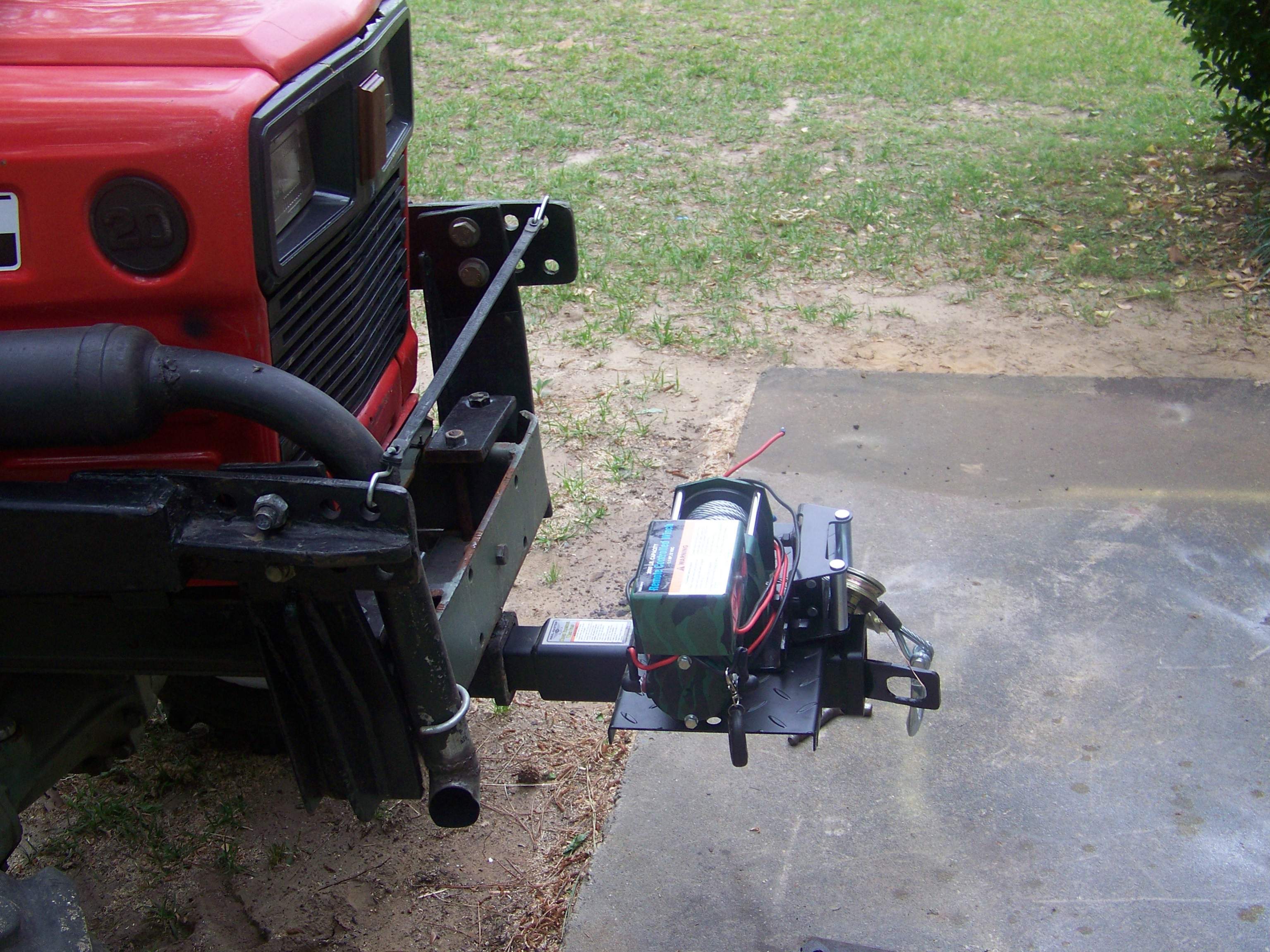

Here is mine. Not been tested in a real situation. Did run it playing around for several pulls. Definitely think your battery should have enough juice to get you out of a mud hole. I have it wire up where I can just plug it in when needed. Not sure the winch is big enough. It is this one from Harbor Freight. Camouflage 12 Volt 3000 Lb. Capacity Wireless Remote Controlled Portable Winch with Roller Fairlead Mounted on this. Hitch Mount Vise Plate I think I gave $49 or $59 for the winch with a saver coupon.

I have the HF Camo Winch too. I don't know if it would pull a stuck tractor alone, but with the line doubled I think it would give enough assist to help the tractor drive itself out of trouble.
They often advertise it at $59, occasionally at $49. Well worth it.
In my light use, it hardly draws this auxiliary battery down at all.

Scotty, give some thought to buying a pulley and hooking it on your 2000# winches line. Look at reply #4 (winston),the photos are showing his winch bolted on a vice mount with the multiplying pulley. The pulley would double your pulling capacity......it does take twice the line though.:thumbsup:
