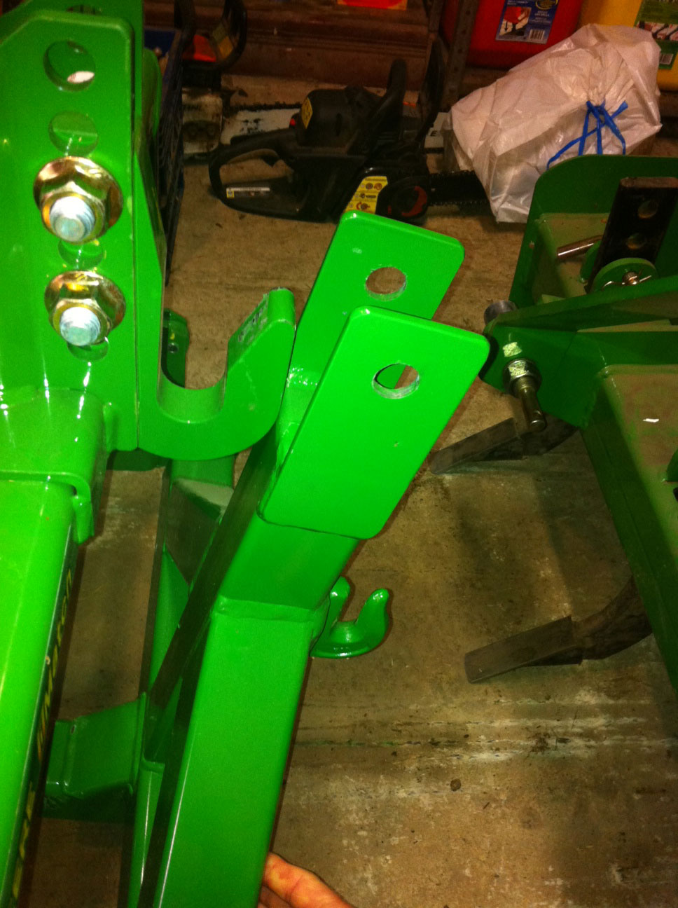

Thanks for the advice on getting those bolts off. But as far as the receiver. I realize i need to get the bushings kit. Thats not my concern. Seems as though the hook is too low for it. Hook bangs right into the square tubing when bottom pins are already sitting on the imatch bottom pin grabs. Looks like and form of quick hitch wasn't in mind by the person who made this. Bought it from ebay.

Raise that hook two holes and it will work. Replace the hook bolts with pins to change it easier.

Photo attached. Also attached is a photo of my now useless 3 point receiver hitch that I ordered before I owned imatch. If you look at the pic, see the hook don't stand a chance of working with it unless I have some chopping tools and a welder. View attachment 273577View attachment 273578
The implement shown is not useless with the I-Match (very nice, BTW) at all, but a slight modification is in order... If you have access to a milling machine, mill a 2 inch (minimum) wide slot in the upright box tubing below where the hook needs to go (just on the back side so the hook can slide in.). If no machine tools available, drill two holes side by side along what will be the bottom edge of the slot, and do your styraight cuts with a cutoff wheel. I'd do my best to leave the radius and a small land on the corners of the box tubing. A couple of hours work, and you have a useful implement again You can weld a thin piece of rectangular bar stock on top of the uprights to retain rigidity there...

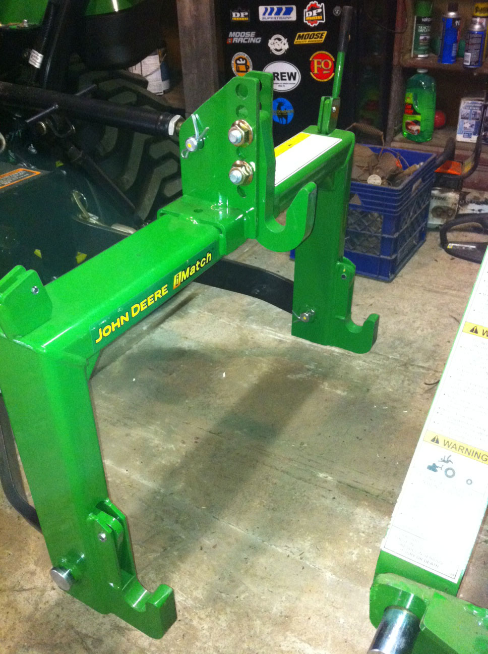

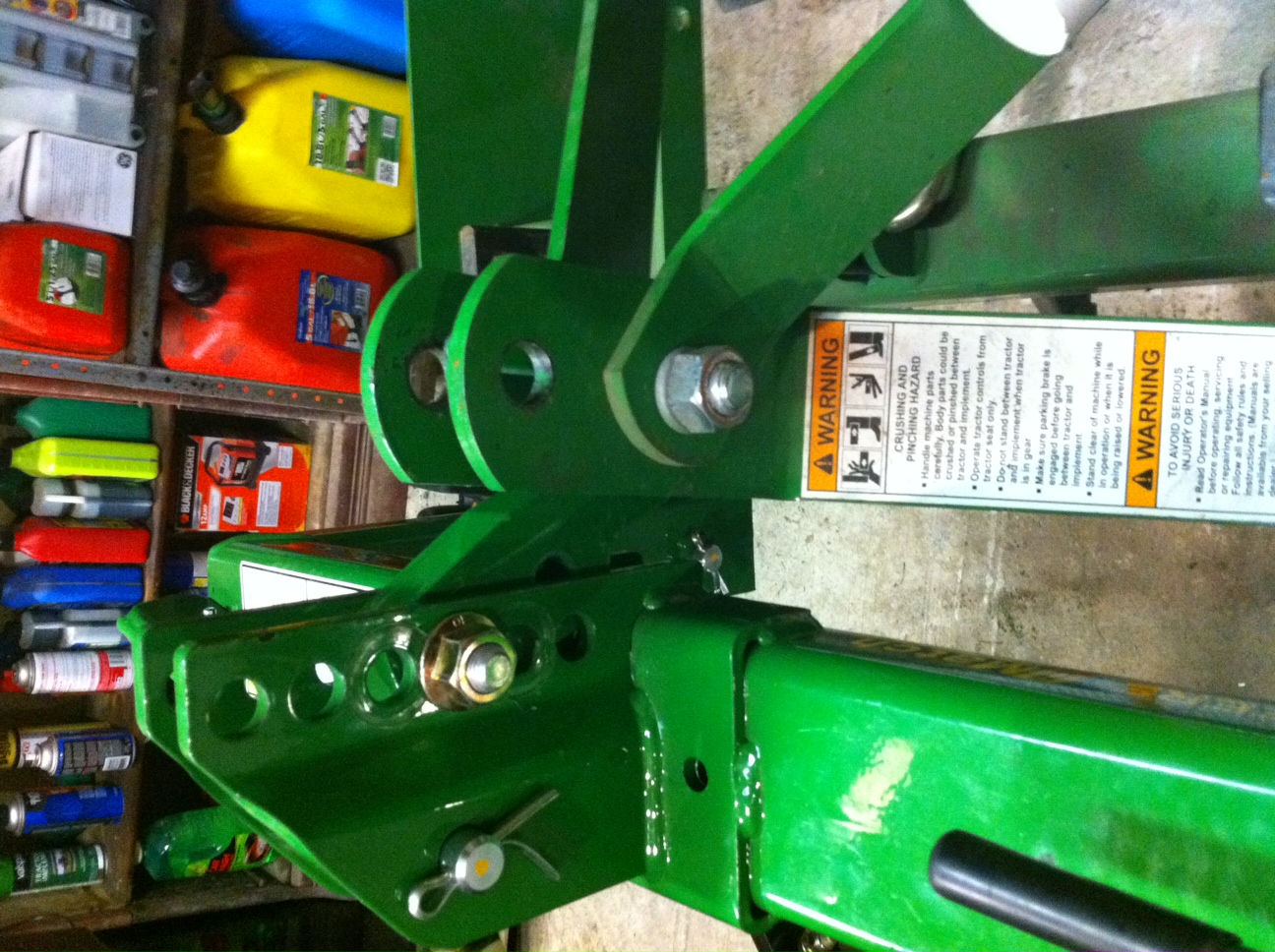

Ok all, messed around with it a bit tonight. So far my conclusions are..... Is it really supposed to be double bolted? When I remove the bottom bolt and loosed the other it allows that hook to pivot in and out which then works flawless. When that hook it bolted in place and not able to move, my ballast box nor my box blade will drop fully down into that hood. The metal hits metal before it allows it. Should i just throw a single pin in there and allow that hook to pivot forward? I attached a photo to show you. If you go back in this thread a bit you will see the original pic I posted where the to bolts were in it.

I'd say it's really supposed to be double bolted...however, if one bolt works, then I suggest you see how well it holds up.
I expect you'll see any problems when you're reversing...the top hook will probably pivot somewhat...possible the upper link on the implement could ride out of the hook, so be aware of that.
As far as pulling, I doubt you have any problems as long as you use a Grade 8 bolt. Do watch for eventual egging of the QH holes though, if you continually use one bolt.

I removed both bolts and put pins in (which eliminated the large head of the bolt). Ballast box and box blade both connect easily. It was actually the heads of the bolts that were making the top not be able to slide in between the tops of the attachments. John deere has got to be joking right?? They didn't test this on a Frontier Box Blade and a Frontier Ballast box when redesigning this? Without a doubt this large bolts cause an obstruction which doesnt allow you to fully back into the attachment and raise the hook.
/ iMatch with Frontier Box Blade #31
Yes it does look like a clearance issue, the prior style with the welded in place fixed hook didn't have this problem. Looking at the pictures and comparing to my Imatch the top hook should be set where it is almost even with the top of the horizontal cross tubing. When looking at your picture of the new IMatch it was preset for the correct height.
Bet this won't be the last thread on this clearance issue, somebody dropped the ball.

Been looking at a lot of the other hitches as well as the older imatch. All the hooks stick out further then the newest imatch version. There isn't a bit of space between the imatch top metal and my box blade top metal. The welds are literally rubbing together.
