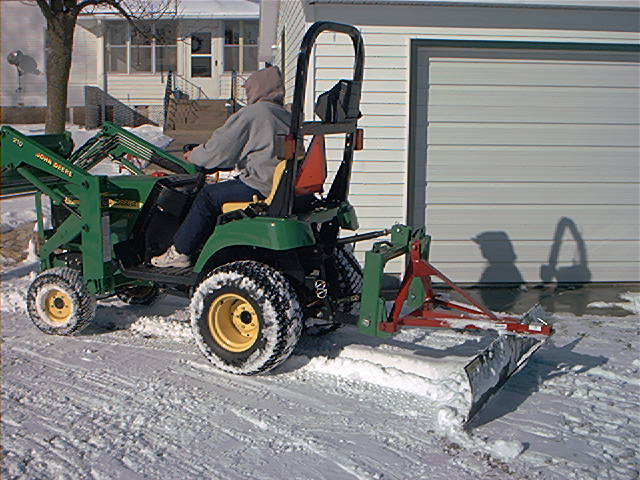

Imatch is great. This is a picture of the rear blade on the Imatch. Modification was required to get the blade and landscape rake to work, but it was worth it. /forums/images/graemlins/smile.gif

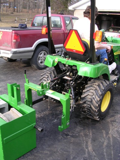

The rear ballas box and moldord plow are my only rear attachments for now. here is a picture of my wife using the i-match.
