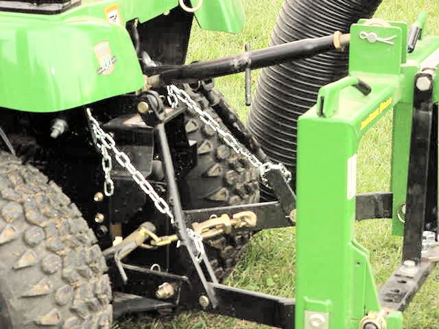

Yes it does.

hello. I just bought my first CUT, a 2210, a few weeks ago. Got the Imatch, ballast, belly mower, FEL and rear scraper blade. The Imatch works fine for me. It's a little un-nerving at first, getting the speed of its up/down motion adjusted with the knob that is under the seat. What I don't like, at all, is that you can't operate the belly mower (up/down) independent of the up/down action of the Imatch. (at least, I have not been able to figure out how to do this.....maybe someone else knows the answer).

Seems I recall that one of the forum members designed and fabricated an hydraulic cylinder that would lift the belly mower on the 2210, which made it independent of the 3pt. That is likely an answer for you. Maybe someone else recalls also, and we can find that post or thread.
