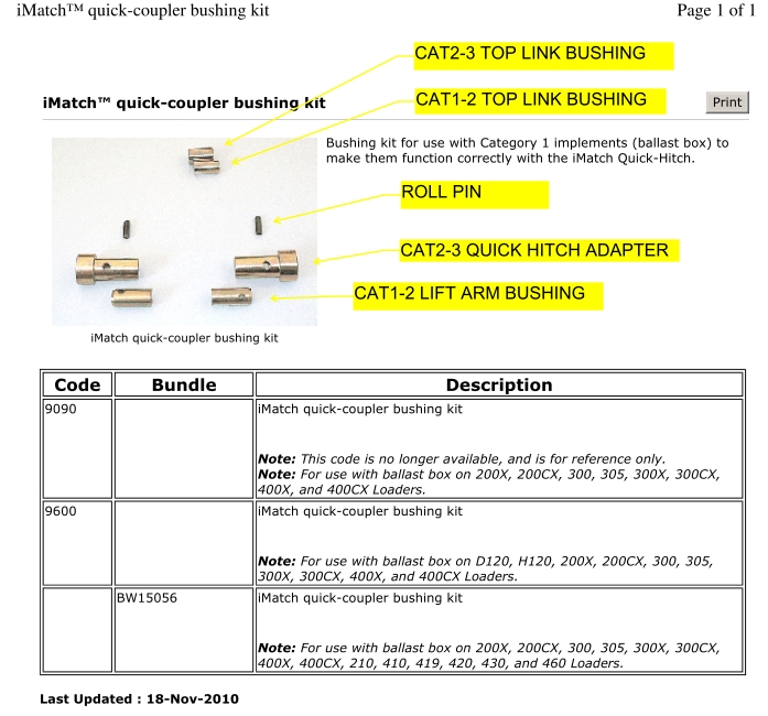

Any input on what you've paid for an iMatch and balast box? I have a new 2320 and need balast for the FEL use...:thumbsup:

You will also need an iMatch bushing adapter kit. The issue is the iMatch is a one size fits all offering from JD and is sized for CAT-3 implements. The ballast box is CAT-1. The JD kit (BW15056) is somewhat costly for what you get. It also does not include a top link pin which your ballast box may need as well. You can gather your own complete kit for less at various online ag stores.
The purchase of the iMatch includes one set of bushings.
/ iMatch & Balast Box #8
Correct. One set comes with the iMatch. If you have multiple attachments you need additional bushing sets.

take 2 catI lower bushing and slide them into 2 catII bushings from your local tractor supply store and Bingo new set of bushings, should come in at a whopping $4 or so.

I think we all recommend the iMatch + ballast box combination. Kennyd pointed out that the iMatch includes one BW15056 iMatch quick-coupler bushing kit. This needs to be added to the ballast box so it fits securely onto the iMatch.
For your additional attachments (if you have any) you may need to add another bushing kit to the attachment. The JD kit is somewhat pricey. You can get all the pieces elsewhere for less. Here is an example:
Ag Supply
#D-21192 TOP LINK BUSHING CAT 2-3 = $1.86
#D-21190 TOP LINK BUSHING CAT 1-2 = $1.55
#D-10222 QUICK HITCH ADAPTER KIT CAT 1-3 = $11.00
Picture of the John Deere BW15056 kit is below:
