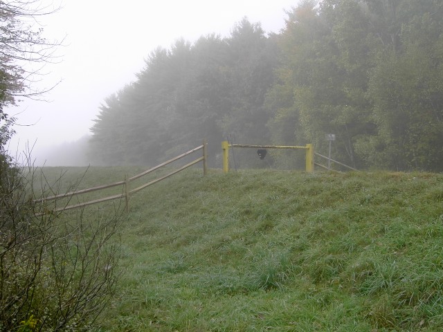

The state park that we abut is on federal property managed by the Corps Of Engineers. This dike ends at our land. Last winter we had a problem with snowmobiles coming down & around the gate & into our field, then up our driveway. A orange plastic fence put a stop to it & this summer I took more permanent measures.
