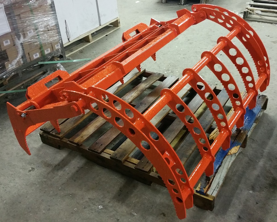

Easiest decision EVER! There's nothing like this lightweight, 200 pound chunk of 55" Wicked beauty for the new BX with universal quick attach, John Deere 1023R/1025R, Mahindra Max, or any other subcompact tractor for that matter!

It depends what your main use will be. My first grapple was that clamshell style. It is better than no grapple and good for some things. But now I have two "full bottom" grapples, a 44" and a 72" dual lid. No more clamshell for me. :D

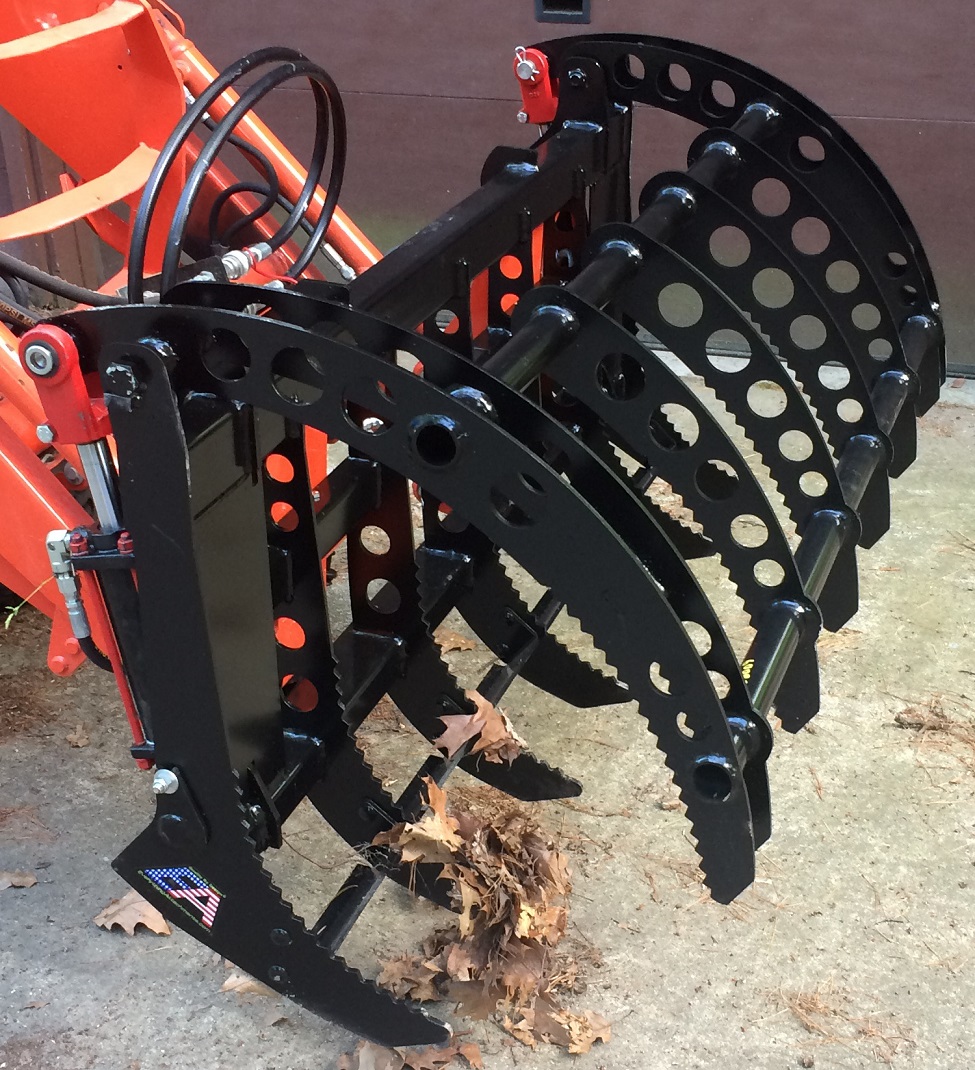

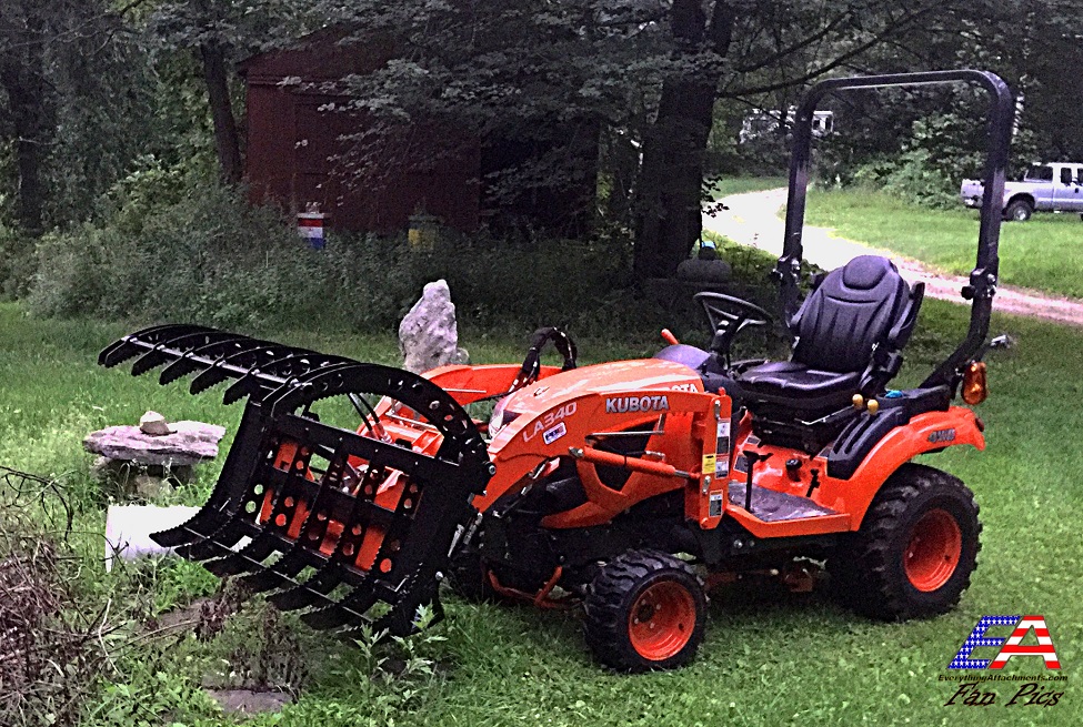

First 55" Wicked Grapple spotted on a Kubota BX23S with universal quick attach!!
The customer is amazed by the incredibly strong clamping force and the full 36" opening will grab a pile of brush!
Runners are bolted in between the tines to serve as a depth gauge. Remove them to shave off an additional 30 pounds.
He promises more pics in the near future!
