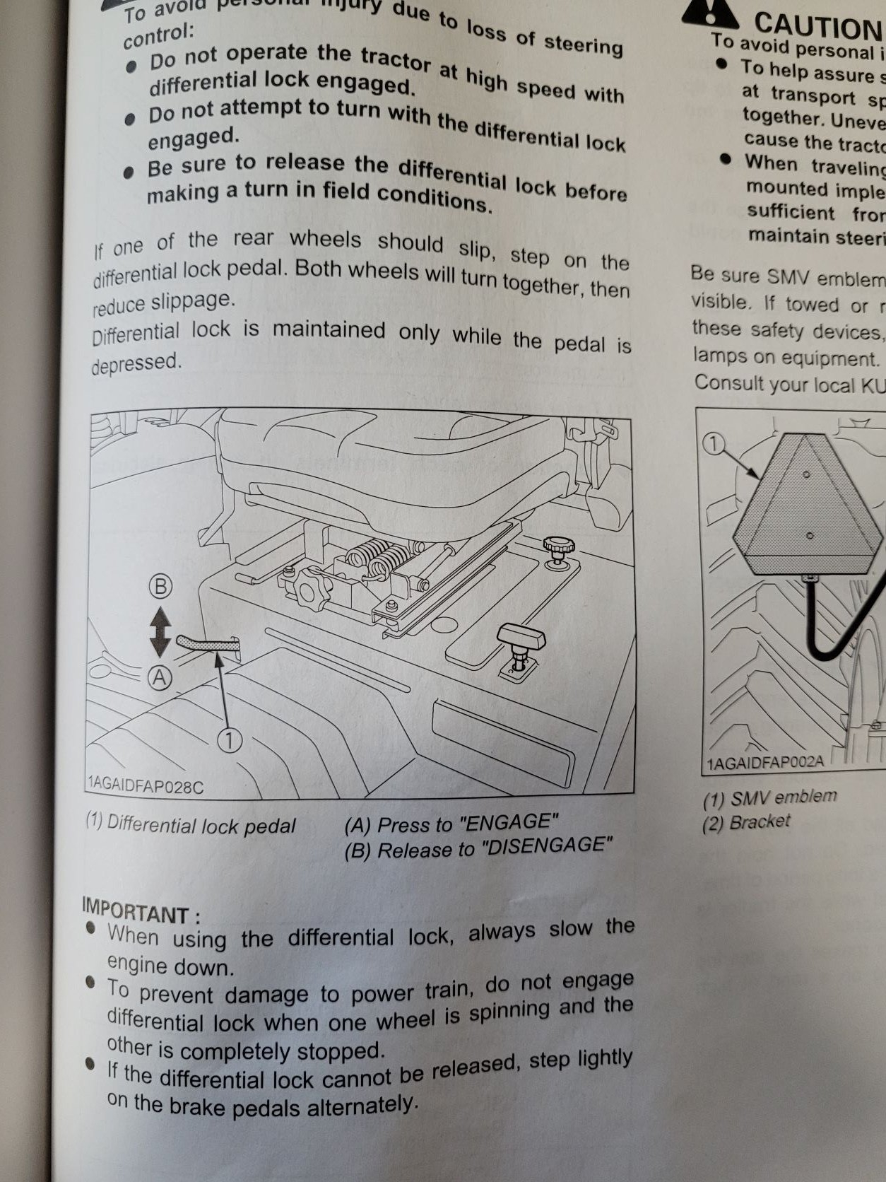

We use the diff lock regularly on our hillside farm. Might stop, might not. Takes rotation to engage after you press the pedal. Certain routine places Mowing, grading driveway, moving tree debris up steep incline. Can engage while moving before a trouble spot and disengage after the area. HST control makes this a seamless transition. Biggest beef is with the Kubota pedal design. My footwear traction is often compromised.
Same here. My 855 needs SOME tractor movement or it won't engage. If one wheel is spinning, and the tractor is not moving (who would just sit there like that anyway), you'd be stupid to try and just slam on the pedal and expect it to pull/push you out and get going. Some common sense is presumed/needed...
I have no trouble finding the JD lever with my foot.
/ I'm missing something: Front-end 4-wd #43
like stated above, I find some movement neccessary to engage the diff lock there is a difference in one wheel spinning every so slowly to align the pin holes and a wheel that is spinning at 15 mph with the tractor at a standstill. a light pressure is necessary on the pedal until it drops down into the hole then you apply torque.
for those of you that stop all movement and depress the pedal, good luck aligning the hole with the pin. Atleast on the tractors I've used I would suspect it would take somewhere between 10 and 50 tries to get the pin to align with the hole

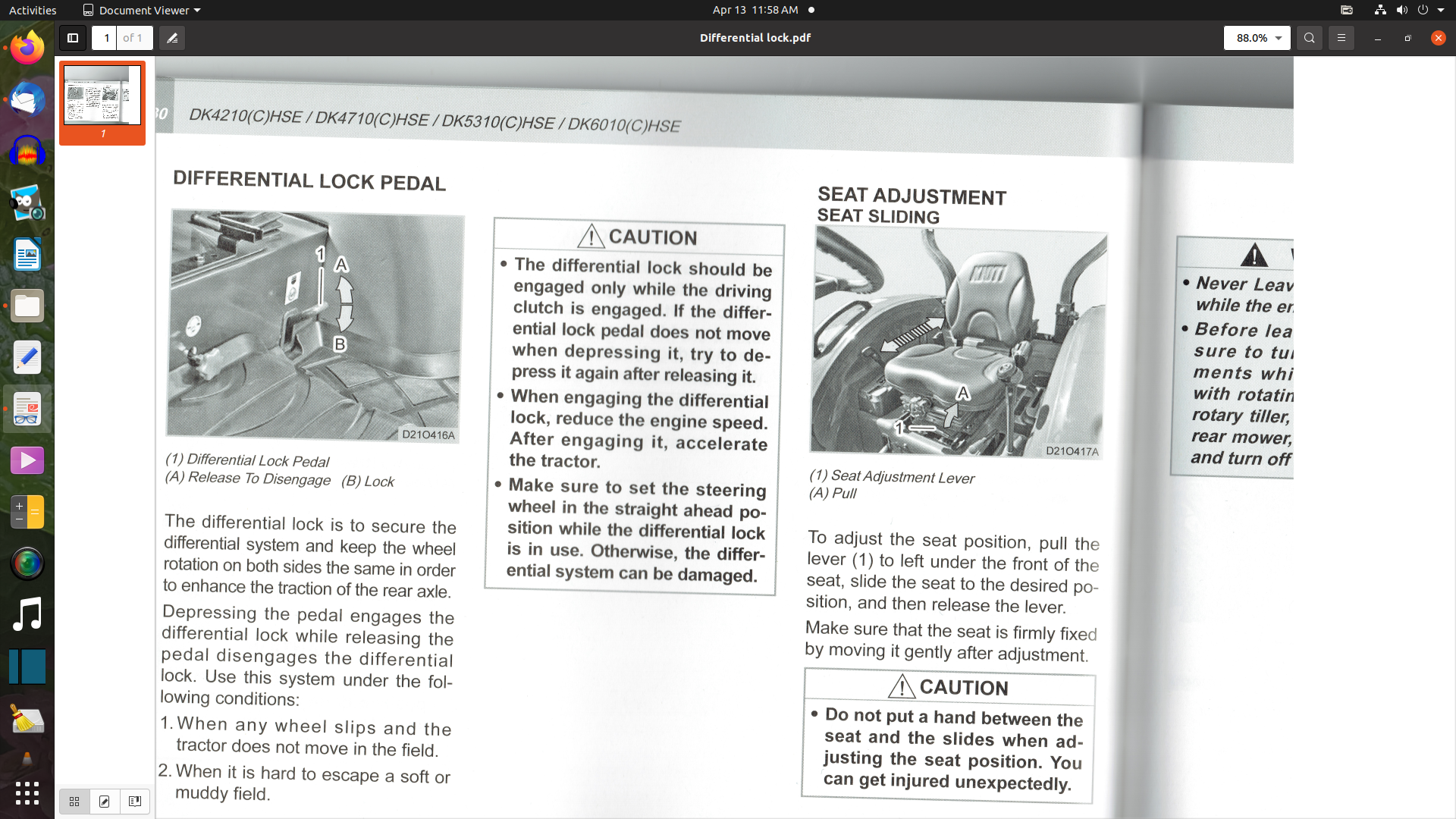

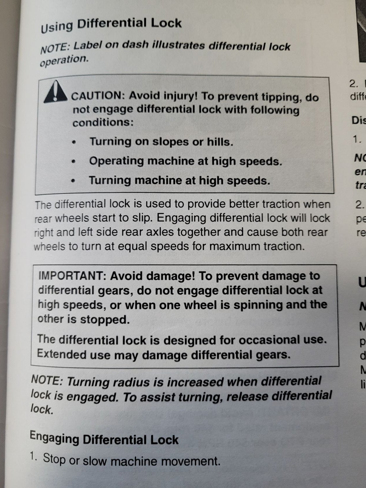

To the best of my recall, I have never successfully engaged the Diff Lock while standing still. I always have to move the tractor.
I do find it odd that such a simple one-line explanation was not in the manual.
It seems to me it's like shifting gears on a manual transmission without a clutch. I drove a VW Bug that way for some several months. The clutch was shot so, I just didn't use it. After a while, I got rather good at never grinding the gears.
The diff lock pedals on my tractors aren't a direct linkage, they're basically a pedal pulling on a spring pulling on a linkage, so you can push the pedal, but the linkage won't actually engage the locker until the elements line up.
I agree this got into splitting hairs. Sure it won't work if you're sitting still 90% of the time unless you just go lucky and everything lined up like winning a slot machine, but the main point is stuff should not be moving fast, with a lot of momentum, or with a lot of power behind it when the mechanism engages.
Also, most manual transmission gears are synchronized, and most people who think they can 'float' gears well don't realize the extent to which their synchronizers are silently converting to powder to cover for them.
On a related note, most manual transmissions have un-synchronized reverse gears. Like a tractor, quite often the teeth of the gears do not line up to engage properly when everything is stopped. If we take things in this thread purely literally, it would seem a lot of people's solution to that would be 'just keep pulling on the shifter and let out the clutch, it'll pop in!' and we can all imagine how great that would work. But the reality is that a nuanced version of that which is just a lot longer to type out, is in fact what everyone does, and is in fact fine to do. Apply a reasonable amount of torque, at a reasonable rate, allowing the pieces to align and engage under low-load conditions, and then resume normal operations.. yep, we're all pretty much doing that.
