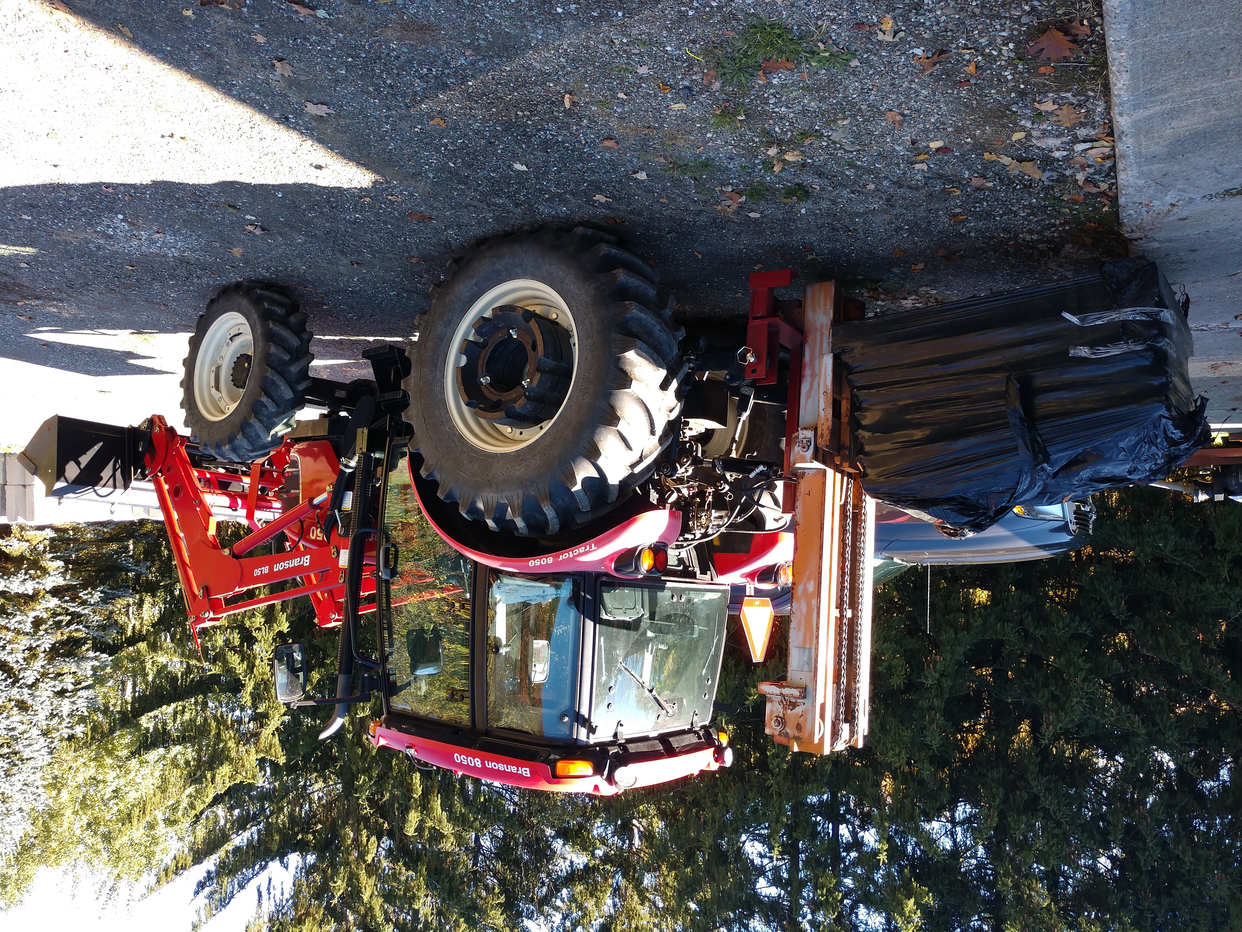

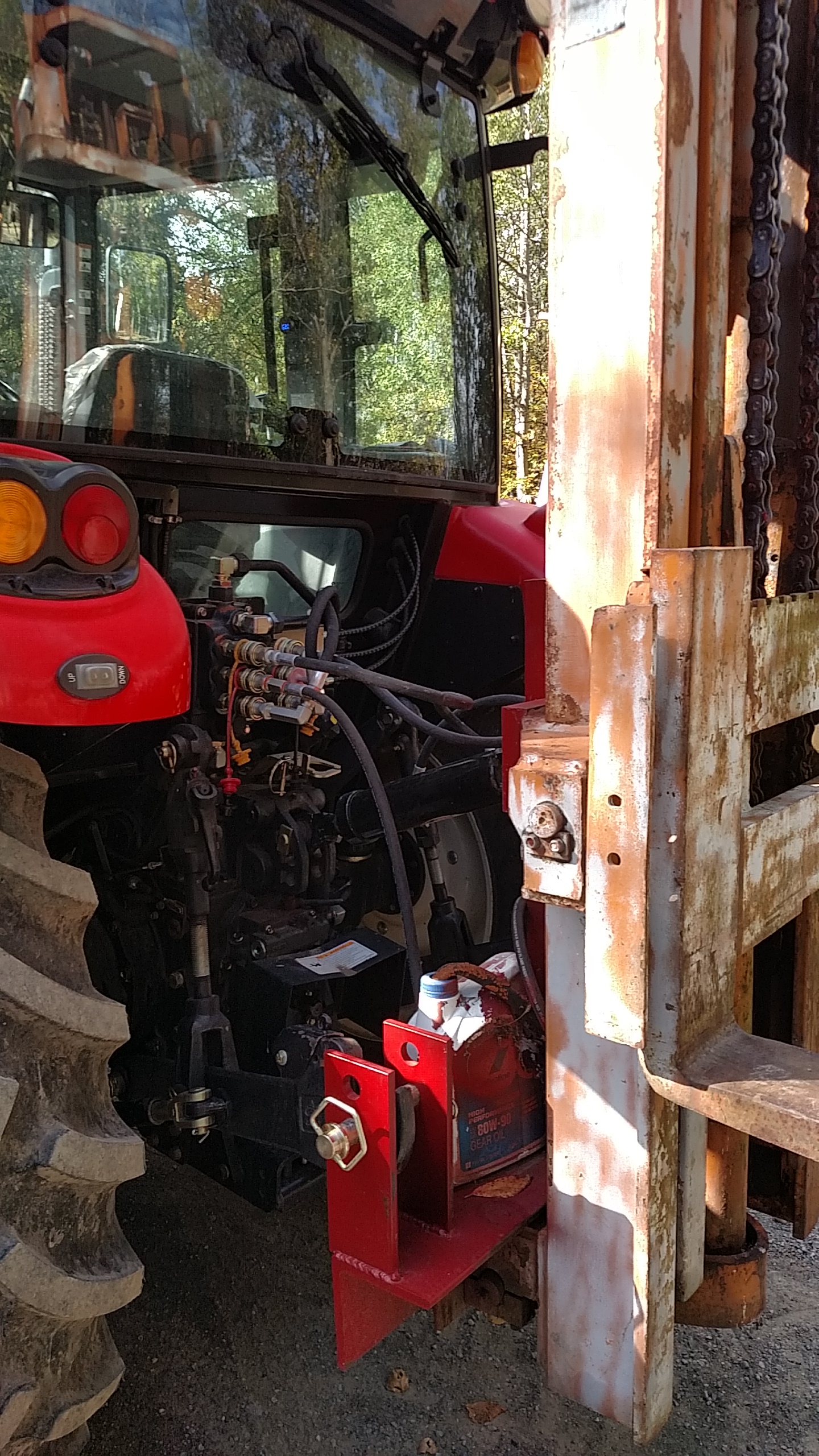

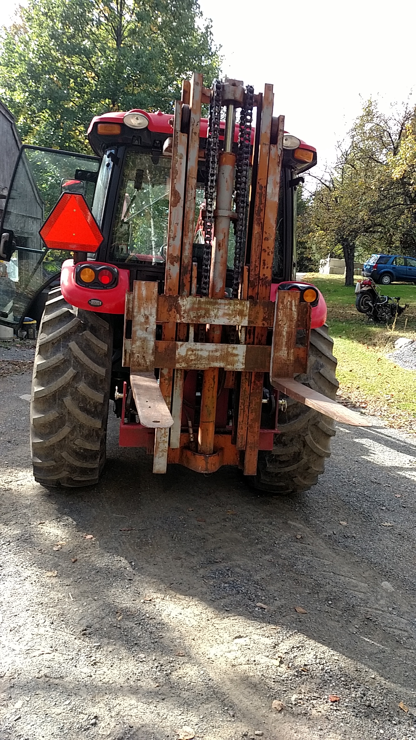

Build;
or buy;
3-Point Attachments | Westendorf
