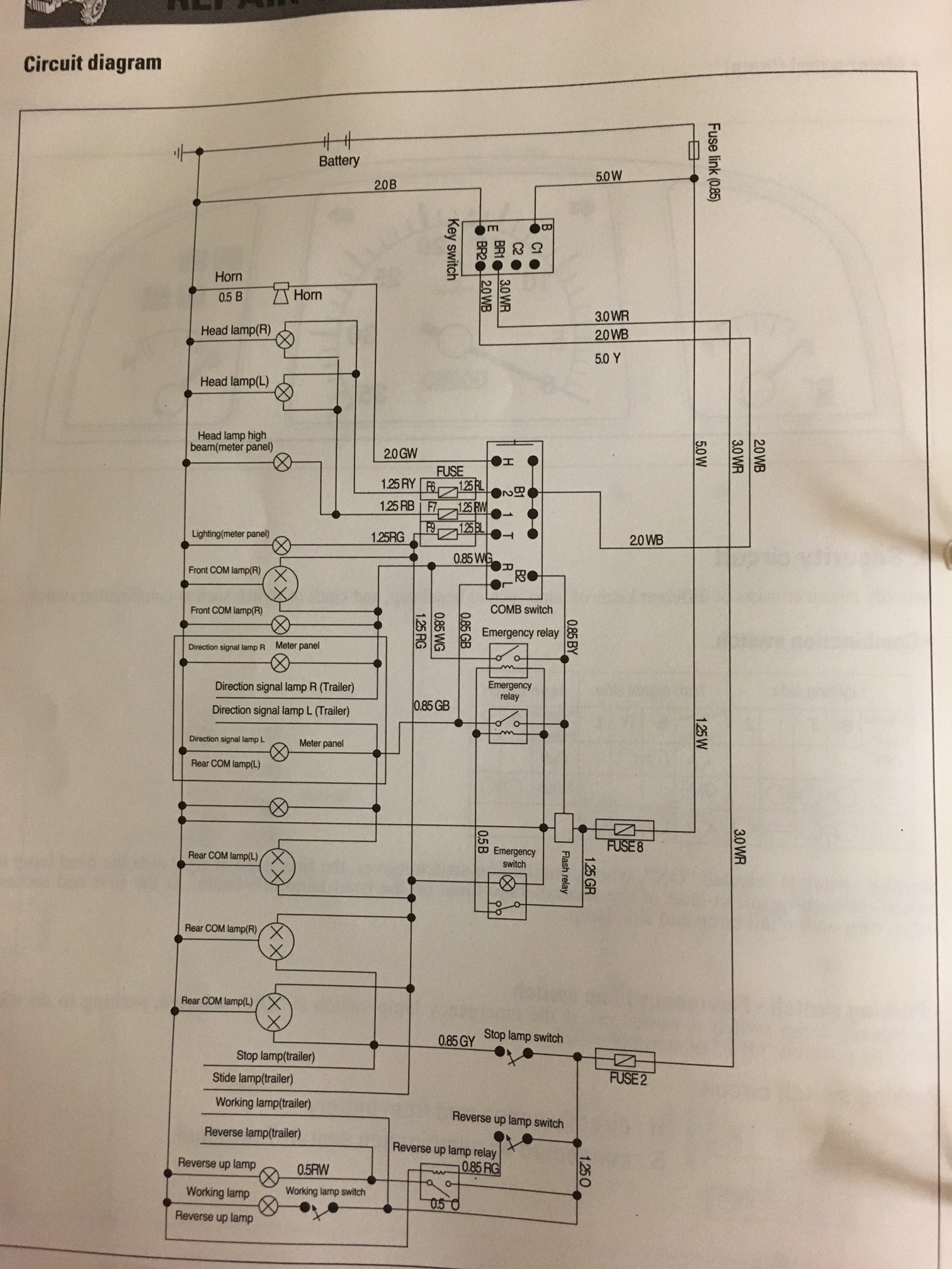

If I have done this correctly, here is some wiring info for the pre Cummins Branson and Century tractors.
/ I'm Done With Branson #47
Eddie notice that the 12 volts from the battery goes from the battery to a fusible link then to a 5 millimeter white wire to the B terminal on the key switch. Trace back that white wire.
Yes sir, that's going to be plan A!!!

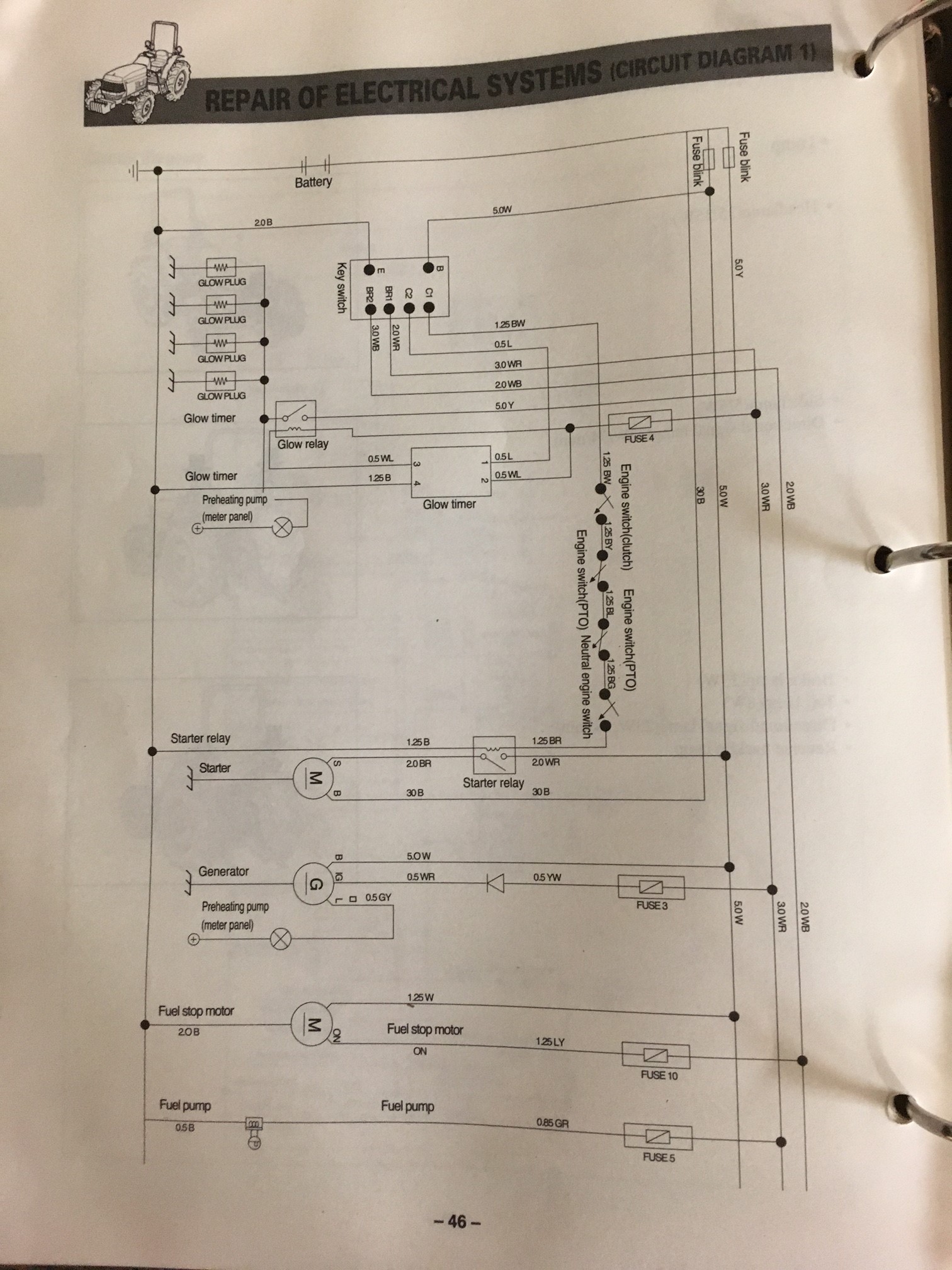

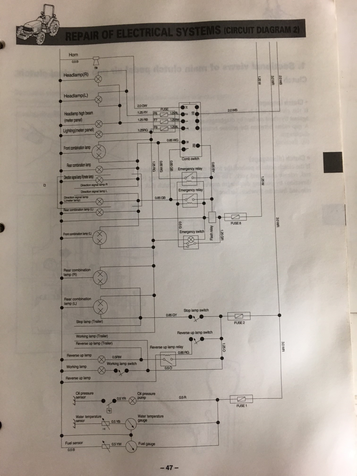

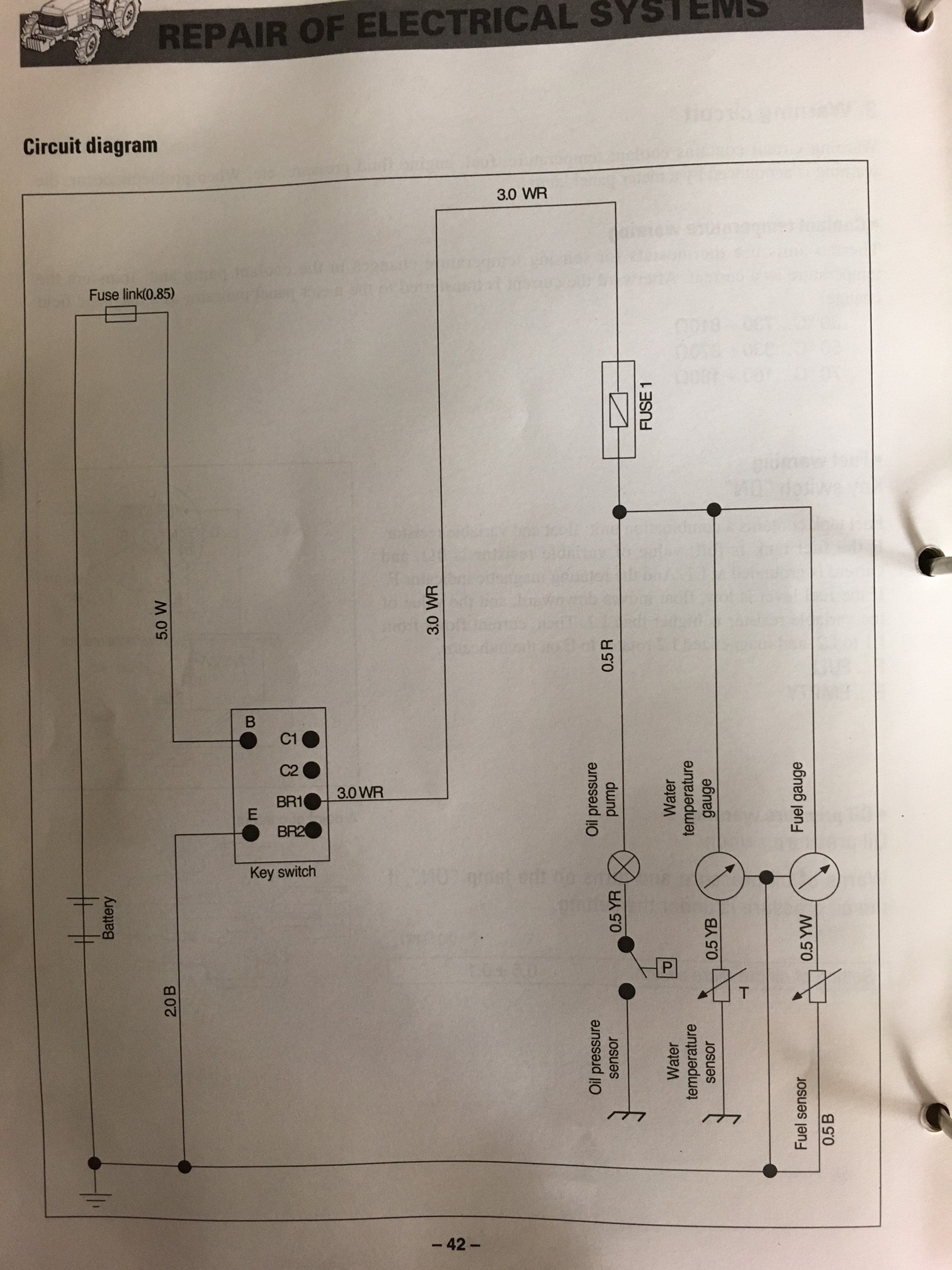

View attachment 518261View attachment 518262View attachment 518263View attachment 518264View attachment 518265View attachment 518266
Dave, thanks again for posting these pics. I've been trying to make sense of them in tracing my wires, but I keep finding differences. Finally it hit me, the diagram has four four glow plugs, but my Century 2535 only has three cylinders.
/ I'm Done With Branson #57
I never figured it out, but I kept finding bad wires and dirty connections, that I eventually ran out of problems, and it started up last night. Thanks to everyone for your help!!!!
