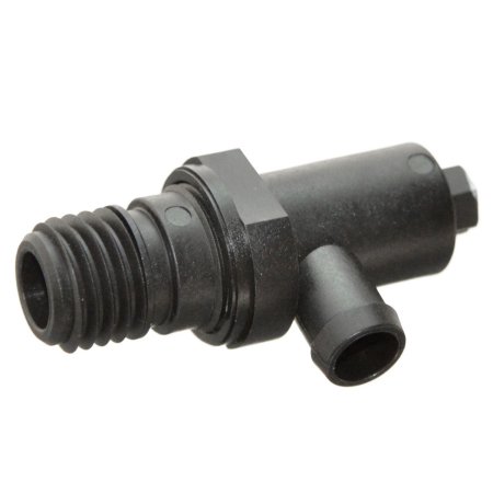

Just curious. What engine do you have?
I have a Kawasaki 850V on my ZTR. It has a device similar to this for draining oil. I can open the drain using a screwdriver in a slot on the "nut." I route a short length of garden hose from the outlet to a pan.

Same on my Z, I took the hose off loosened the nut and then put the hose back on.

I suspect that the type of drain is determined by the mower manufacturer. Last weekend I changed the oil on my mother's Simplicity with a 20 HP Briggs. It had a 10" hydraulic line threaded into the block, and a nut threaded into the other end similar to what the OP described. Her Husqvarna with an 18 HP Briggs had a device which you attach a hose to and feed it into the drain pan; then push and turn a spring loaded valve to release the old oil.
It sure beats what I'm used to, a square plug tucked up under the motor with no way to get a pan near it, so you end up with engine oil all over the place.
