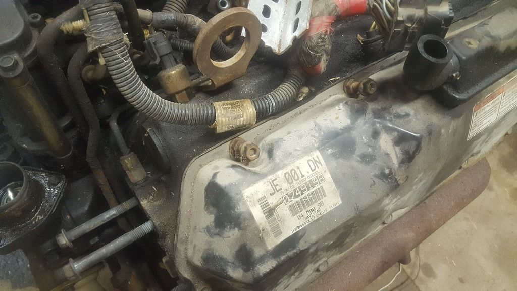

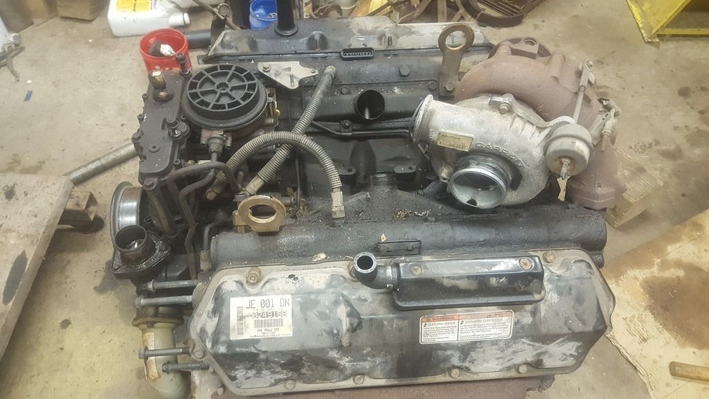

IDI motors did not come with turbo's in most cases, some of the later models (1992-1994) could have had a factory installed aftermarket setup installed. Still the IDI motor, but with a Banks turbo kit.
The Powerstroke 7.3 is a IH T444E, was offered in Ford trucks starting in 1994. Early models had no intercooler, and two wiring harness connectors going thru the valve cover gasket. 1999 and later (pictured) have intercoolers, and single larger wiring connectors going thru the valve cover gasket.
If you want more pictures of Powerstroke motors, I have LOTS more...
