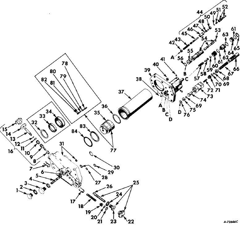

Can you post which numbers from this PDF or picture that equal the parts that you are refereing to in your text?
View attachment HYDRAULIC SYSTEM, CONTROL VALVE, TRACTORS WITH HYDRAULIC LIFT.pdf
  • HYDRAULIC SYSTEM, HYDRAULIC LIFT LEVERS AND CONNECTIONS.pdf
   / IH444 3pt wont lift
#14
looks like 55 and the similar but longer part in 54.

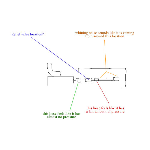

Hi bimbam,
I did what you mentioned regarding closing the isolation valve then tried to raise and lower the lift lever. The engine didn't really do anything. I am thinking I am going to have to dismantle everything as you have described. My manual shows the relief valve in between the hydraulic pump and the seat (small box below the steering column and gas tank). Is this the valve you are referring to (see rough image for area I am talking about)?
I am trying to avoid having to take apart below the seat. I had about 2.5" of hydraulic fluid below the seat so I filled it up to around 3.5 - 4" of fluid just to be safe and make sure it was above the large filter below the seat then tried moving the steering wheel and the lift level but there was no change.
A few things I should mention - there is a whining sound coming from the front side of the tractor near where the pump is located. It also feels as if the line between the control valve and the pump has pressure but the one between the seat and the control valve doesn't. Please see my attached image (rough sketch showing locations).
Thank you

sorry to respond so slow. Not near a computer for a while. The control valve you are referring to is the POWER STEERING FLOW DIVIDER. If your steering is working and you can turn the wheel with one finger the relief valve is probably OK. If not, and you have the noise you referred to you may have problems in this divider .it can be taken apart and cleaned but be sure you replace everything the way it came apart. located in this divider is the relief valve for the steering and the FLOW DIVIDER SPOOL. If it is stuck open you wont get oil to the lift. The noise sounds like air in the system. You may have an air leak in the suction line but more likely it happened when your oil level was low.
In your picture the green hose is the suction and wont have pressure. The red hose is the pressure side of the pump and and will always be stiff because of the type of hose. At the south end of the suction hoes where it enters the housing is a small bolt and clip which holds the screen filter inside. Drain housing before removing. TIP> To drain the housing get a 3/4 inch threaded hose bib with a hose attached and a 5 gallon bucket. when you pull the drain plug screw the hose bib and hose in and let it drain. will take awhile but less messy. also remove fill plug to vent the tank.

The relief valve I was referring to previously is the one shown as #66 in the diagram provided by DIESELSCOUT 80 above.
Good to know. I actually removed the relief valve below the gas tank since that was the only one I saw referred to in the manual. That was fun - had to remove all of the pressure lines and gas tank to get to it out for cleaning (40+ years of being rusted to one spot). Cleaned that out and made sure the spring and piston inside that box moved freely. Glad I did it though because the spring inside there was a bit compressed (almost stuck together in certain areas). It broke free once removed then cleaned it up and put it all back together.
