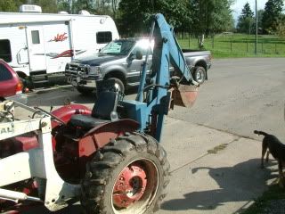

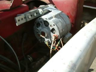

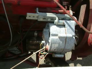

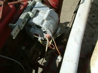

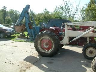

it's been awhile...let's see if i can figure out this photo hosting thng again... AND, I threw in 2 pics of my new backhoe attachment.
/ IH B414 alternator converted..need info #9
The white wire going to the stud is the output of your alternator. It looks a little small, but that is probably not what is keeping the battery from charging. It needs to have a path to the battery. It can connect to the heavy battery cable at the starter. If you have an ammeter it should connect to it.
As some previously stated, the block mounted on the alternator, is your voltage regulator. The broken wire is probably what is causing your problem.
Can you post a picture showing the broken wire?
Also are there any markings on the voltage regulator. Typically, you will have a terminal marked "F" that connects to the field terminal on the alternator( one of the wires in the square plug at the back of the alternator), A terminal marked "A" that goes to the battery( from the picture it looks like it might be hooked to the output terminal of the alternator this will work, but it would be better yo go to the battery), and a terminal marked "S" that needs to go to the ignition switch.
Stan
thanks Stan. YES, the white wire is too light duty and it is broken. I know that one should go to the + batt terminal. There is also a faded red or orange wire that should go from the regulator to the alternator (i think) that is also frayed and broken, and then there is a plug hanging off, that seems to connect to nothing. I don't recall any ignition wires.

Whaddya think of my neighbour's homemade backhoe? he built that from scratch!!
Sorry in advance if I'm slow to reply, as I have to leave for a week, and then I'll try to re-check then.
/ IH B414 alternator converted..need info #11
would never have guessed it was scratch bilt.

the alternator you have there is called 10dn delco this was the pre 10si delco alternator. these units were all externally regulated new. if you can find a alternator rebuilder in you area call them and tell them you need transpo part number d713l this was designed to take the 10dn from ext regulated to internal per say it bolts on and has the plug that goes directly to the back of your alternator for hook up it has three wires that have to be hooked very simply positive negative and one the runs a light if need be. if by some chance you cant get one there just post that i will put in touch with a company there that can supply.
