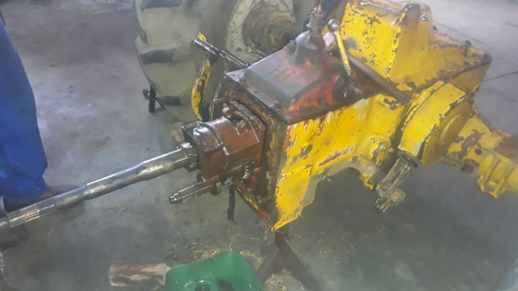

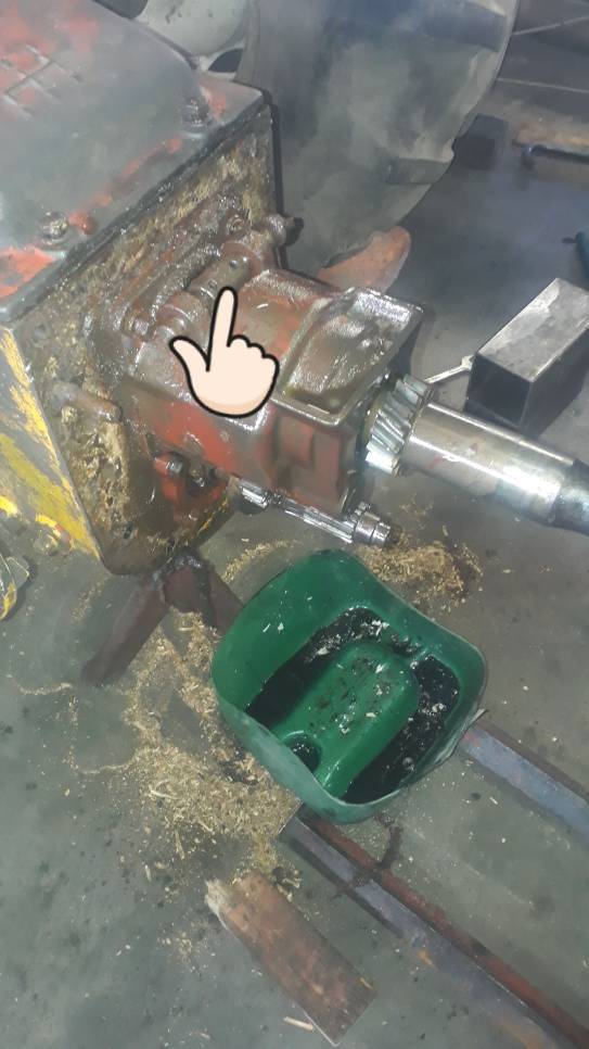

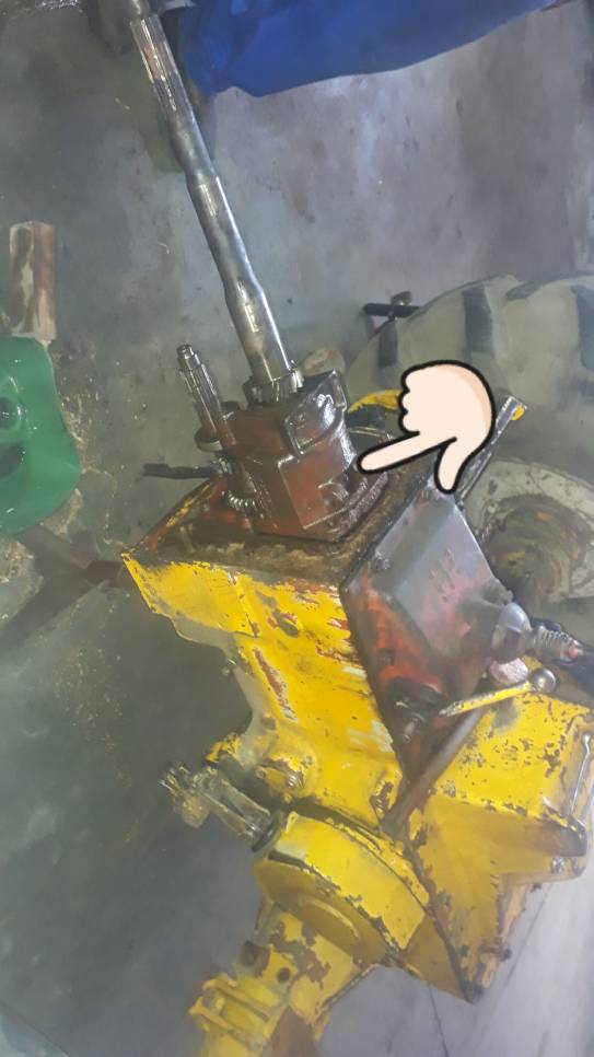

The forward reverse shifterfork broke and that sliding gear is worn .
Where can I find those parts in South Africa ?
/ IH 3434 the yellow one
#2
That parts I am looking for is in that case mounted to the diff casing. IMG-20180928-WA0015.jpeg

I read posts that suggest it's a modified IH434 made in the UK.. I'd suggest asking here, they have quite a few parts for that model, you'd have to ask them for help sourcing the parts you need. Case IH 3434 (Industrial) parts | UK branded tractor spares the same shifter fork and sliding gear were probably used in several models, and possibly by other manufacturers, since it saves huge costs not having to redesign parts for each model, and stock them.. btw, the shifter fork can be repaired by a good welder, checked by a machine shop, and then properly heat treated, the sliding gear can be made by a machine shop with a gear mill, then properly heat treated, it's cheaper to find these parts already made though..

Today I spoke to the previose owner of our local tractorscrapyard and he went and show them where those part is .
Am I lucky or not !
/ IH 3434 the yellow one #13
Am I lucky or not !
yes, lucky this time. it's a rare orphan, and junkyard parts for that won't last forever.. made in, or for the UK.. then discontinued..
