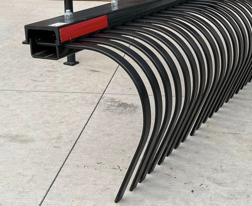

Any experience with Compact Equipment Attachments & Implements | Ignite Attachments ? I can't find much/any folks owning them here.
I am comparing a 72" landscape rake; ignite is about half the price comparted to some of the other made-in usa, real close to import prices. Their design looks quite simple (not a bad thing). Out of all my attachmemts, the rake might actually see actual abuse (clearing vegitation for makeshift fire breaks)

They seem ligit, with positive unbiased reviews on OrangeTractorTalk and GreenTractorTalk. The 3rd party photos also seem to show a reasonably well made rake.
I have no direct experience with them, however.

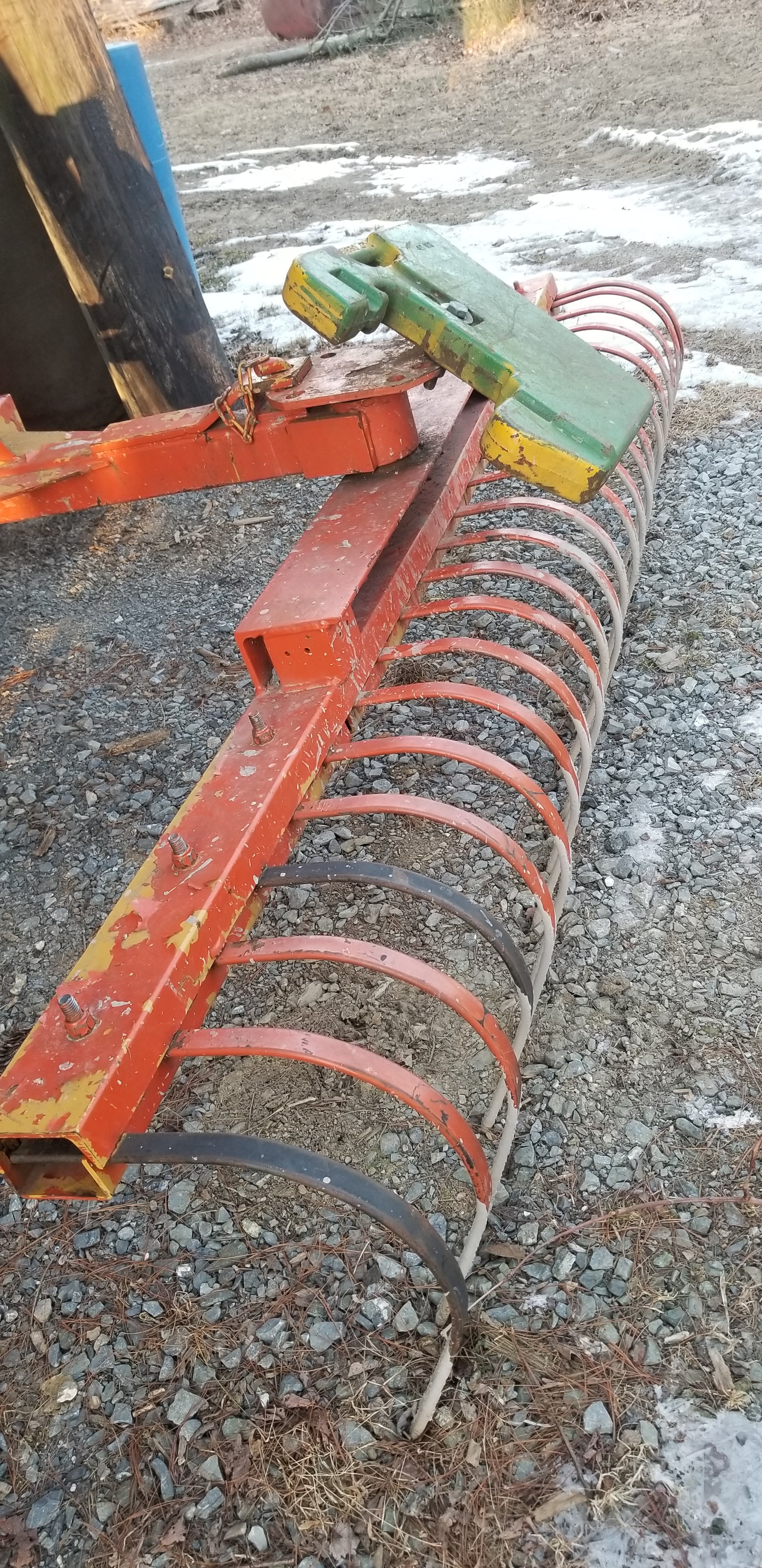

The problem I see with this style rake is theres no support for the beam holding the rake teeth. The outer teeth will make that whole piece of C channel twist. This happens with the cheaper ones too. It can be fixed as I did this with my TSC rake.
My well used and abused 72in rake. I have every other tooth removed to make it work more like a rake vs a blade and always have the 100lb suitcase weight on.

Regarding the tine bar on IGNITE Landscape Rakes, it is quite substantial, so I've not seen one bend.
