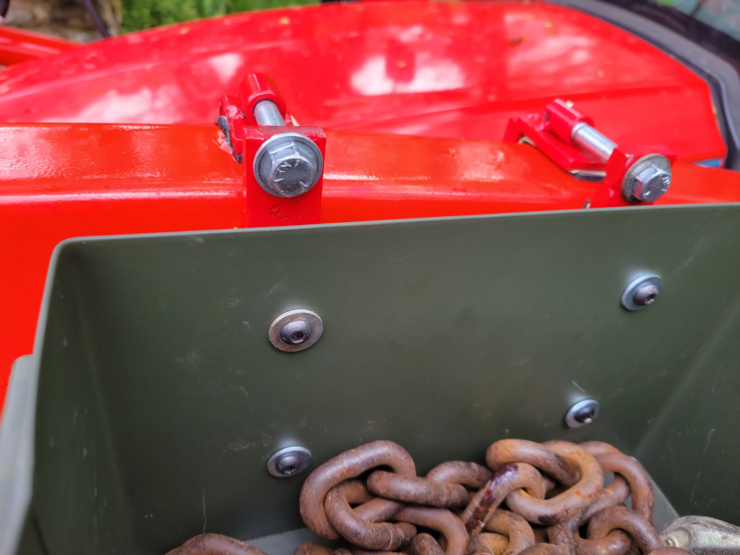

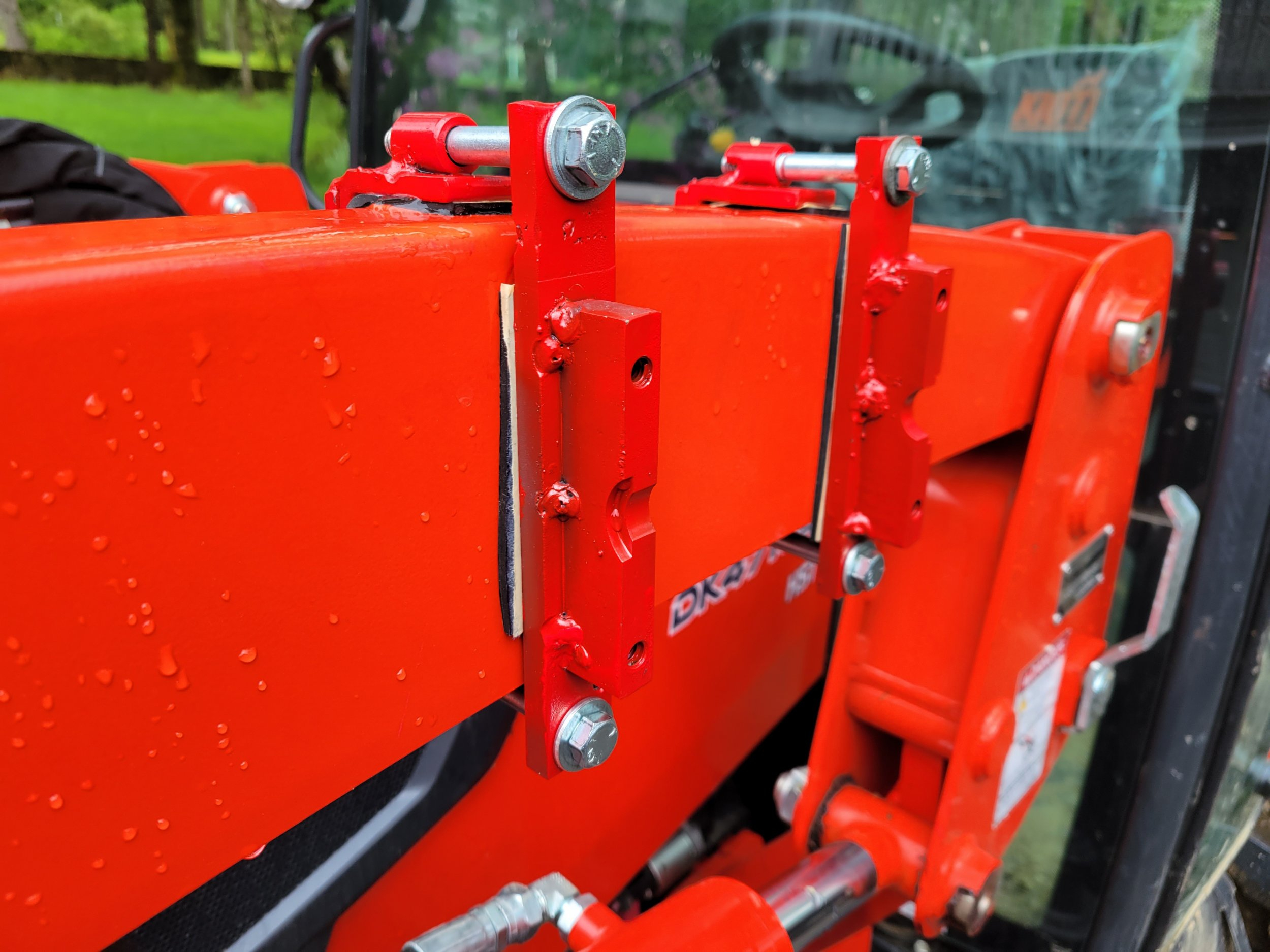

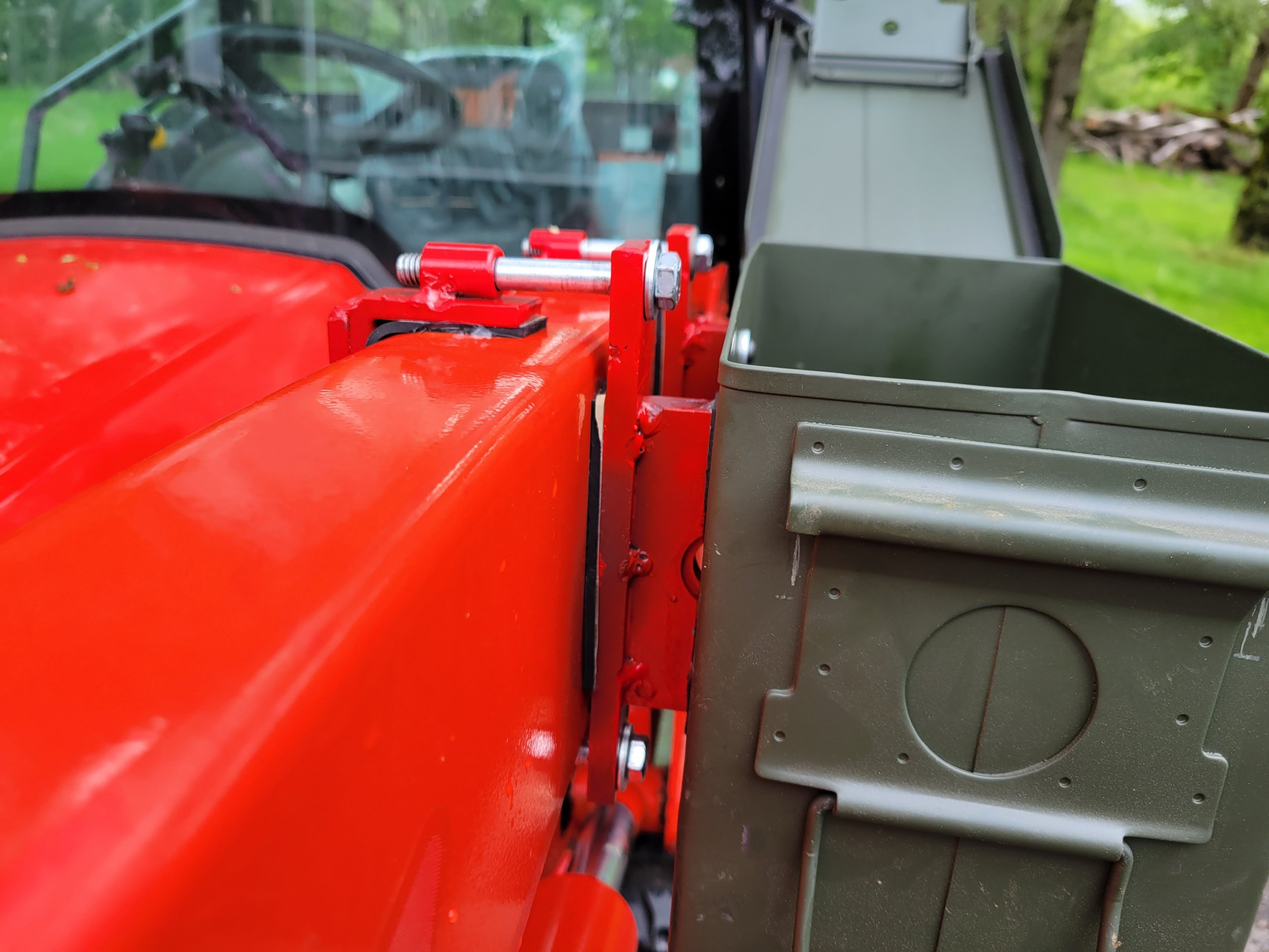

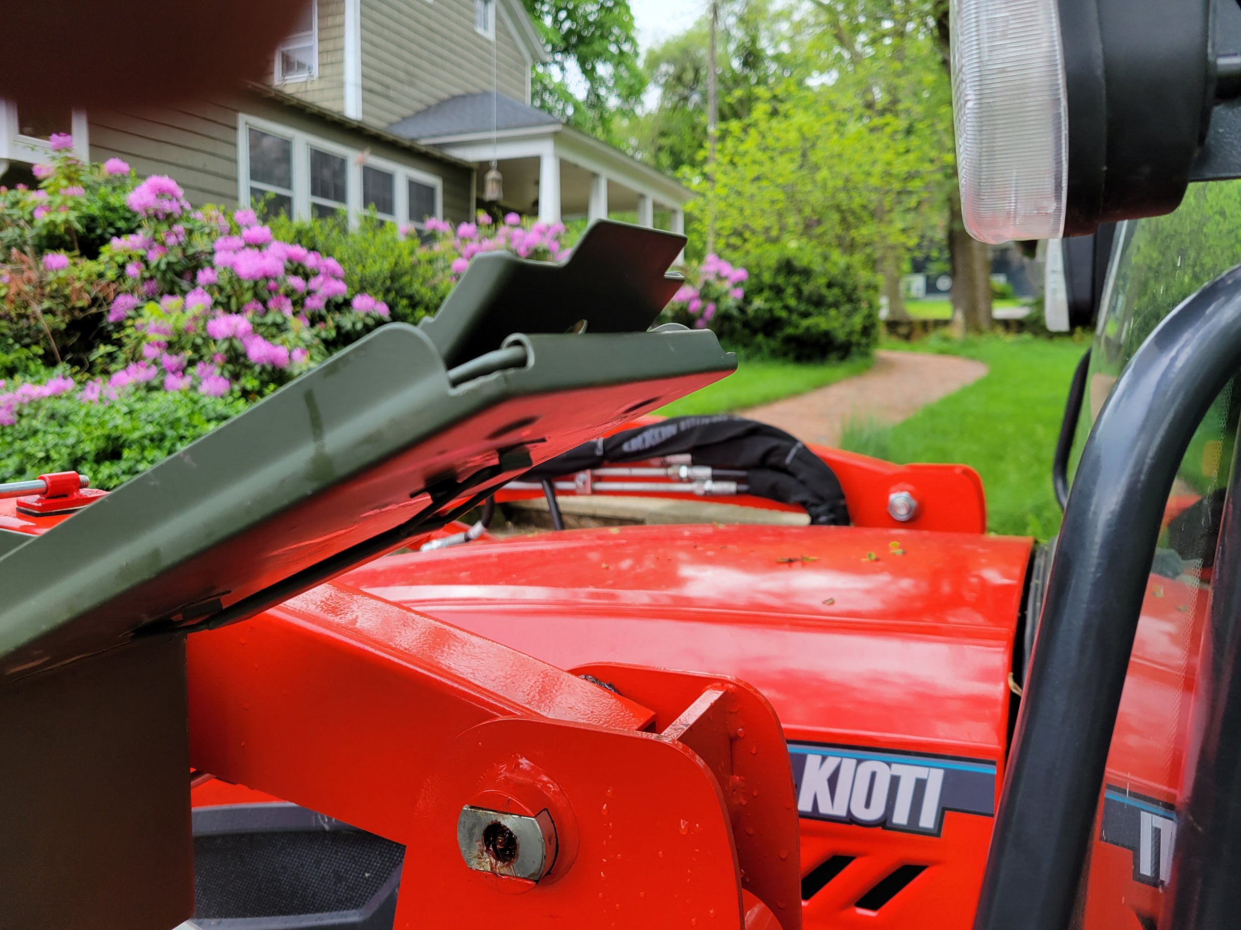

a lousy clamp for a lousy box to put lousy chains in. It's mostly made from scrap.
8 Helicoils with detents so it shouldn't work itself loose.
No one will ever accuse me of being a welder.

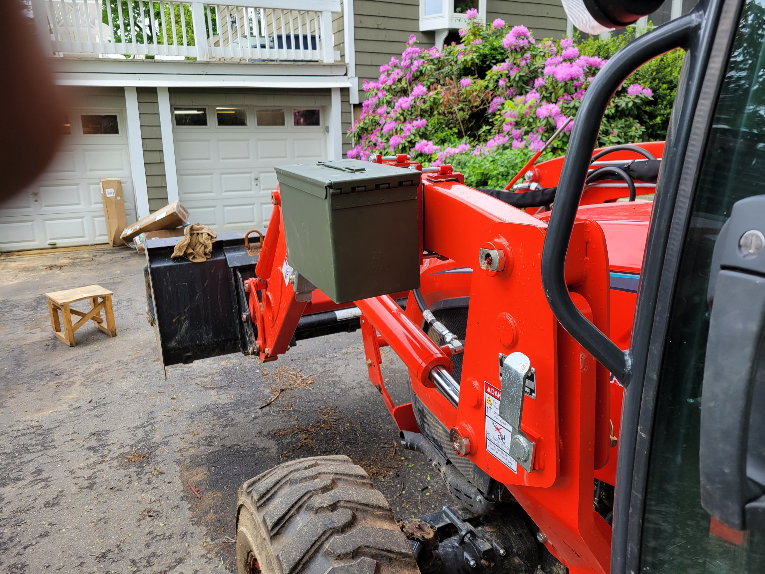

Haha, not bad!
Does it... .dump itself every time you lift the loader all the way up, though? Why not mount it somewhere... fixed?
/ If it's worth doing it is worth overdoing #6
You guys got it wrong.... that's for the self dumping feature ! Easier to pick up the chain off the floorboard than take it out of the box......:unsure::unsure::unsure:
Just kidding.... a very nice job for sure. Were there supposed to be poor welds in the pictures? They work, they hold, can't see them when the box is on.... GOOD TO GO!

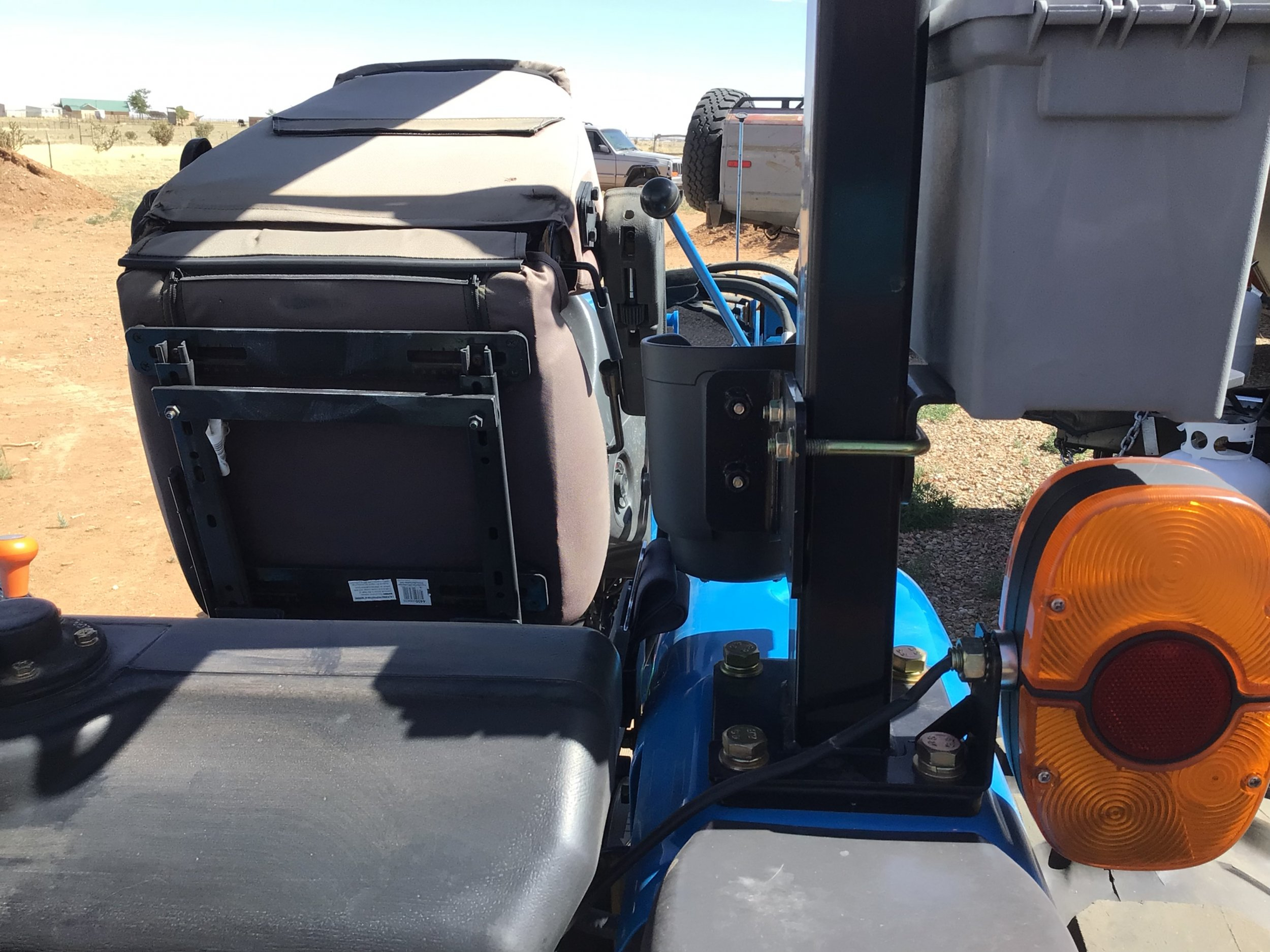

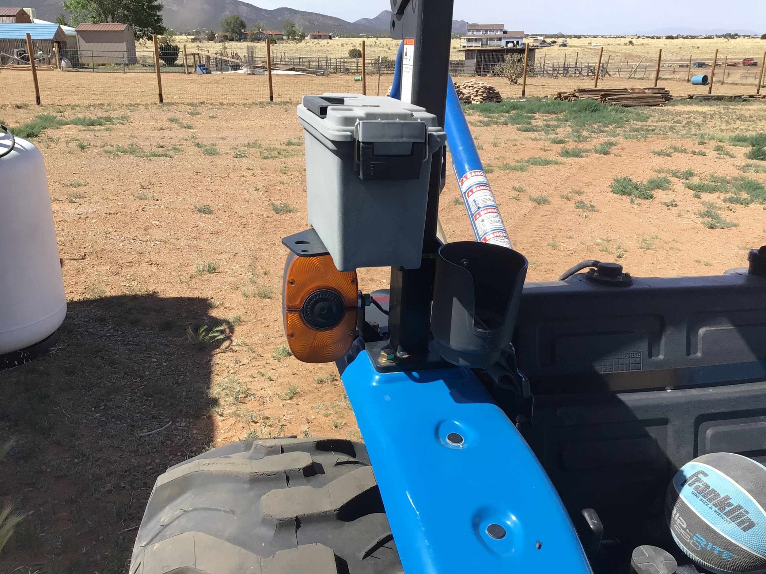

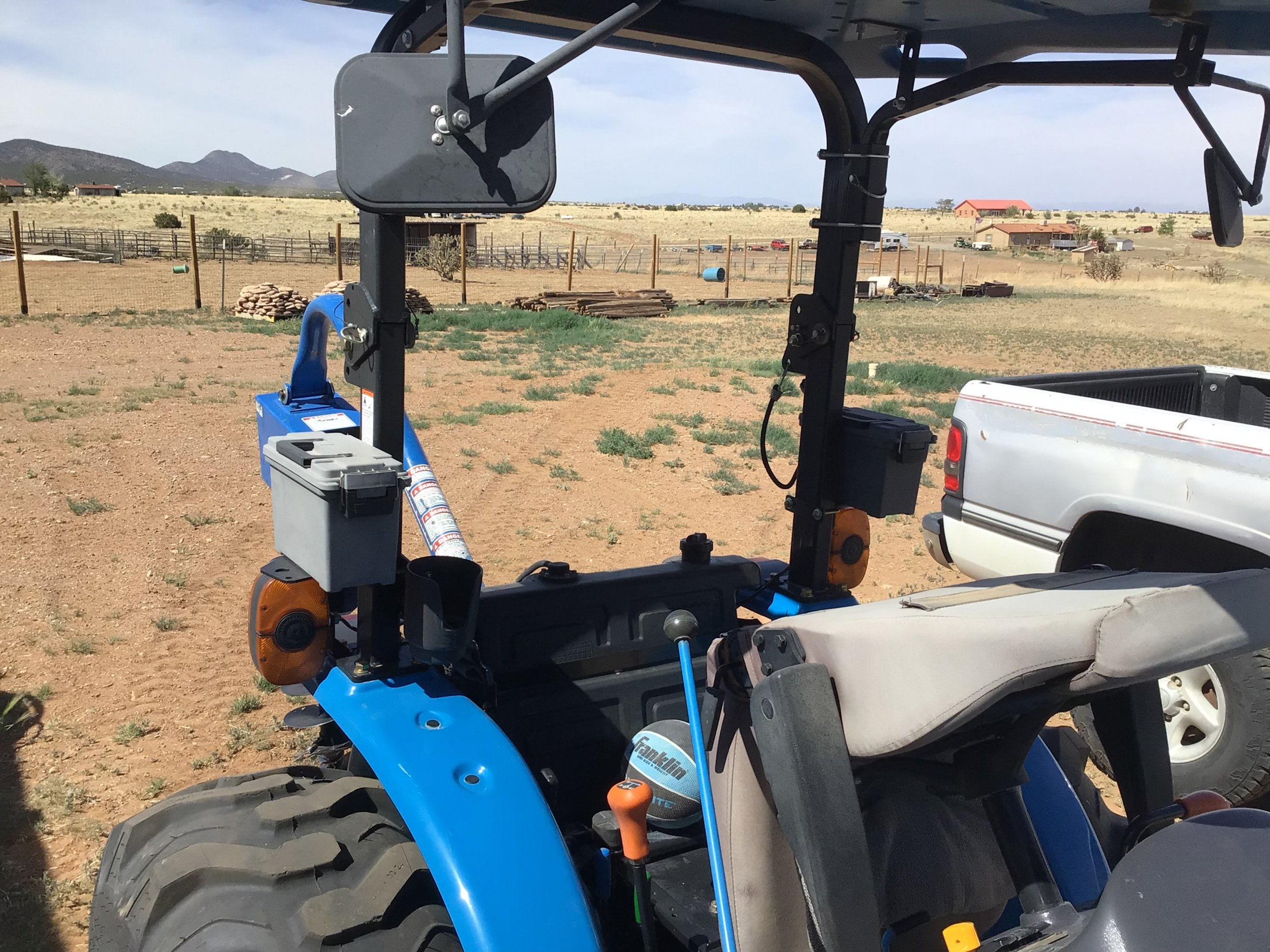

Here's a few pics of mounting tool boxes to the ROPS. The plates holding the boxes are bigger than the cheap plastic HF boxes. My intentions are to get the boxes like you have. These were just laying around and used as a 'prototype'.
A442F219-CB69-4F23-A10B-F318C795A2E4.jpeg4C129A07-EC64-4598-B88A-F197E8B04E8A.jpeg5F3299D2-E6E5-4804-8415-AA61A41BF283.jpeg
They work for me as is, so until they break, I'll use them as is.

While it shouldn't come off, I would have mounted it the other direction. Would stay closed easier. But I wouldn't have put it there in the first place either. I think it is way too high. Stand on the wheel to put the chain back up or get it out? But it's your machine, not ours. Thanks for posting, I like mount.
/ If it's worth doing it is worth overdoing #11
It all looks great. The paint helps the welds. Cosmetics are important after all :) I really like the use of the rubber sheet. I have some rubber sheet left over from a job I did years ago and it is still in very good shape and your post reminded me that I still have it. Thanks. . I want to add a couple chain boxes and the mounts will be clamped to the ROPS. Using rubber sheet like you did will make the mounting much better.

Sure don't, good point. That only removes the ROPS idea, though.

Nice, but... The brackets need grade 8 bolts...

Dad's solution on our old 3020 John Deere for mounting a box.

6x6” square tubing carries chains, chainsaw, long tools, buckets, gas and oil. Provides skid protection for loader control valve and hoses. Have ammo can too for tractor pins and tools. Carrying tools safely to work with is a necessary part of our farm operations
