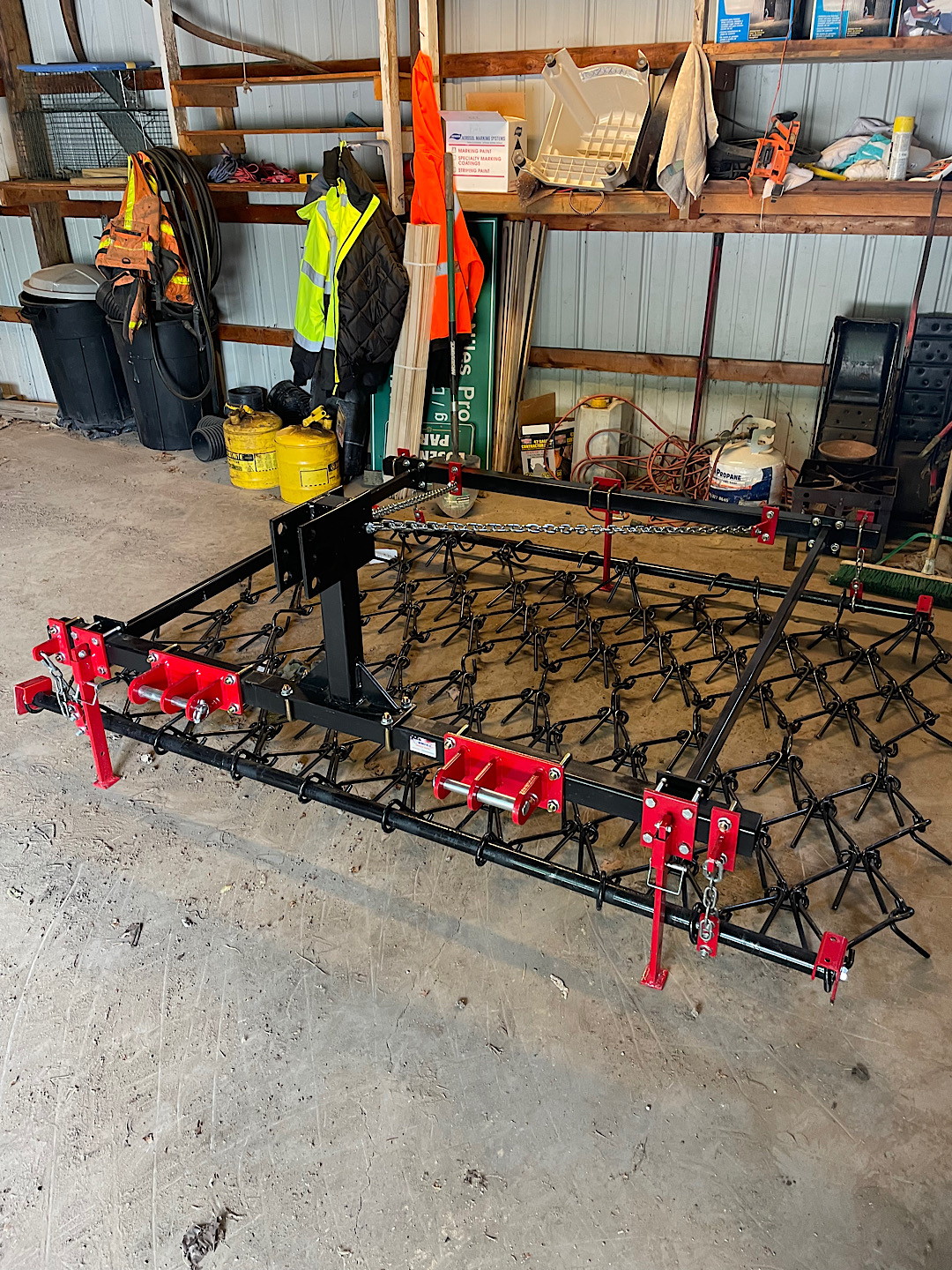

Tractor + this + chain harrow when you don't need the LPGS.

I recently bought a business that has approximately 40 acres of gravel lot. The lot sees infrequent automobile use (5-15 cars/day), and less frequent use by a seventy-ton capacity Marine Travelift carrying up to 80,000 lbs of boat (up to 4 times a day). The gravel lot was in rough shape when i purchased the business and i would like to repair and maintain it. I know nothing about grading but can drive a tractor. If I Only Buy One Piece of Equiptment to fix/maintain this lot, what would you recommend? I've thought of perhaps a tractor/box blade, or a skid steer ("Bobcat"), or a backhoe, but am not experienced enough in grading to choose intelligently. If you have a recommendation, could you please include model and/or minimum horsepower. Oh, i should maybe mention the lot seems to have undergone some haphazard repairs along the way. There are spots with #57 slag, fine slag, fist-sized concrete chunks, #8 stone, sand, etc. Any help you can provide would be greatly appreciated.
I will throw in my 2 cents.
#1, a good sized compact tractor. Not a sub compact. It will be more versatile across your needs.
Things to look for:
#1, weight. You are looking primarily for "ground engaging" uses. This takes torque and needs weight to apply that torque to the ground.
#2, get a shuttle shift transmission. Not a hydro. Same reasons as above. Yes, lots of folks will chime in with storied benefits of a hydro transmission. However, simple facts are that a solid gear will out pull a hydro all day long. If you are grading 40 acres, that is serious work on a transmission. You can look on YouTube, there is a kubota dealer who did a pull test with 2 similar tractors. Hydro vs gear. NO comparison!
#3, fill your tires with rim guard. It's not expensive and will make a WORLD of difference in your stability and traction.
#4 look at frame size/ weight more than HP.
My 36 hp tractor with loader and filled tires weighs 7,000 lbs. But there are sub compact 32-35 hp "tractors" that weigh around 1700 and would not even pretend to pull the land plane that you will need.
#5, RENT.
Go to the local rental store, rent a compact tractor and landscape rake for a weekend for $200.
Just see what you think.
If you can find a land plane to rent, do that too.
It might help you choose what you want, and just as importantly, what you don't.
