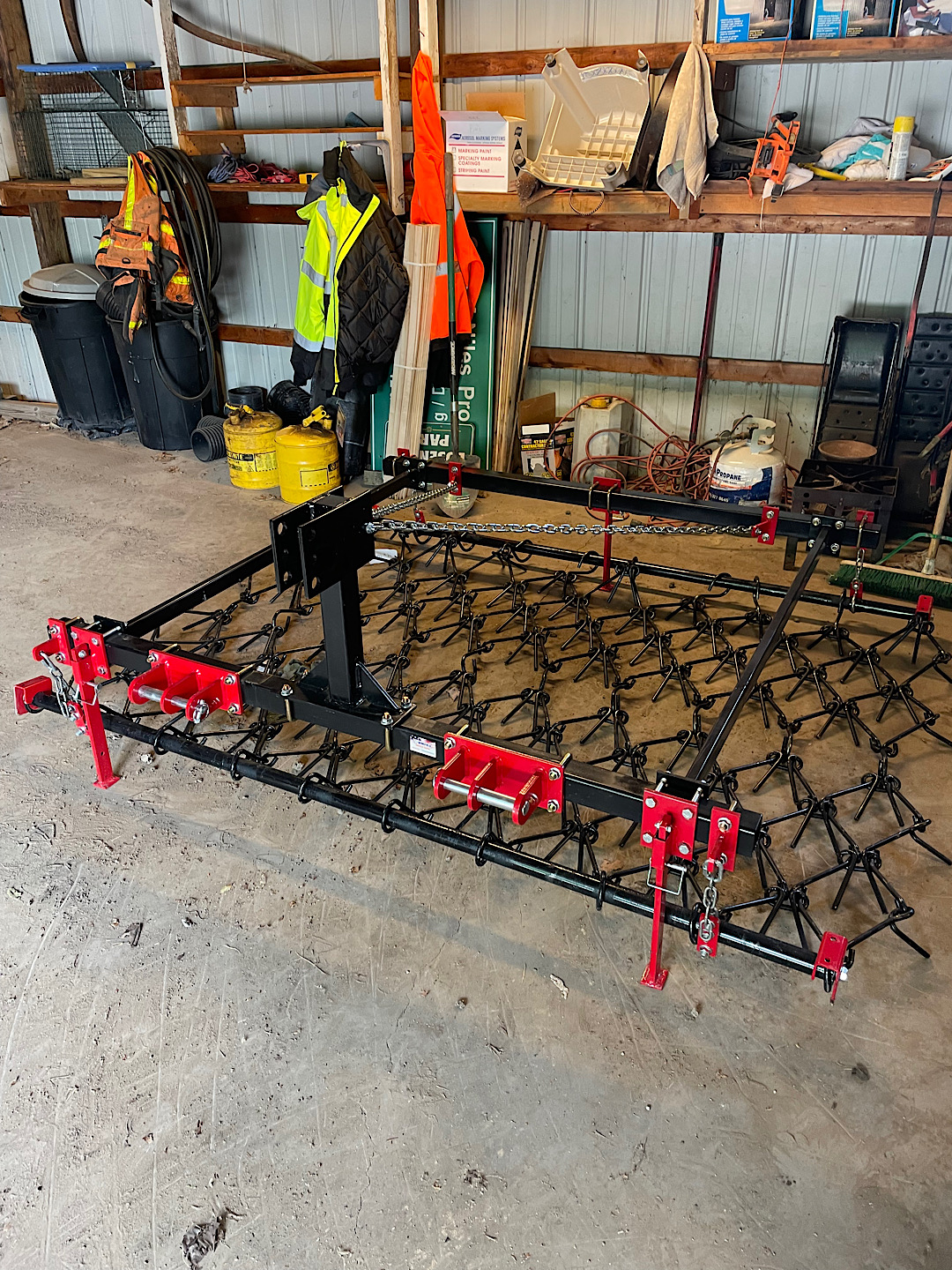

Using the 8 ft model, it will take you about 12 hours to make one pass on 40 acres. I normally make 2-3 passes on my driveway. That is a lot of seat time but the unit is less than $2500.
I use a 72" unit and have a 40 hp machine. With the 8 ft model I suggest a 50-60 hp tractor.
The advantage of the leveler is almost no skill or training is needed. Hook it up, and drag it around.
