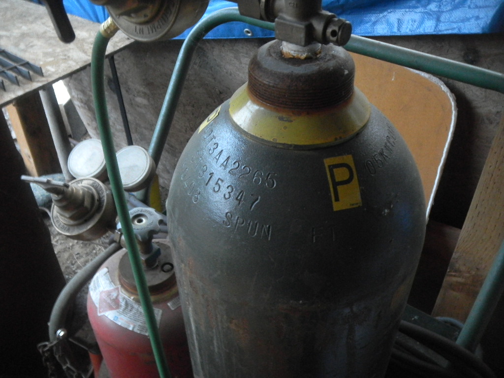

Ok, here's what I've found
Oxy tank #1 is ~7" x 45" to where cap would thread on. It says Union Carbide Linde Div. It has 10-72+ 10-85+ numbers, and UN1072 on sticker.
Oxy tank #2 is ~8.5" x 51" to where cap would thread on. It says "Property of National Cylinder Co" and has 5-56+ 6-61+ 7-65+ 8-76+ 9-60+ numbers and a 2A-8335.
Acetylene tank #1 is 5.5" x 18" and has no threads for a cap. It says "The BOC Group" and says "to be refilled at BOC gas authurized facility only". Googled it, and said BOC Gas was defunct in 2006. Also says Airco on paper sticker
Last Acetylene had nothing other than a part of a paper sticker saying acetylene.
Regulator says "Prest-O-Lite" and Torch says Smithfield Equipment.

The X-XX numbers on your oxy tanks are hydrotest dates...those are some OLD cylinders. The first number is the month, second is the year.

Looks like a type-K and a type-S oxy tank per airgas size charts.
/ Identifying Oxygen/Acetylene Tanks #16
Do some phoning around first or go to the welding supplies(without the cylinders) and find out what size of cylinders you have. If it says Union Carbide, that's Praxair and they don't usually sell larger cylinders, only small ones up to about 80 cu. ft. Same thing goes for BOC that is now Linde. Yes it's confusing because the Linde is the same Linde as on the Union Carbide cylinder but they are 2 completely different companies. Linde was the first or one of the first to figure out how to separate air to get pure oxygen. I'm in Canada so there may be different rules where you are. Worst case is you need to take out a lease. Even if the cylinders weren't supposed to be sold, they might be useless to you. If that's then case, I've heard you can remove the valves and sell them to the scrap dealer. I wouldn't mess with an acetylene cylinder though. Just need to do some checking first. Sometimes cylinders are stamped COP-customer owned property.
