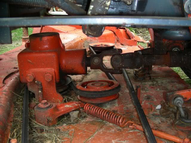

I just got my "new" B7100 HST E as described in another thread. I'm trying to identify the MMM on it, of which the label is partly gone. I can read RC60-7 but the rest is missing. I did some research and I am guessing it is either an RC60-71 which was native to the B7100 or perhaps an RC60-72 that was adapted. There has been lots of welding and things clearly don't all look original, so it's hard to tell. Perhaps someone who knows these decks can identify it from the pictures below or tell me what other information or pictures would nail it down. Many thanks!

Maybe one of these parts manuals will help your ID it.

Thanks--I found two parts lists for RC60's there, one an RC60-72B and the other and RC60B. Neither of these is quite a match, but it's helpful to have those and to at least move in the right direction by process of elimination!

I've got an RC60-72H and yours looks nearly identical to mine without the belt covers on it.

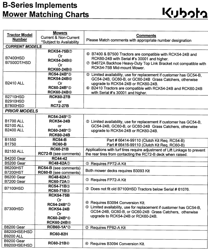

Not sure if this is of any help...

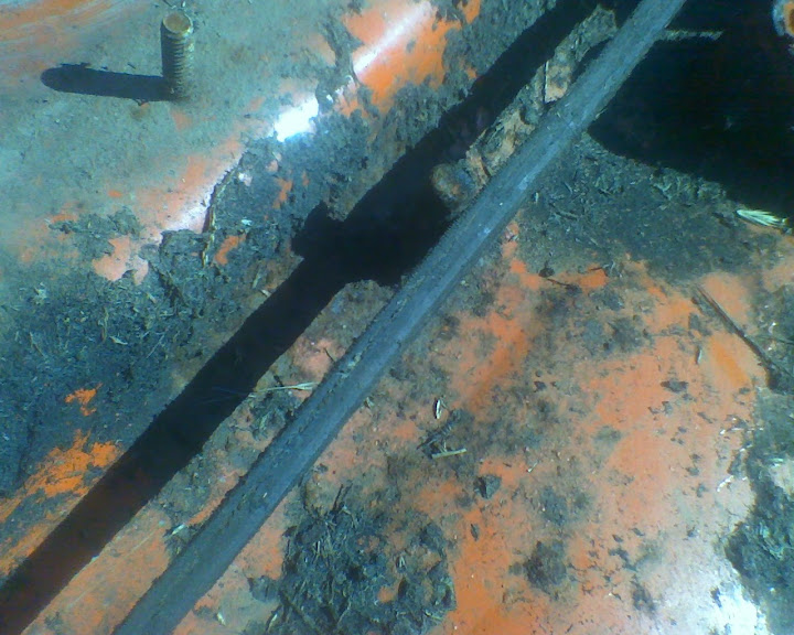

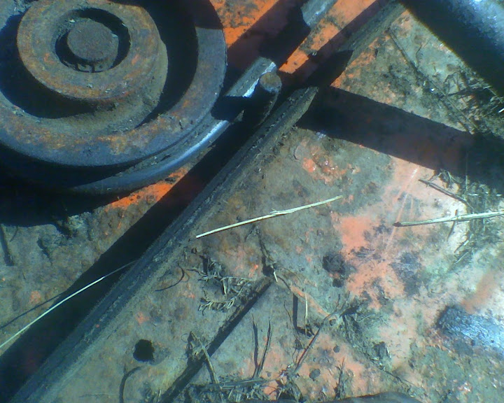

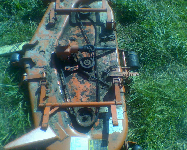

Here are the pics of my deck. Sorry for the quality - all I had was the camera phone, and it's awful sunny out here. The first pic is the deck itself, covers off. The next two are the two bolt thingies that I would think should have rollers or something, since I would think that the belt will rub against them. The belt that's on there is the old broken one that I was experimenting with.

My best guess is that those are guides for the belts, and maybe also help hold the belt guards up off of the pulleys, but that's a guess and I'll defer to those here with more experience.
There are guides like that on my riding mower that help keep the belt in place when it is slack, which it is when the deck is disengaged, but the deck on these is engaged and disengaged with the pto clutch, so the belt would never get as slack as it does on my riding mower. Just my two cents.

I have the RC60-71B on my B7100HST and this is not the same deck.

Here is a picture of mine, showing the belt routing and the posts you are wondering about. Hope this helps.
With the belt tight, it doesn't contact those posts it seems.

that doesn't look like my RC60-71 mower. I recall two different kinds (different years maybe) and it seems like i'm the only one that has the kind I have.
Yours doesn't have a front piece like mine and the others - it would connect the front of the mower just above your center mower wheel/roller to the front pivot/spring loaded pin on the front of the tractor. although without that mine doesn't raise and lower as well so maybe yours is supposed to have that?
also mine has 4 posts at each corner like yours has on the front corner only.
since mine wasn't hooked up right i posted a thread a year or two ago on how to hook up all the brackets, lifts, and stop links. others posted descriptions and pictures there, all of which were different than mine - because i think there's two different styles. anyway, might want to check that thread out for info/pictures. i'd look right now but my internet connection is terrible.
the B6100 is a very similar mower, maybe it's one of those? no other identifying numbers on it?

Bluelick, unfortunately I can't see your pictures. However, the mower in Cotton Hill's picture is an RC60-71H. Everything on it is as it is supposed to be. The guide pins do not have any rollers on them. They are just there to reduce belt flapping.
