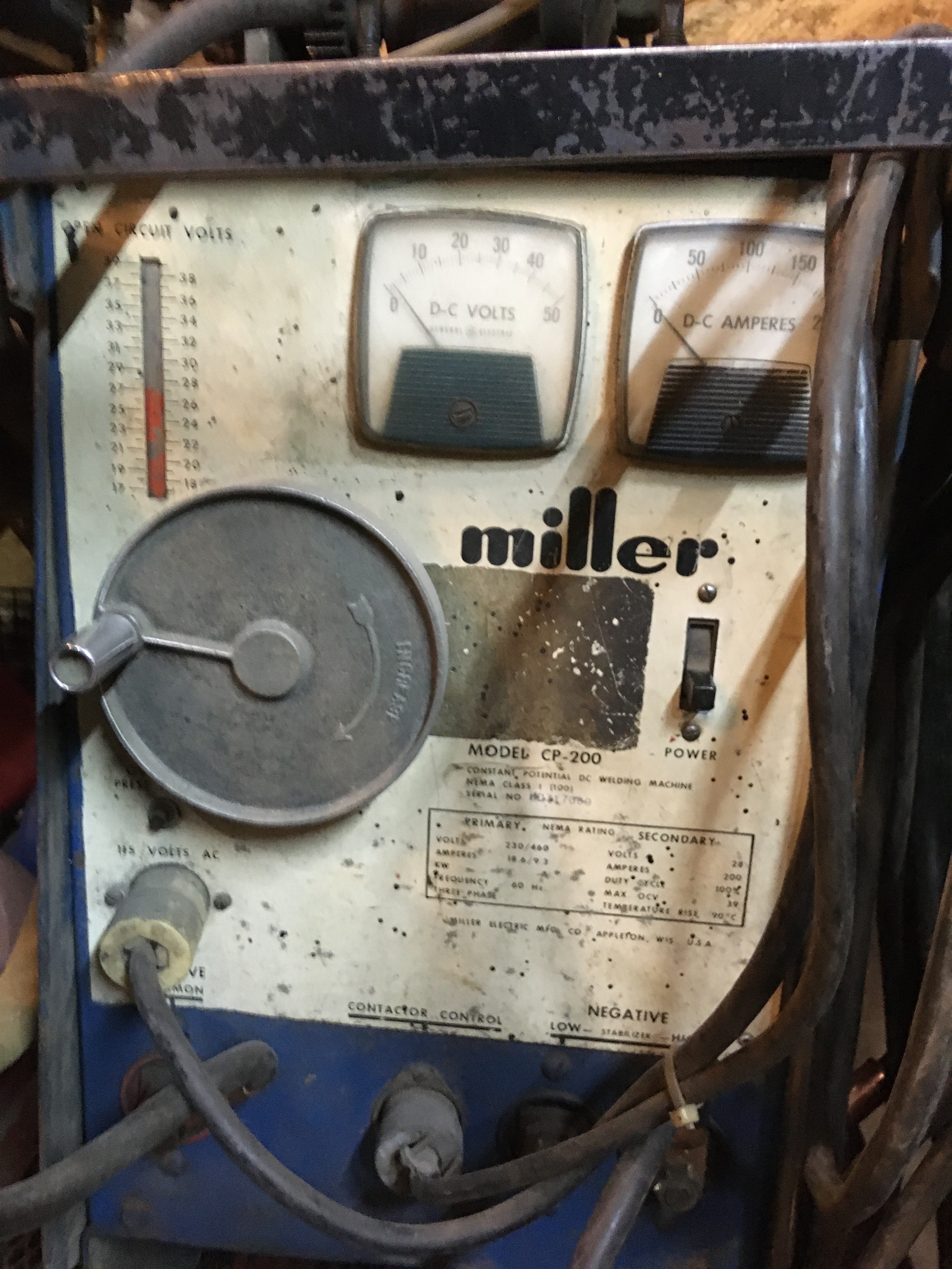

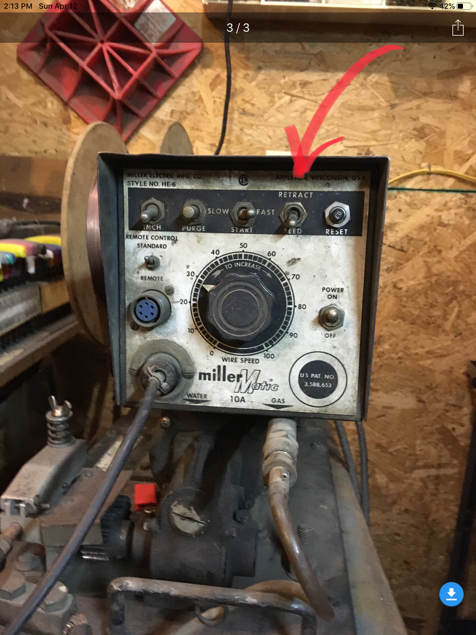

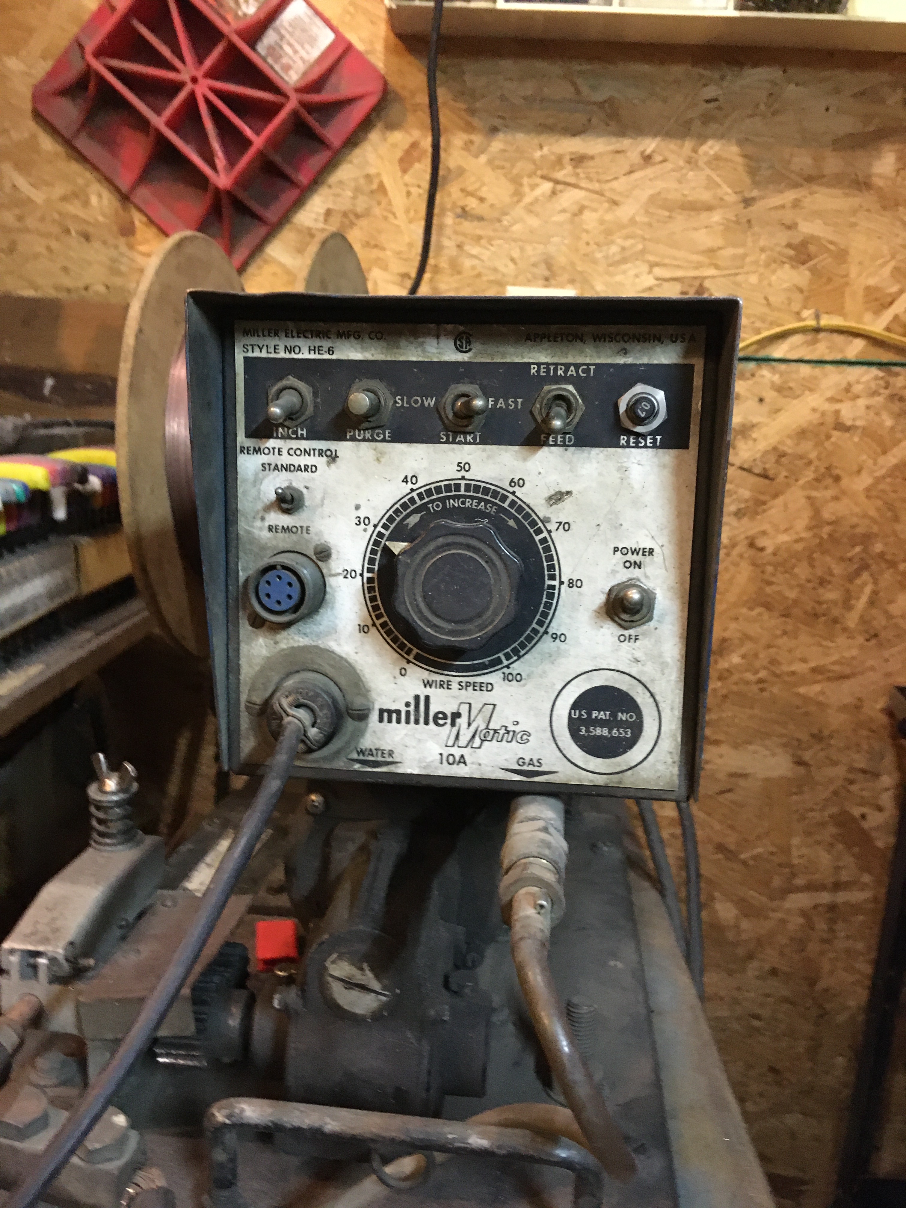

Well I finally got pics. Thanks for the help and encouragement. The ham was OK, the creamed potatoes great as always, and I'll have to go back later for dessert. We got Gary going on CO2 and he was late for dinner, not wanting to put the MIG torch down. His feeder is a 10A and draws from the power unit's front panel 115v AC outlet.
I wonder if feeders on/for Pat's CP-300 are 24v DC and he sees that as a reason they wouldn't be plug & play to swap for a 115v. I say that's up to Neil and me to work around. ;) Anyway, I guess these pics will post only as thumbnails in the blue box while the site is still acting up in other peculiar ways. :laughing: Pat may have good news on Monday.

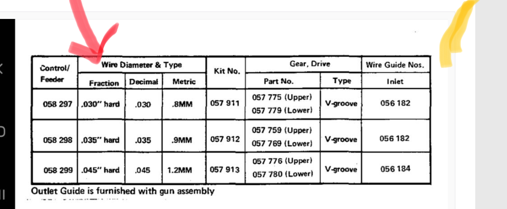

did you look here for the 10a?. Manuals & Parts | MillerWelds the manuals and part numbers are there, I just saw them..
I did, thanks. What I found was an owners manual and a parts list with schematics by serial number. So, :cloud9: for a while at least.
Now I have part numbers for individual drive and idler wheels plus 'kit' numbers for both .030" and .035" wire. They get me nowhere online.
