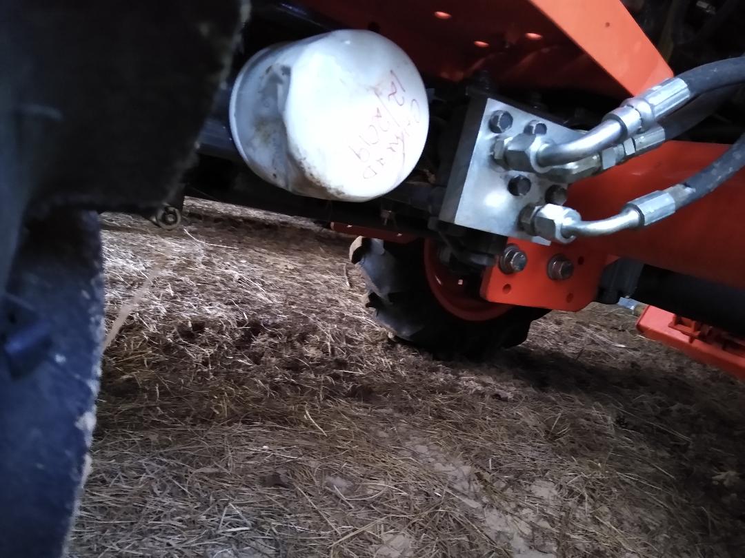

I bent my hydraulic filter for the second time. Completely exposed on the "passenger" side of the tractor.
Anyone have any ideas how to protect it from being damaged?
I was thinking about welding a schedule 40 pipe so that the filter sits within the pipe but I could still get an oil filter socket on it.

I checked a couple of web pages on L3301 but saw no diagram of your predicament. A photo would help.
Completely encircling the filter with a pipe is a poor idea. Murphy is watching! Suppose the plastic or sheet metal "socket" doesn't grip the end of the filter; how would you get a strap wrench on the filter? You might be able to drive a big screwdriver, drift, or bar through the filter walls and turn the filter. Murphy is still watching! Suppose you loosen, tear, taco, or otherwise foul the gasket; you would then be working at the blind end of a pipe.
My suggestion would be a couple of well-braced stout stanchions or at most a half-section of pipe that would allow use of a strap wrench and access to the gasket seat. The protective cover could also be removable.

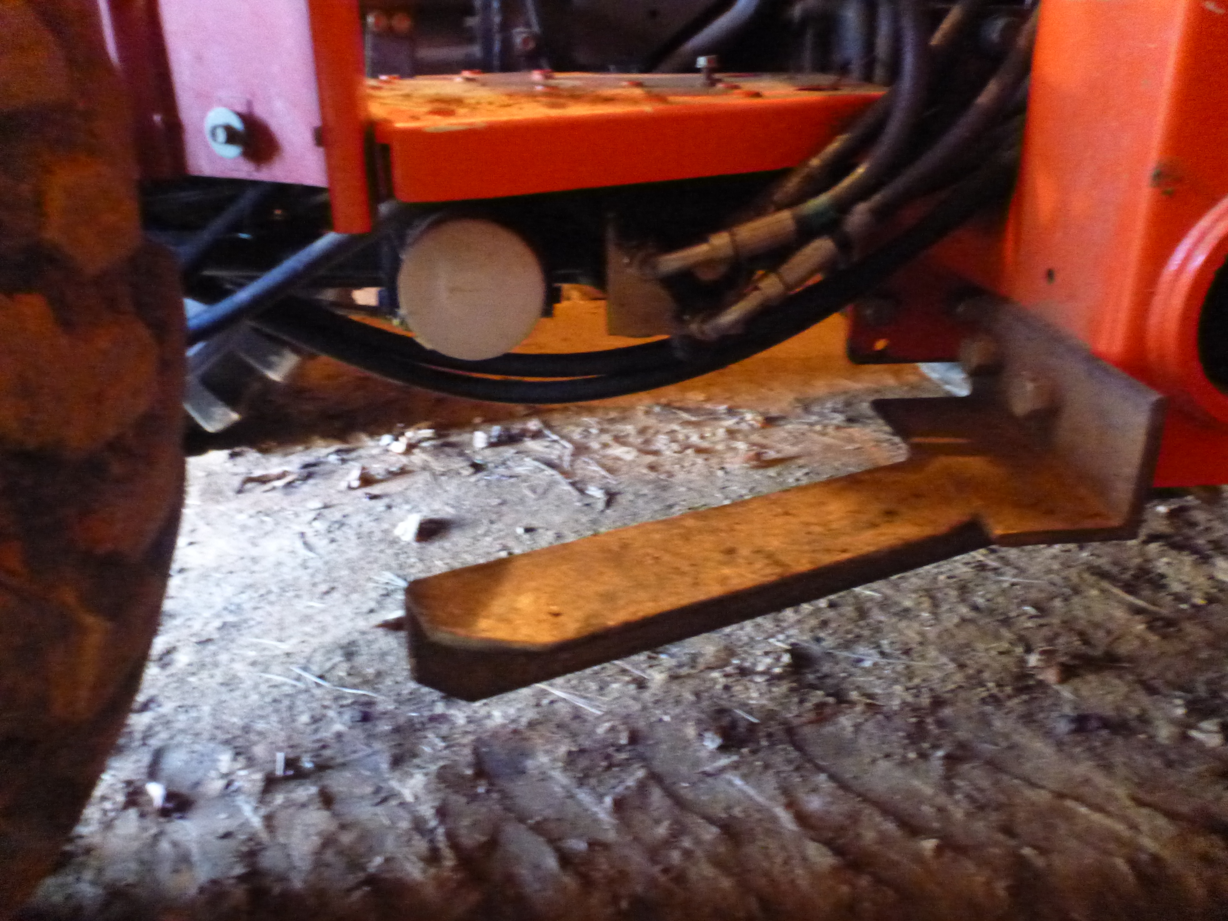

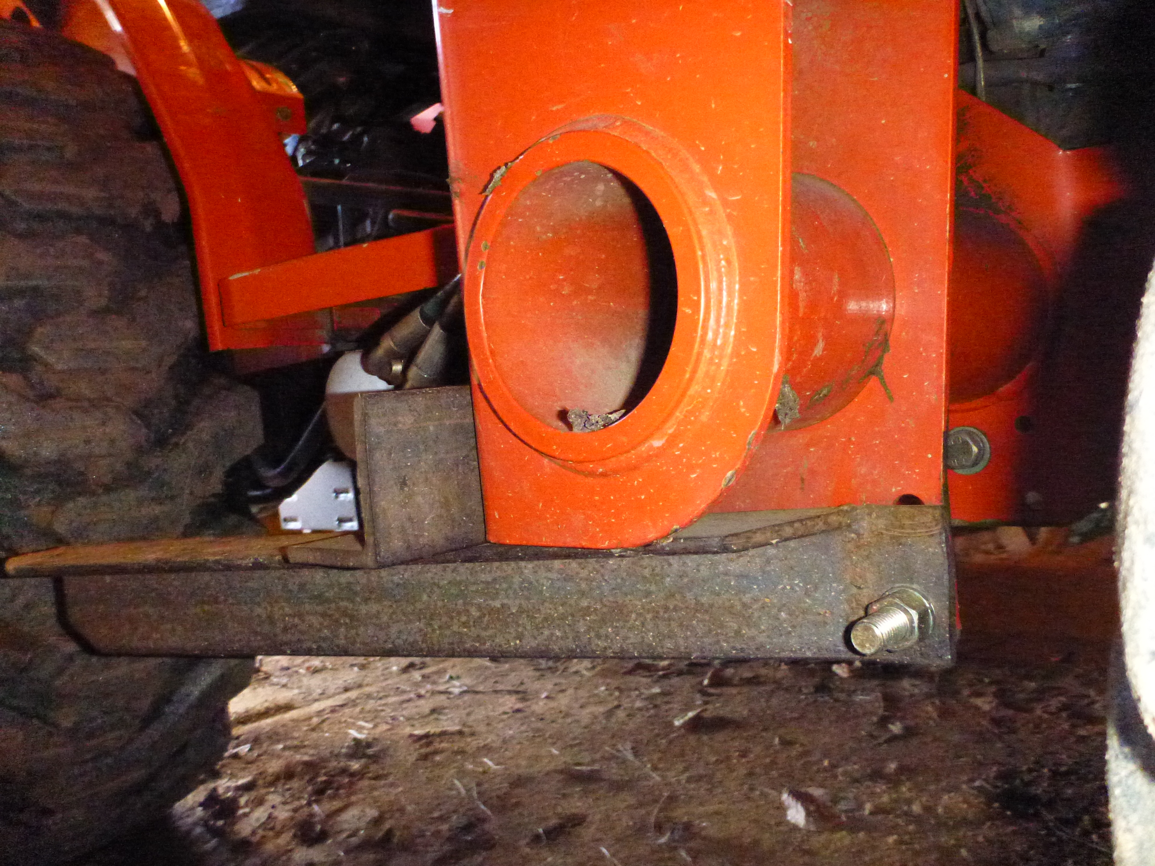

Post pics when you get it. Take pics of the pieces you receive. Then take pics with it bolted in place. So someone else might be able to use your pics to build one.
I built a skid plate around mine that bolts to the tractor trans/rear axle housing. I'm curious how Kubota does it.
