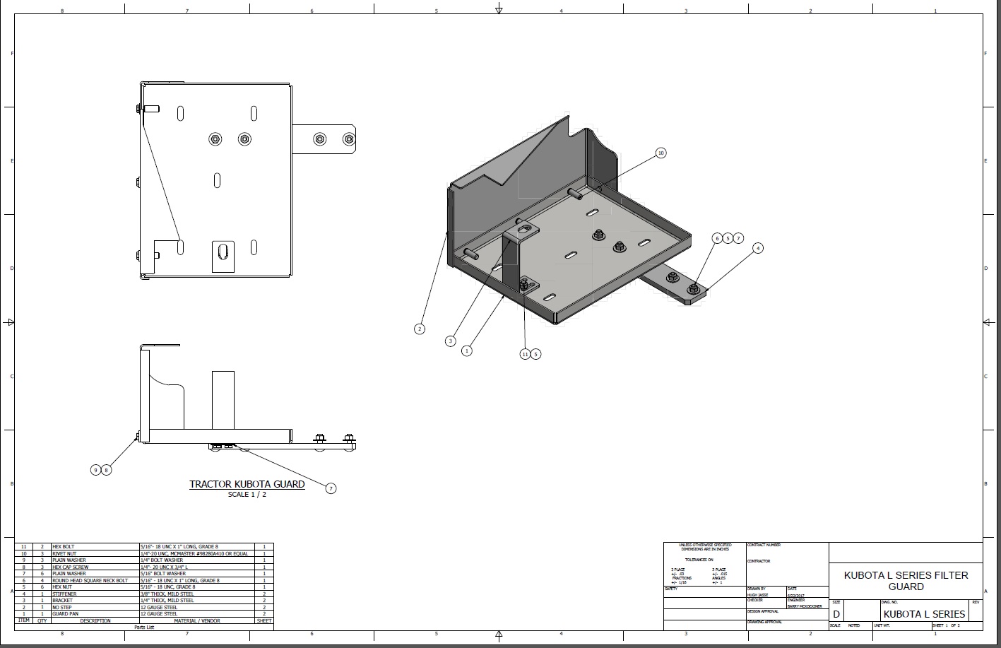

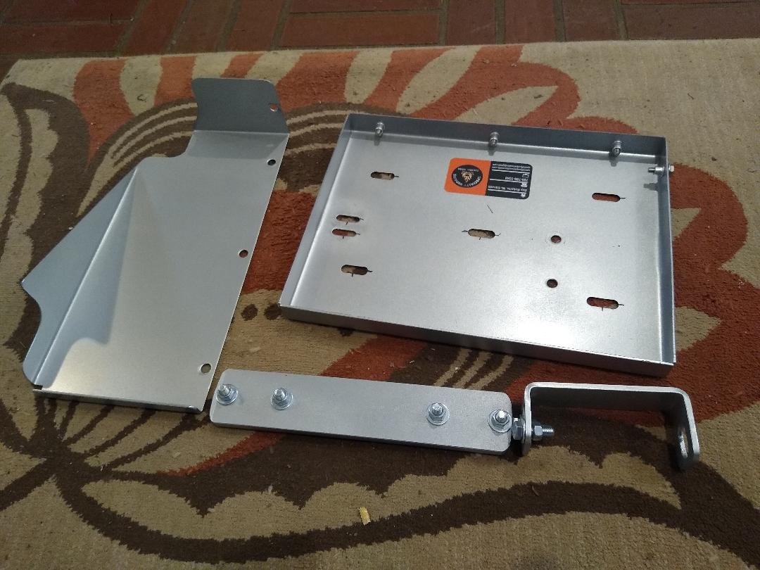

I received the Hydraulic filter and FEL line shield within 7 business days of ordering. It came from Canada and price is $280 including shipping and tax.
Took about 2 hrs to fit pieces on tractor, mark the two drill holes, drill holes and mount shield.
The drawing shows the pieces as they should be installed. The bolts on part 4 will be the holes you will mark and drill.

Nice drawing. Who is the designer? 2017?
Hope you like it. Thanks for your business guys

Ignore the names on drawing. Lol
I was being goofy. I will be ordering the HST guard too

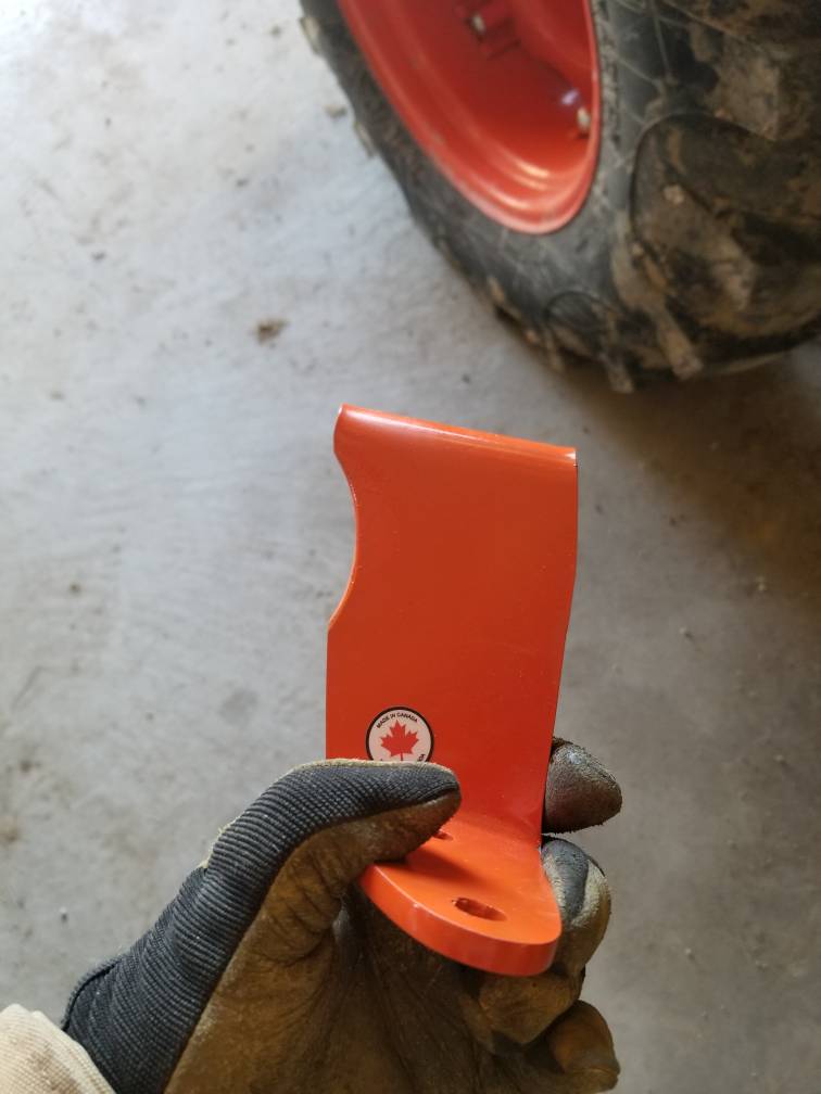

As you are back to TBN & I haven't gotten around to E-mailing... Here is the couple minutes of grinding I did on my QD guard. The inside QD was barely touching when I installed it. Given the heft of that bracket compared to the rest of the guard you may want to trim that bracket down a 1/4" or so in future revisions. Will account for variations or slop that seems to exist.
