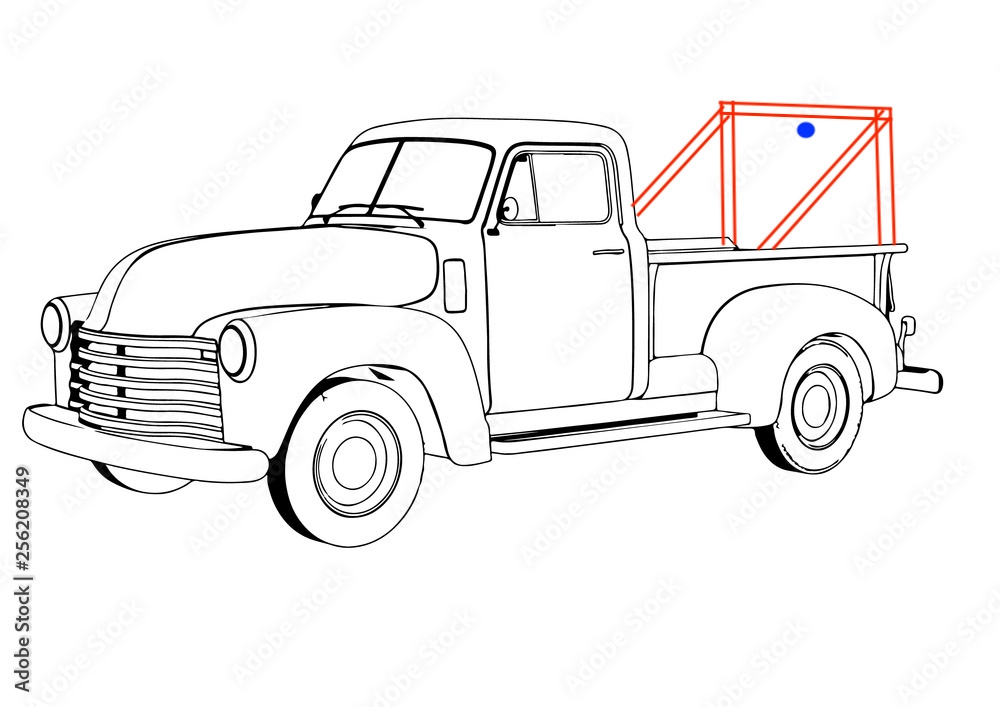

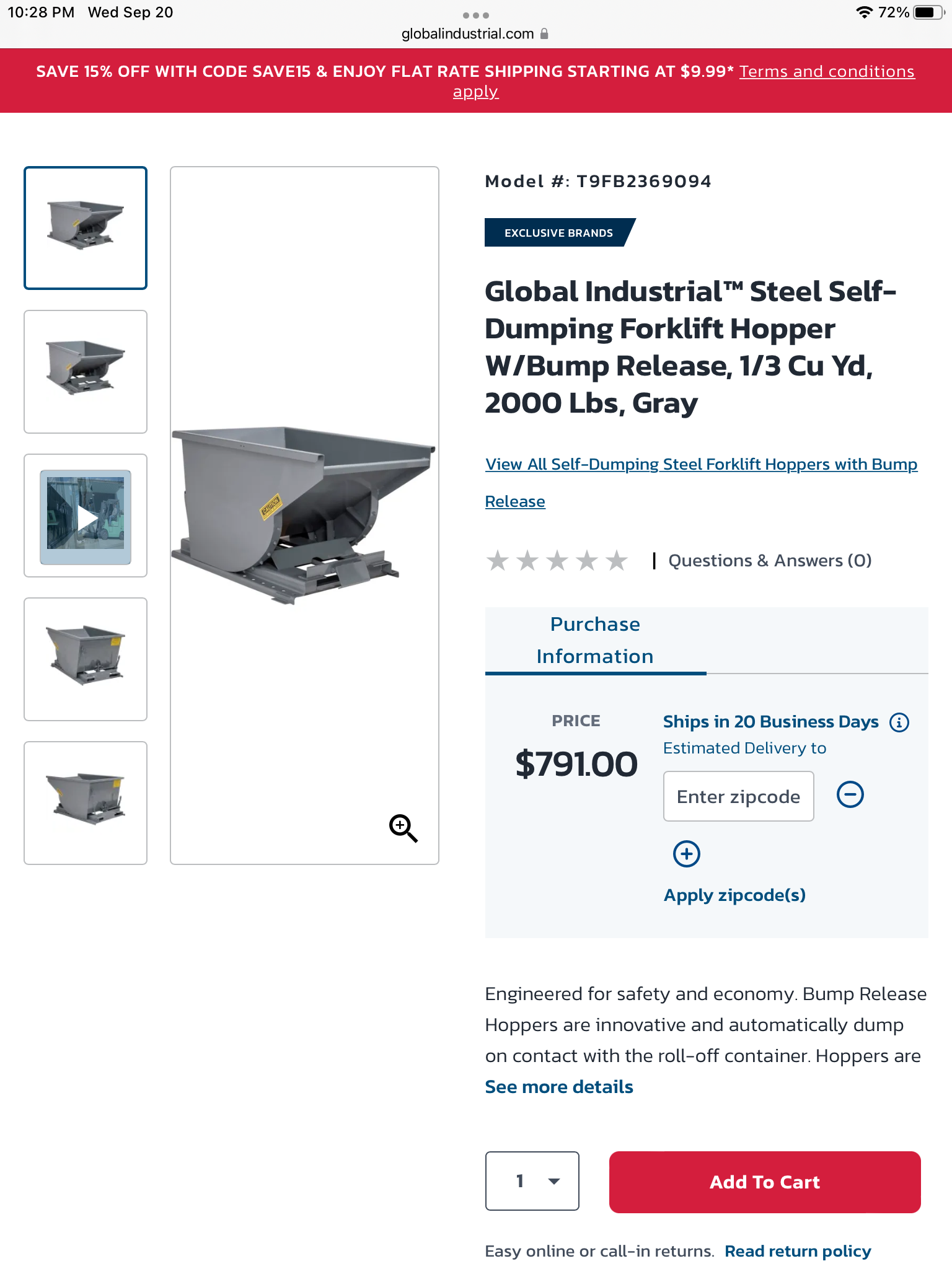

I have bulk bags that hold a face cord of wood and sit on standard 40x48 pallets. The bags have four straps at each top corner and two straps on the bottom.
Pallets with bags will be lifted into the bed of the pickup truck for delivery
Looking for ideas to dump the bags at customer location. Most customers will not have a tractor. Bags/pallets do not need to be lowered out of bed. Wood splits to be dumped.
TIA for any suggestions.

I don’t know how heavy the pallet/bag of wood would be … no pun intended…. but could an engine hoist or some kind of crane attached to your pickup lift it?

12V winch on top of the frame, lifting the front bottom of the bag.

Gonna have to be a heck of a bag to survive 1600 lbs of split wood being dumped out of it me thinks. Be interested to hear your reports.
Can you get a pice of 2” square tube that would fit in your hitch receiver, about 6-8’ long? Put that in the bed of the truck with a comealong or small electric winch. When you get to the delivery site stick it in the receiver, attaché the comealong to the end, pull on the top straps from the far side of the bag to dump or bottom straps to scoot it? Edge protector for your tailgate or truck bed would probably be a good idea depending on how much you love your truck.

Do I understand correctly that you're looking to dump the wood out of the bag? Not leaving the bag at the customers house? If so, why bother putting it in a bag at all? Just a thought, but a fit person can throw 1600 lbs of loose firewood out of a pickup in less than 10 minutes. Less of an option of course if the person is overweight, elderly or has some other physical handicap.
The bag seems to make sense for how I want to process wood...without a lot of work. See my previous post
I am 73 with minor back issues and want a system that I can handle as I get older.
You are right. I can empty a pickup bed full of wood in about 15 minutes with a bit of effort. If I can dump it in 2 minutes without much effort that has value to me.
