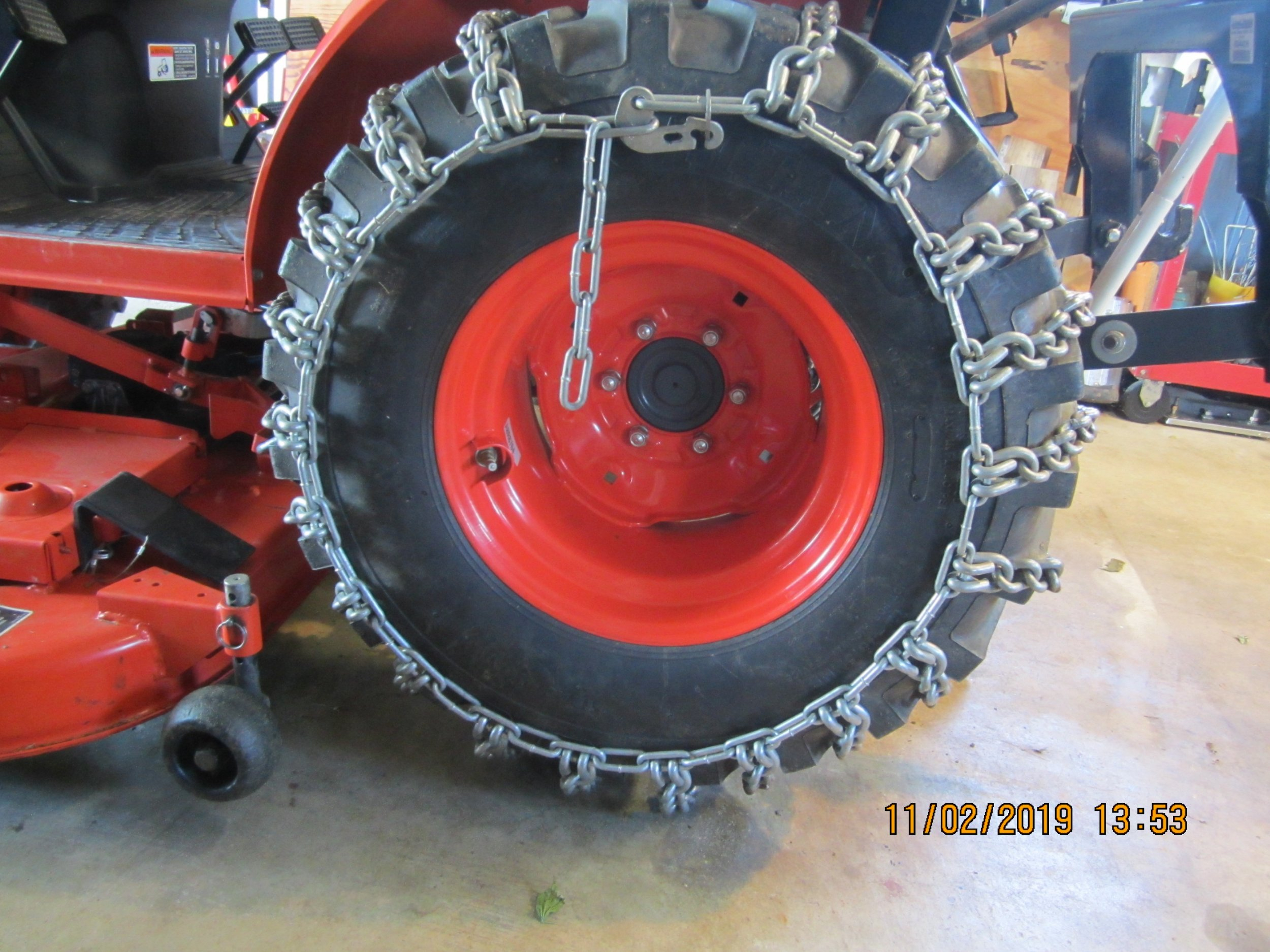

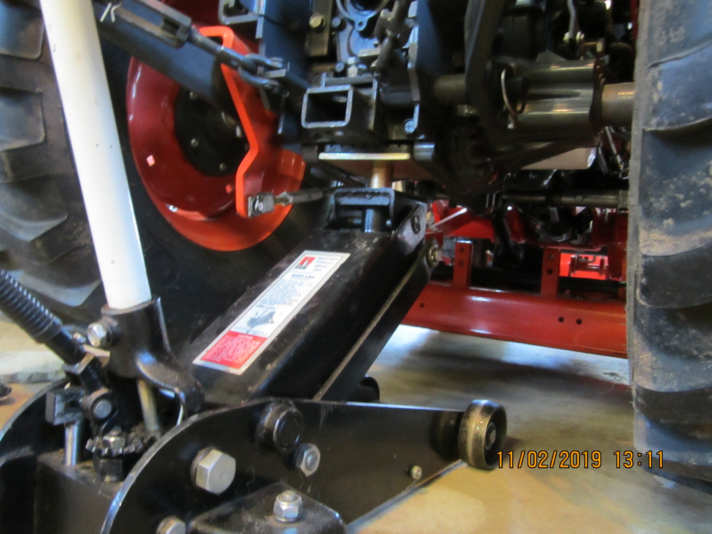

When I chain up my CUT I simply use a bottle jack that I place under the center of my differential and raise my CUT just enough to allow the chains to clear.
I then rotate a wheel and wrap that chain into position and then close the hooks.
I tried other methods but this worked out as the best way.

Neither have I (so far) seen the need to jack up my CUT.....except when mounting chains....like Piloon.....But I'm a small guy that can scoot under tight places if need be.:unsure: BTW be sure to block the tires....just in case......
Cheers,
Mike
