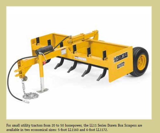

I also have an area of grass that in in need of leveling, and I am considering something like a drawn box scraper, with scarifying teeth to help with the initial digging up of the grass, does anyone have any experience with one of those?

The OP needs to spread and level 100 yards of topsoil. Once it's level, he has a tiller. A drag, chain link fence , gate, etc. is the easy part. The OP is trying to get it level enough tp drag. I agree that a Harley rake would be a tool of choice. A box blade and landscape rake with guide wheels would be a good plan B.
