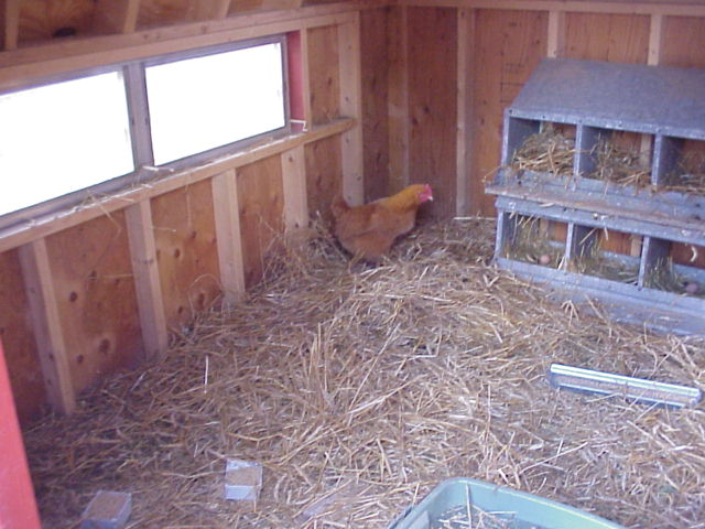

I'm using a 10 x 12 shed as a hen house. Here's a shot of it.
You can see a portable radio hanging in the doorway. That's a little trick I learned on TBN. Keep the radio on loud to a talk or rock station. It helps keep the predators away.

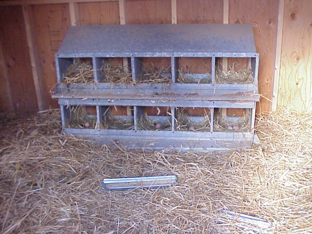

Here's a closer shot of the nest boxes. We have 24 hens. They usually lay in the nest boxes, but I still check some of their favorite hangouts in my barn where they occaisionally lay eggs.
You can see eggs in the nest boxes. We average 18 eggs per day for 24 hens. I heard that production goes down in the winter, due to lack of light, but that didn't happen with our hens. I don't keep a light inside or anything. The hens free range during the day, and I lock them in the hen house at night.

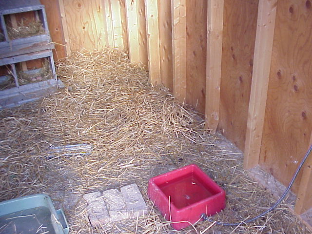

Remember, during the winter you have to keep the water from freezing. I use a heated pet bowl, as you can see. As Pete said, don't clean the bedding during the winter, it helps keep them warm. As long as we open the door during the day, there's very little odor. In the summer, we keep the windows open, and the bedding changed, and there's also very little odor then.
One important thing to know. Chickens don't get around well in the snow. Once you get about 6 inches, they have trouble sinking into the snow, so you have to keep them in the henhouse. In does get stinky then, and you will realize how much food they find by free ranging, because they consume about 3 times as much chicken feed. For feed, I use Agway Layer Pellets for the adults. It's chemical free, but not organic. I market my eggs as free range, chemical free, and they sell like hotcakes at the local health food store.
