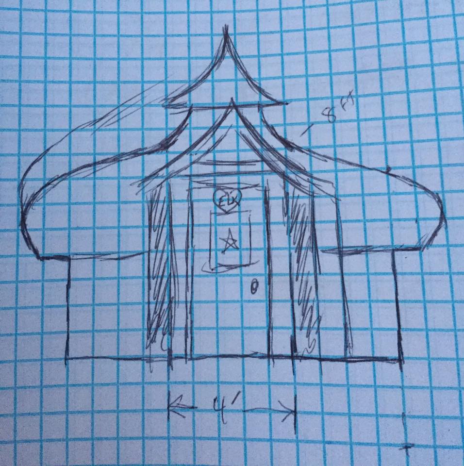

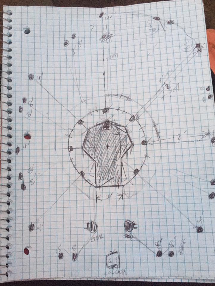

The plan evolved from multiple chicken tractors to combining them all into one circular chicken coop with 8 pens laid out similar to the spokes of a wheel.
Below are two sketches I drew up on graph paper to get my dimensions figured out. There will be a 36 inch exterior door to get into the enclosed portion of the coop. There will be a separate door to each pen, laying boxes, waters with heaters for winter and feed. They will have a small door to go out to the open area that will be fully enclosed with wire field net and a door to get into that area from the outside. It will require over 40 posts and probably take me the rest of the year to finish if I'm lucky.

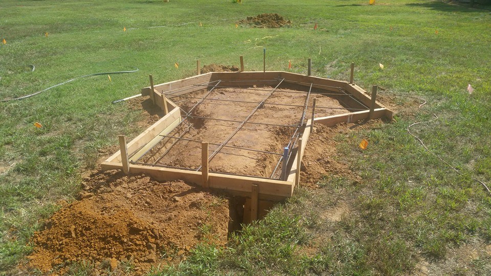

Last week, I measured it all out, marked where the concrete pad would go, and flagged the position of the posts. Then I set the forms and dug out the footings. The ground is very dry and hard, so I used my SDS Max rotary hammer with clay digging shovel bit in it to break through it. I set rebar and then went to lowes and bought sixty 80 pound sacks of readi mix concrete.
The next morning it rained, so I started mixing concrete at 1 pm. Probably the worse time of the day to do this with temps in the high 90's and the humidity very high right after the rain. I was literally raining sweat!!! It took 50 sacks.

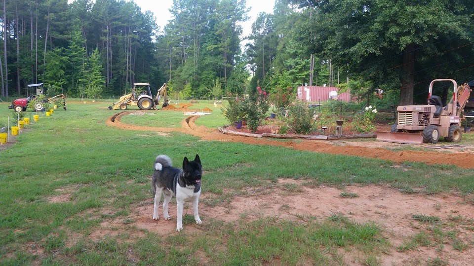

This weekend I started trenching for my utilities. I want water and power to the coop. Power is coming from the house and is a fairly straight shot. Water is being tapped into from a line I have going across my garden. I dug it up with the SDS Max rotary hammer using that shovel bit to find it, then carefully used my backhoe to open up the trench ten feet in either direction. It's 3/4 pvc and to get a T onto it, I need to lift the pipe up enough to slide into the fitting.
While I'm at it, I decided to run five more water spickets to areas around the garden. One of them will be a 16 foot treated post that I will turn into a streetlight with a LED dusk to dawn light.
