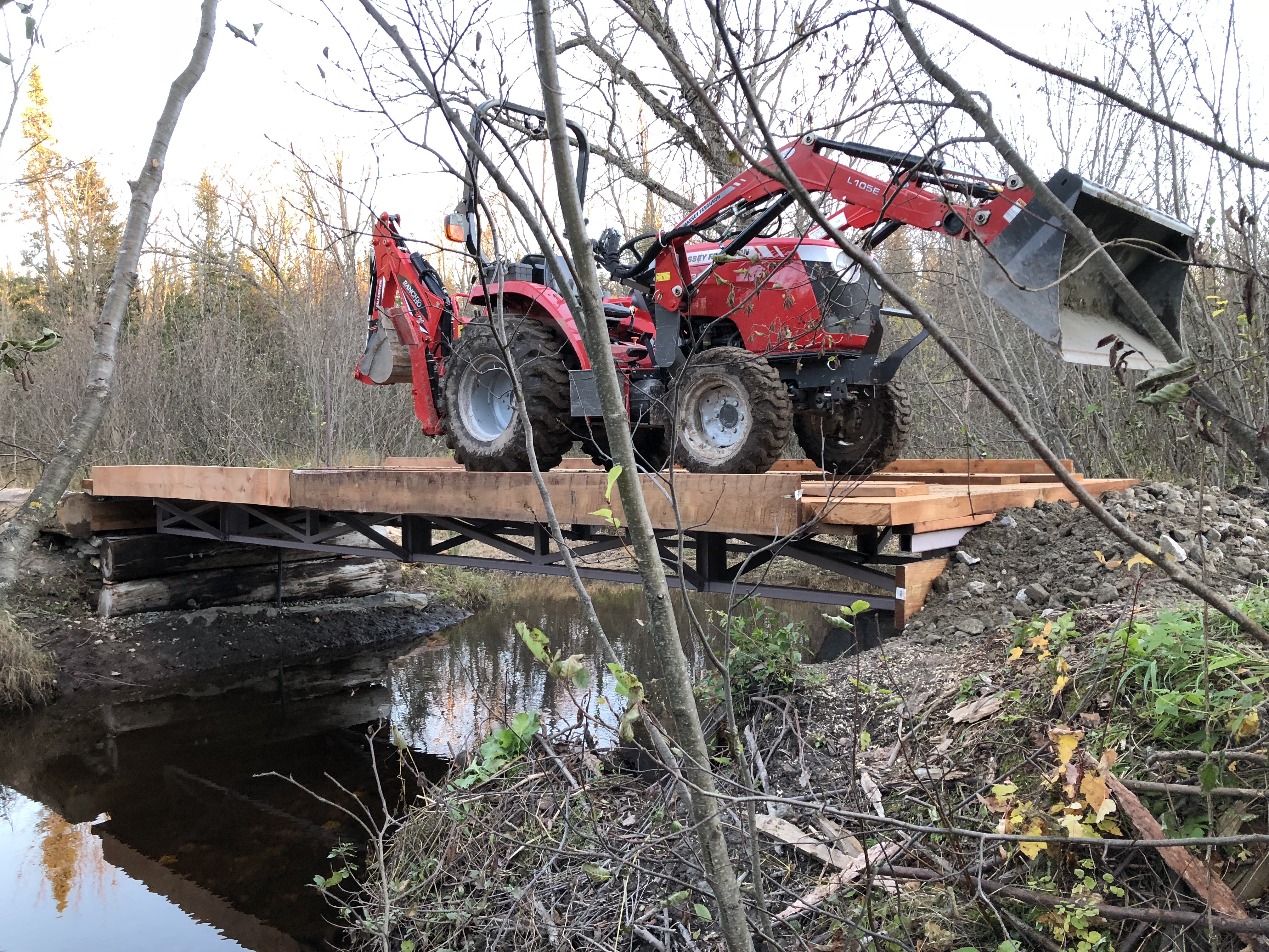

The angle bracing in your second drawing, under the deck, is unnecessary. The bridge cannot fall toward either end because it will be pushing against land.
I believe the cross bracing is for restricting lateral movement (side-to-side). It’s a good idea to have that in place.
   / Idea for a Bridge deck? #32
I believe the cross bracing is for restricting lateral movement (side-to-side). It痴 a good idea to have that in place.
+1 , without knowing what beams are used, the lateral bracing should not be ignored
#33

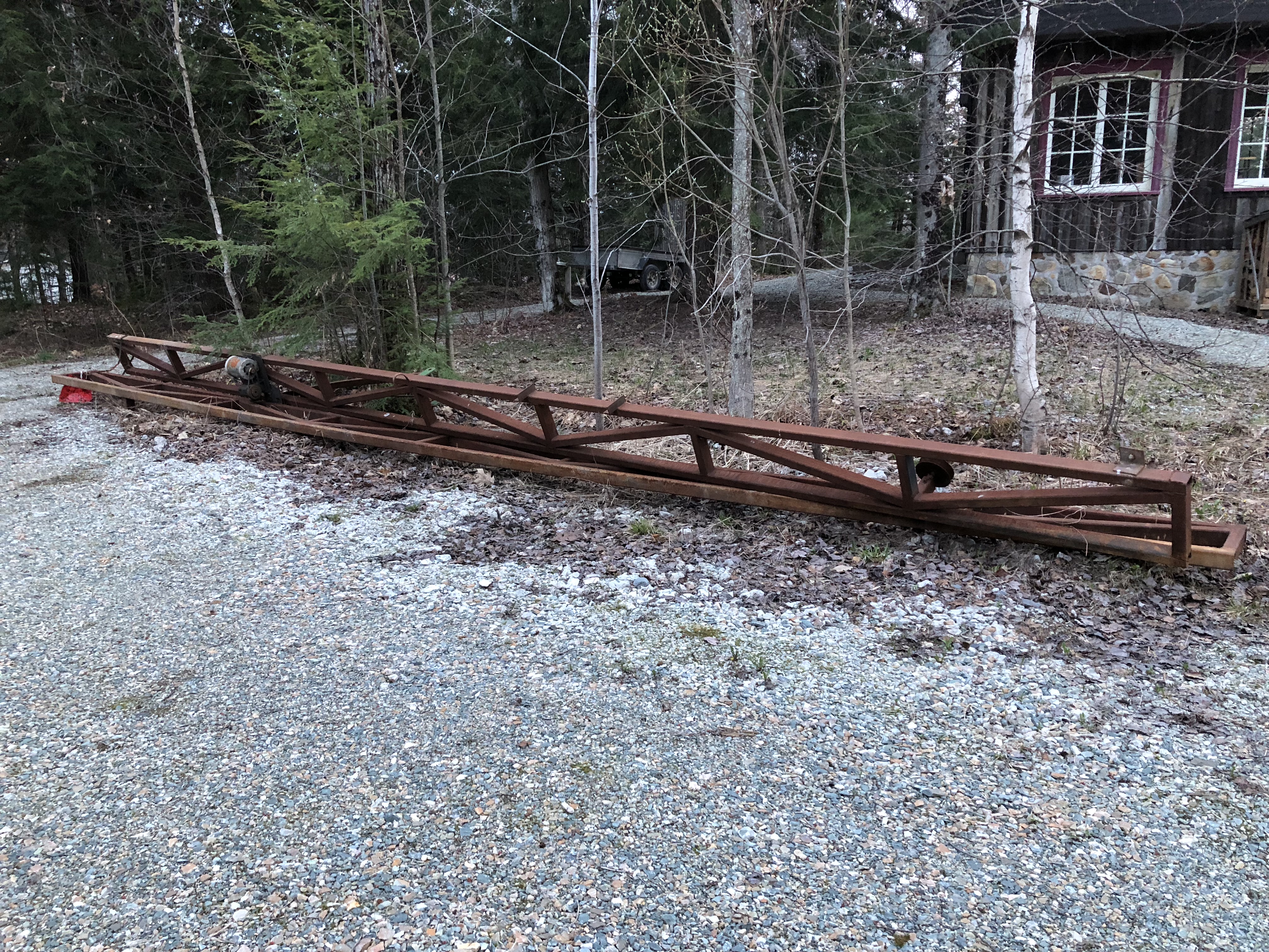

I知 out for few day, when I come back I will take a photo and spec of the beam. I not so sure anymore about my idea?!?!
   / Idea for a Bridge deck? #34
That's why you're looking for answers here right?
It can be done, just best to use what works best and is thought out, so you do it once and done. :thumbsup:

Here a picture of the steel beam!

Looks good I would be putting a good preservative on that wood, I'm partial to used motor oil myself.
