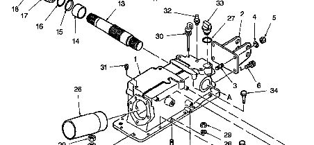

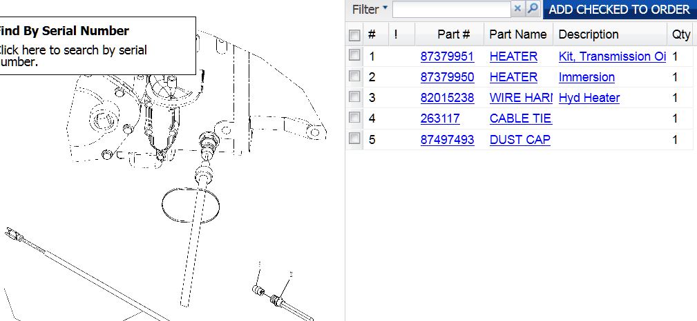

/ Ice in hydraulics #10
mongobird
Be sure to check that hyd reservoir breather cap(parts key #32) is not plugged. There was an option of a hyd oil heater kit.

/ Ice in hydraulics
#11
mongobird
Years ago I had some bug mud up the breather cap, so it is now on my list when I grease, etc.
That heater is an option I was unaware of. I have seen similar heaters for about $100, and perhaps I should consider when I fix the differential lock this summer / fall. Most of the ones I've seen are about 200W which should really get things toasty.
