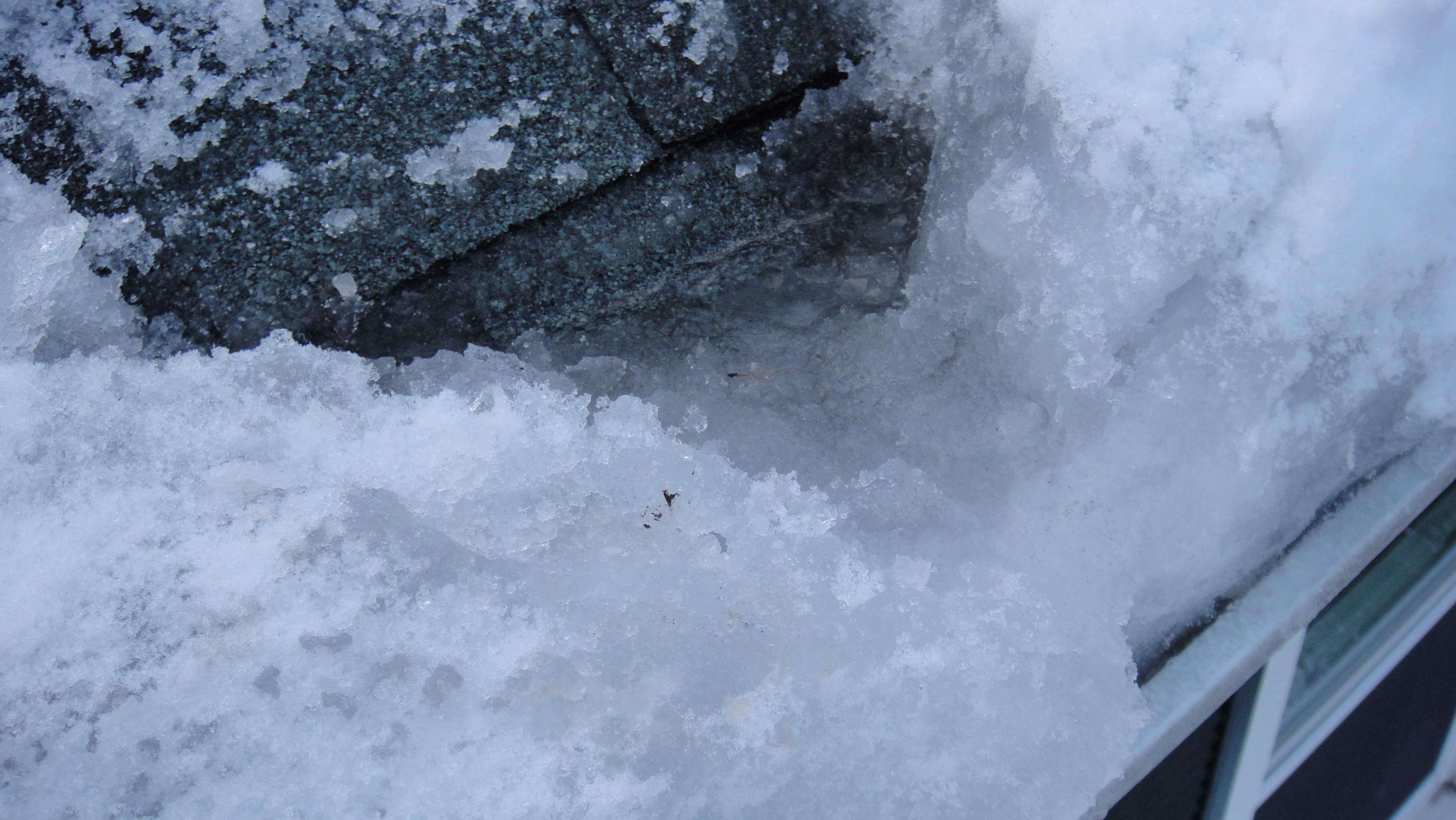

I managed to get a bit of water into the house for the first time in the 18 yrs we've owned the house due to ice dams. With our "one storm after another" and no melt off the ice dams are severe. I shoveled off the roof yesterday. More shoveling than I've done in a long, long time. We had a foot on the front and 3-4 ft on the back. I had a clear hard ice dam about 18" up the roof and it stood at least 6" above the roof/gutter line. Looking for a solution I hooked a hose up to my gas tankless water heater and went at it. 4 continuous hrs of hot water and the roof and gutters are clear. I was running 3.3gpm at 125F with a spray head (almost like a shower head) to give not a lot of velocity/bounce to the water. You have to cut channels into the ice to relieve the built up water behind the dam while you are melting the ice, otherwise, you will force water up under the shingles, creating the problem you were attempting to solve. One of the downspouts runs out onto the driveway. The warm water melted a broad channel in the pack ice there. I am stiff, sore and happy that it worked out.

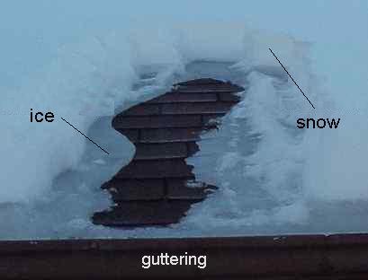

If a survey were to be conducted we would probably find there is more damage caused nation and world wide by ice dams like you experienced than the thick ice build up style on the eaves edge. These often occur where ice dams aren't a concern and many have never heard of such a thing as ice dams.
In the photo the layer of ice followed by a foot of insulating snow is the perfect set up to cause water to drip from the windows around noon the next day when the outdoor ambient temperature increased to just above freezing. With the roof pitch on this house and the rafter run length, 4 lbs. of pressure was exerted on the water at the building line. A relief groove a half inch wide stopped the water flow into the house walls immediately.
I'm glad that worked, it's the first I've heard of that approach, I would of said it would never work, but I guess with your tankless heater it was able to give you nonstop hot water for all that time. plus we had close to 40 degrees on sunday down here.

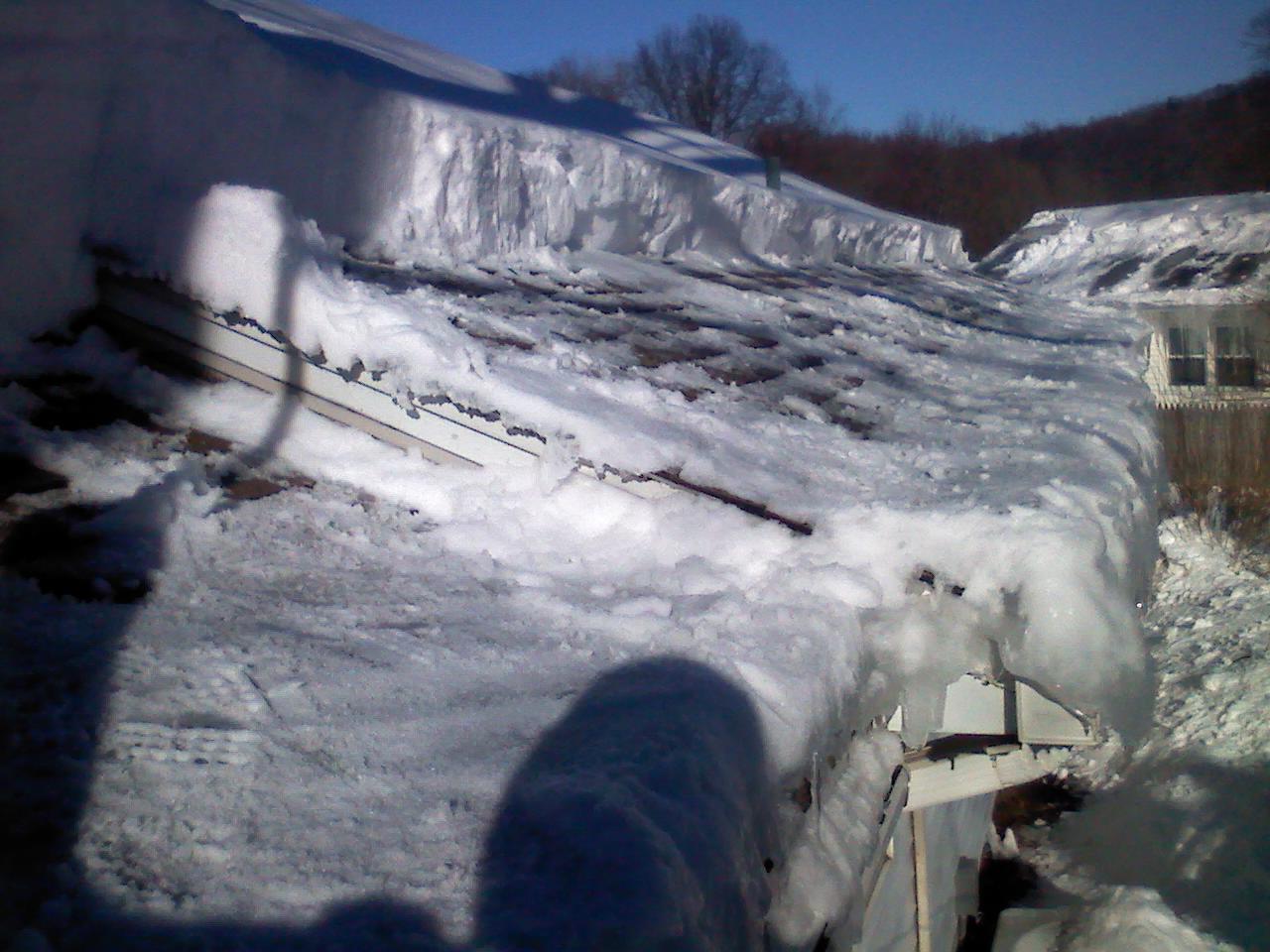

Was out yesterday at a historic armory in Hartford, with leaks through 4 floors from a frozen leader drain through a parapit wall.

Question, and a serious one for once.
Why isn't there water standing behind the dam pictured?

/ Ice dams #10
From my experiance not all the houses that have the ice dams at the eaves have ponding water or leaks. The ones that do have water you wouldn't see it unless it was a close up pic as there usually is not that much, less than an inch deep.
Notice how the ice dam has a level top, that gives you a relativly safe place to walk on a pitched slippery/icy roof. If you could call a 4-8 inch wide ice plank at the edge of the roof "safe"
