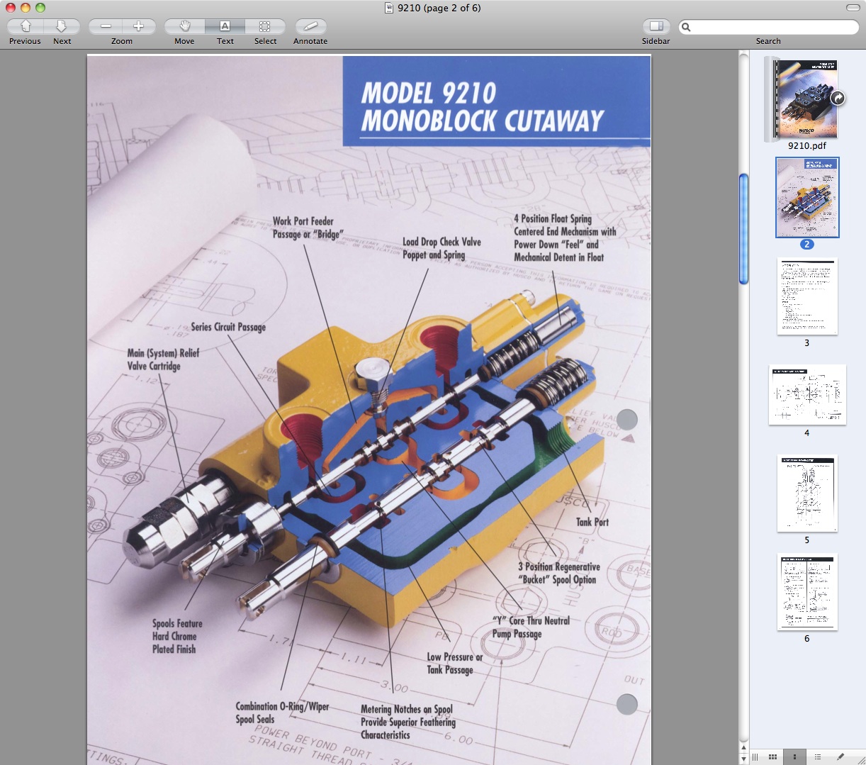

What type of spool does the FEL valve have? If it is the series type fluid from the FEL cylinders will also be sent downstream via the power beyond port. I believe Kubota used this on some models so that you can raise the FEL at full flow and still dump the bucket.
This would explain the slowing down while raising and speeding up while lowering do to the area differences in the FEL cylinders.

If your tractor was supplied wit ha valve "optimized" for FEL use you probably have a series spool like I stated earlier. This spool directs the flow returning from your lift cylinders downstream into the power beyond port.
Example: If your cylinder ration is 1.25:1 and your tractor puts out 10 GPM while raising you would only get 8 GPM flow in the power beyond circuit. While lowering you would get 12.5 GPM flow in the power beyond port.

Husco & probably other valve manufacturers offer a FEL control where the lift lower spool return flow is directed into the pressure / power beyond. I don't remember who but some one posted a schematic for Kubota with this option.
You are correct in that most FEL valves are parallel where you must feather the lift to get any flow for dump.

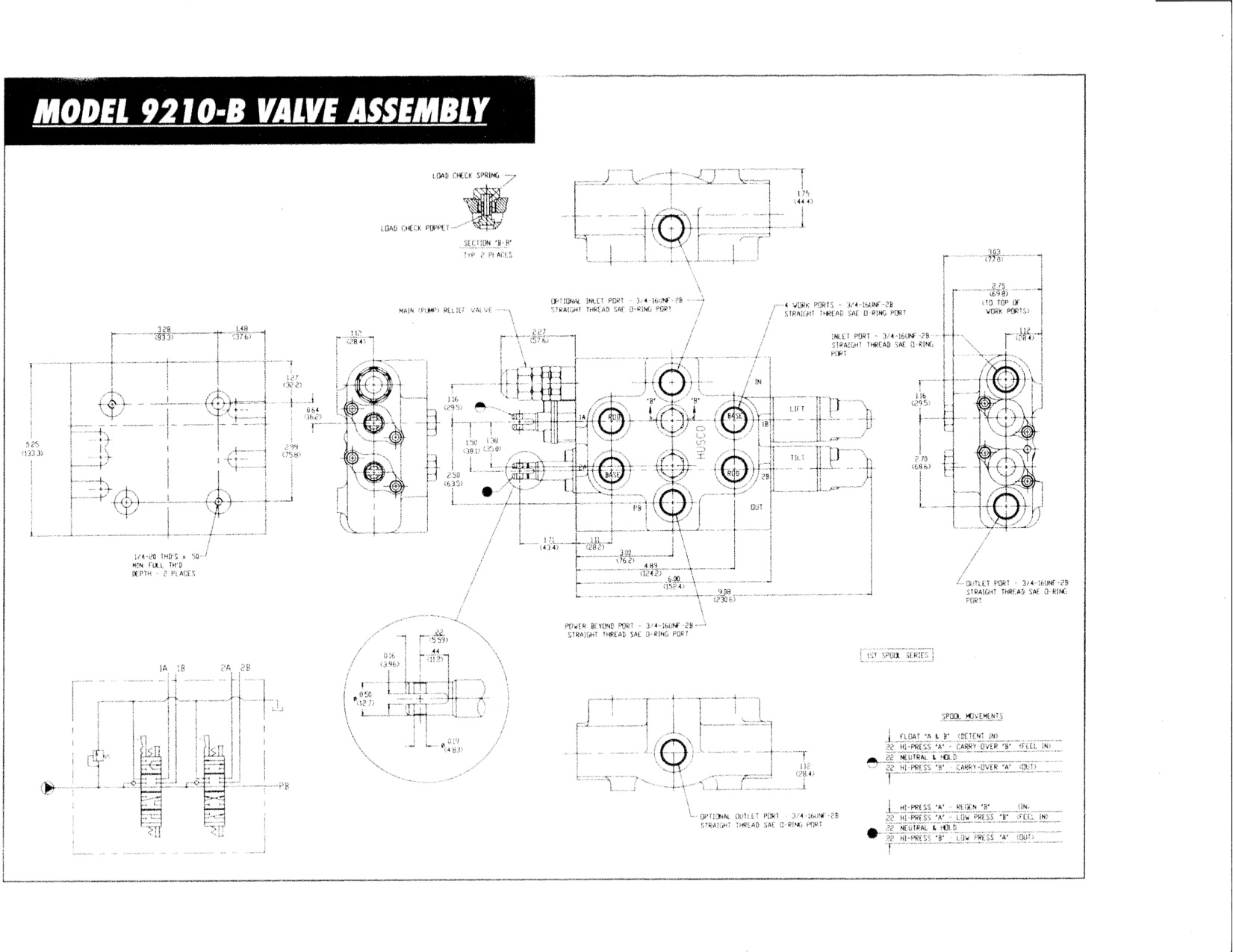

/ I would like to know more ??? #20
I have never had that kind of valve, but it DOES explain what the OP saw, and I can see it's value on
a FEL. So, this valve has only one output port (power beyond), and no output to tank?
No the curl dump circuit goes to tank and not the PB port & the raise lower connects both work ports to tank in the float position. I am going to try and attach a Husco valve document that shows this schematic. Ports 1A & 1B are the lift lower.
